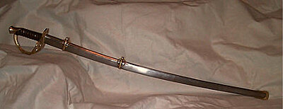

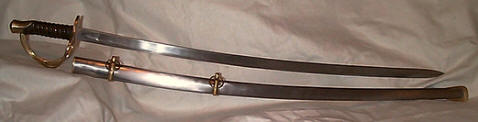

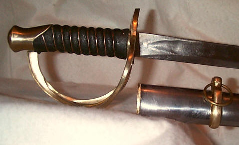

    I am looking into offering defarbed "Dog River" sabres. The Dog Rivers will include:
    Dismounting the hilt to do the follwing

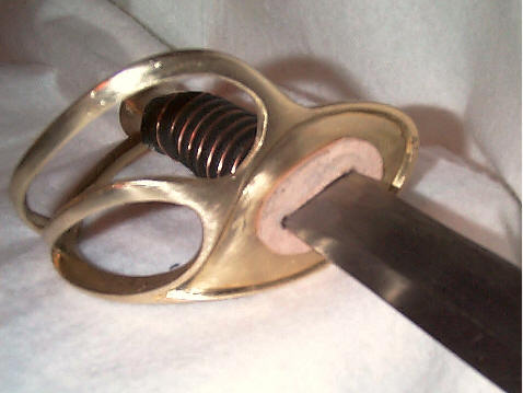

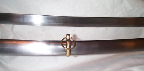

    1) Re grinding of the blade to shape it more properly, completing an "Un-stopped Fuller" (aka blood groove) and blade edge

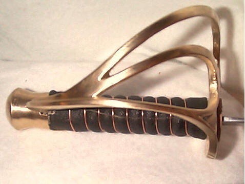

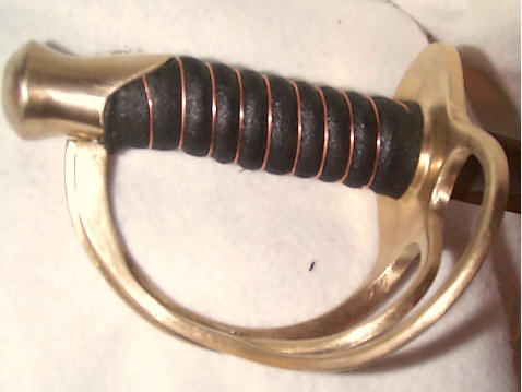

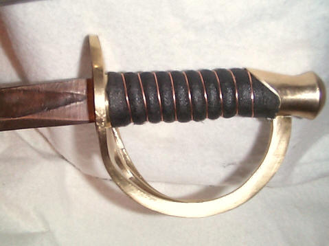

    2) Getting rid of the incorrect wrapping and wire & Re wrapping the grip with real painted or oil cloth, and re wireing with copper wire.
    3) Re shaping the gaurd bow, fileing to the proper shape by hand as many were done, giving a more square apperance to the edges of the guard.
    4) Re shaping the pommel cap , & re mounting the hilt on to the completed blade

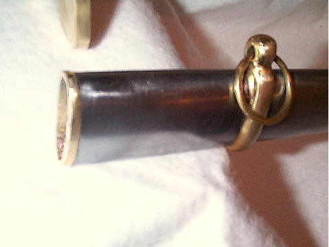

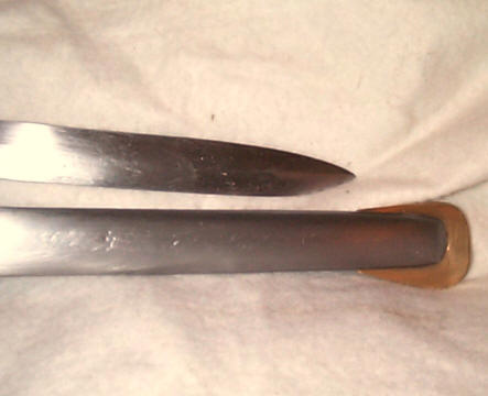

    5) Re shaping the brass throat of the scabbard, by making it more diminished as per originals
    6) Re shaping the brass drag of the scabbard to match originals by cutting off the excess & making it smaller, finshing by hand fileing.
    7) Marking the scabbard throat and the side of the guard with matching marks for the sword & scabbard. These marks ar as per originals encounterd by fileing a Roman numeral roughly by fine file.
    8) Finally marking the quilion ( the flat of the blade up by the guard ) with "TMD" to mark it as a reproduction , It is coverd by the leather bumper (aka leather washer)
    The swords , as per originals of this type will exhibet file marks on soem parts of the saber wher it was finished. These are not rough marks as the per the original they are not pollished out all the way, as on their US counter parts.

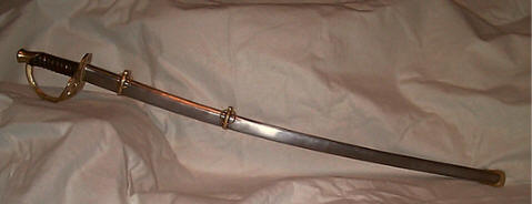

    Here are pics of the first test one for feed back, These swords would be for sale at $214
    This first one is for sale

                    These are comarable to some the original "Dog River" Sabers in temper, ballance and weight. These are blade heavy, as they are CS copies of the US M1840 Sabre "The Wrist Breaker" which is a blade heavy sabre.
                    I leave the factory temper of the sword as they come to me, as it is simmilar or the same as some of the originals I have handled. I do the de farb work as stated at the bginning for the thread.
                    The result is a correct type of common CS sabre that is indicative of CS manufactureing durring the war, with a real sence of the Southern war effort to mass produce weapons as quicly as possible, to meet the needs of their army. Which resulted in a function weapon with out refinements & pollish. Much like the Homespun uniforms that were produced, they were Military looking but simple, sturdy & serviceable.
                    I wanted to produce a saber that would definatly whistle "dixie", showing properly a view of Confederate manufacture so vital to the South & that is vrey lacking in this area of living history.
