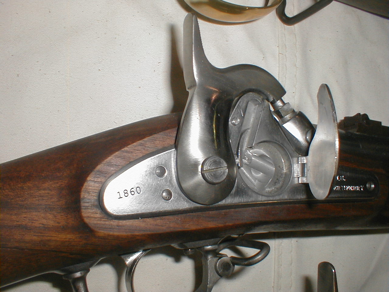

                      This is his M55 Lockplate with functional Maynard primer.
