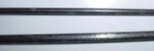

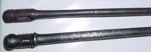

              Careful! I have seen some dealers selling original P-53 muskets with the Mark III Snider cleaning rod which is almost the correct size up to where it enters the channel at the nose cap. It then tapers down to the appoximate diameter of the threaded portion at the end. The correct P53 ram rod will be thicker than the threaded portion. I don't know what is going on with your original but repro ramrods in my originals fit pretty well and may be a tad looser than the originals. My early Parker Hale ramrod fits just like an original. I don't know who made my other two repro ramrods but one is a one piece rod.
              The picture to the left below shows a Snider cleaning rod on top and an original ramrod on the bottom. The tip of the Snider rod may be squared off on some.
              The second picture shows the difference in the diameter of the rods further down near the threaded end.
