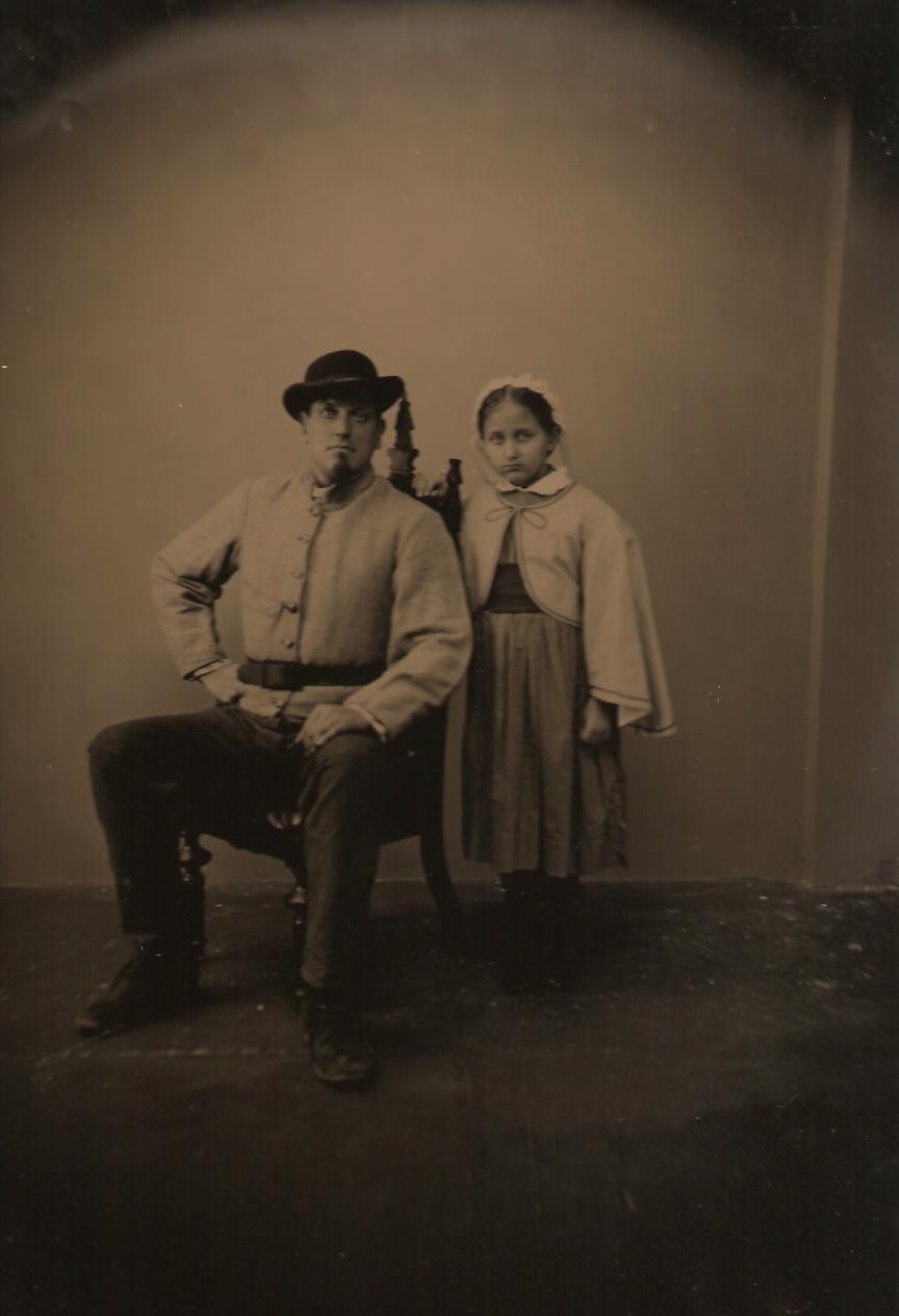

          I have only had experience with Mr. Gibson in Gettysburg, but would highly recommend him. While I have not examined all of the gear in his closet, I have been "in the closet" and can tell you that he certainly has a lot of different outfits from which to choose. In my opinion he will be able to take care of your needs.
          I recently had a photo done with my daughter, whom Mr. Gibson and his wife outfitted. I believe the results speak for themselves.
          Mr. Gibson and his wife take plenty of time setting up the shot and making sure that everything is "right." I was impressed by their profesionalism and artistry. Again... He comes highly recommended.

            James, your picture is very impressive looking.
