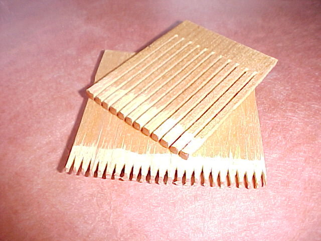

      I don't know if the colors will show very well in this pic, but here's some original CW-type barnburners. The tips are reddish-brown, and as Marlin has already pointed out, there is very little composition on the tips compared to modern matches.
