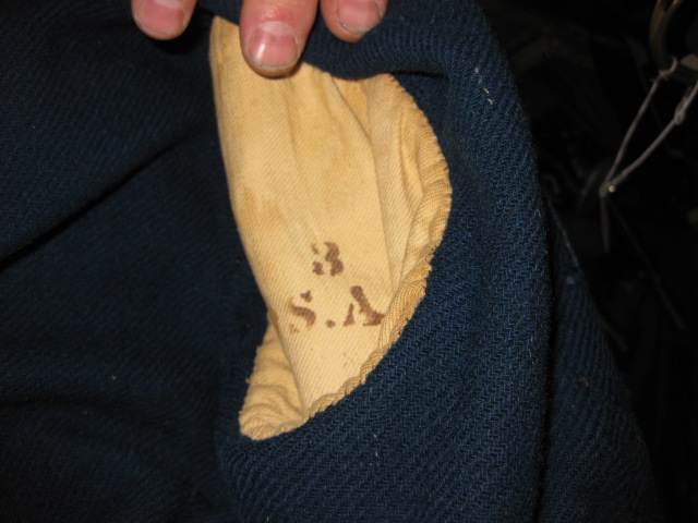

    S.A. with dark blue (sack coat) flannel, from the Kurtz collection and now for sale at The Horse Soldier

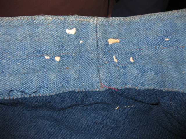

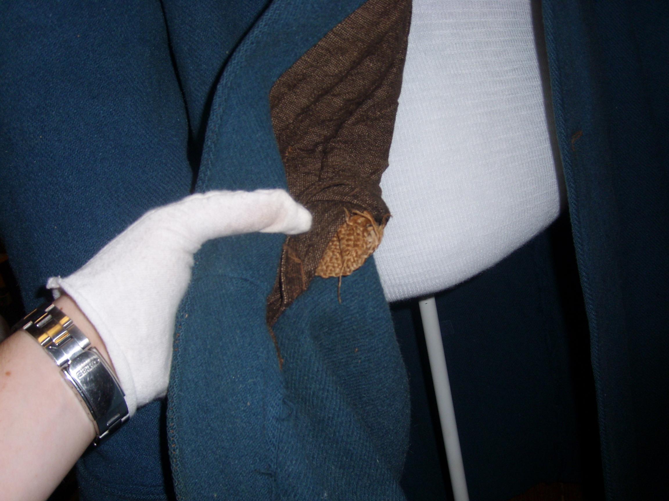

      In viewing the original from the Kurtz auction, it is sack coat blue, but it very loose weave. I assume this may have been rejected sack coat flannel used as lining. It also retains the slevadge on the bottom.

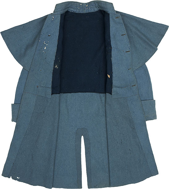

        Here you go, here are some photos of linings I have collected. The first two photos are from a coat made by Amos Thomas of New York.

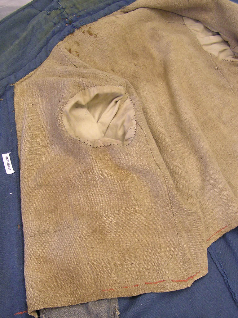

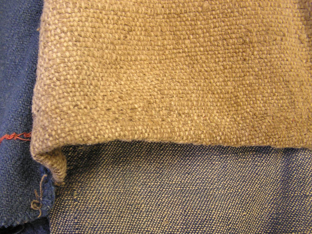

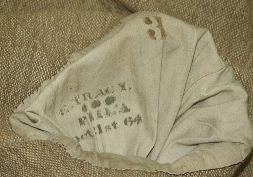

        The Next Photos are from an E. Tracy of Philadelphia great coat. If I remember correctly both of these coats where at the HS.
        The last photos are close ups of when we surveyed the SA overcoat from the Kurtz auction and show the loose weave blue flannel Eric mentioned.

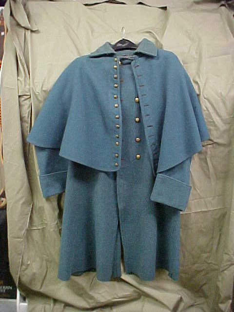

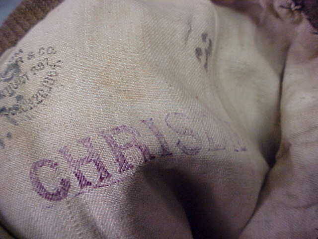

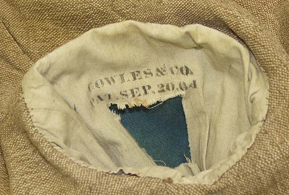

          Here are a couple of pictures of one I found on civilwarshop.com. It's still there, if you want more images, but these are the only ones of the lining I found. Here is the description (from the site) also:
          "EXCELLENT and very scarce Civil War mounted pattern greatcoat of the type issued to both cavalry and artillery units during the era. Double breasted with eagle buttons on the front, the cape and the rear adjusting strap. Minor scattered very light insect damage and some picks but basically as good as they come and with a crisp sky blue color. This coat has a New Jersey (N.J) stencil beneath the upper cape and COULD possibly be identified--there is a stencil in the shoulders that reads "Chrisdie" which is either an aftermarket vendor or the stencil of Henry Chrisie who enlisted in 1863 in Battery B of the 1st New Jersey Light Artillery or one of the host of "Christie" guys who served from that state--name spellings are often altered in record transcriptions. Either way, a relatively difficult to find Cavalry or Artillery pattern Civil War coat in very nice condition! Bear in mind that just because this is a mounted pattern, that does NOT mean an infantryman or officer could not wear it! $7,250.00"

                  The 6th Mass. overcoat from the Kurtz auction is lined with a thick domet flannel type material. It's also interesting to note that the body of this garment is made from "recycled" imported French trousers that were too small to issue.
                  Note the paired cotton warp threads on the first E. Tracy overcoat lining. That looks a lot like the fabric used in the chain-stitched Louisiana jacket in Troiani's collection, the four-button CS jacket in Chillicothe, OH, and also some imported hand-woven cotton jean available today.

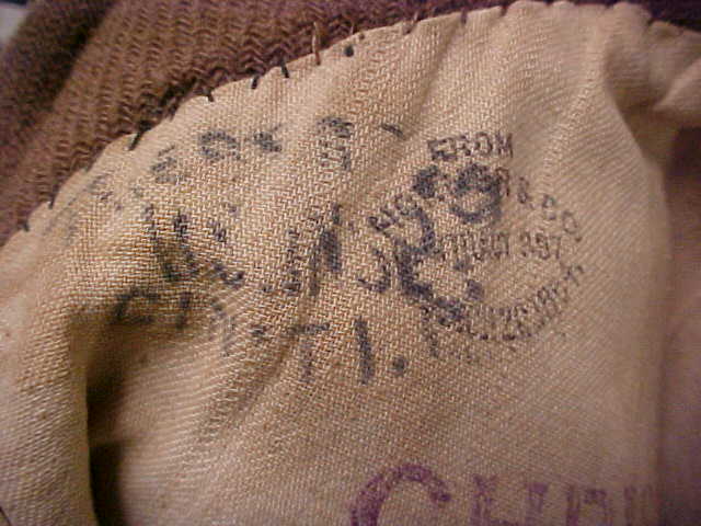

                    Dark brown wool on white cotton plain weave jeans. The lining is 4 pieces if I remember correctly, and the bottom is not selvedge, but the raw edge is simply folded once and stitched by machine. Unknown manufacturer.

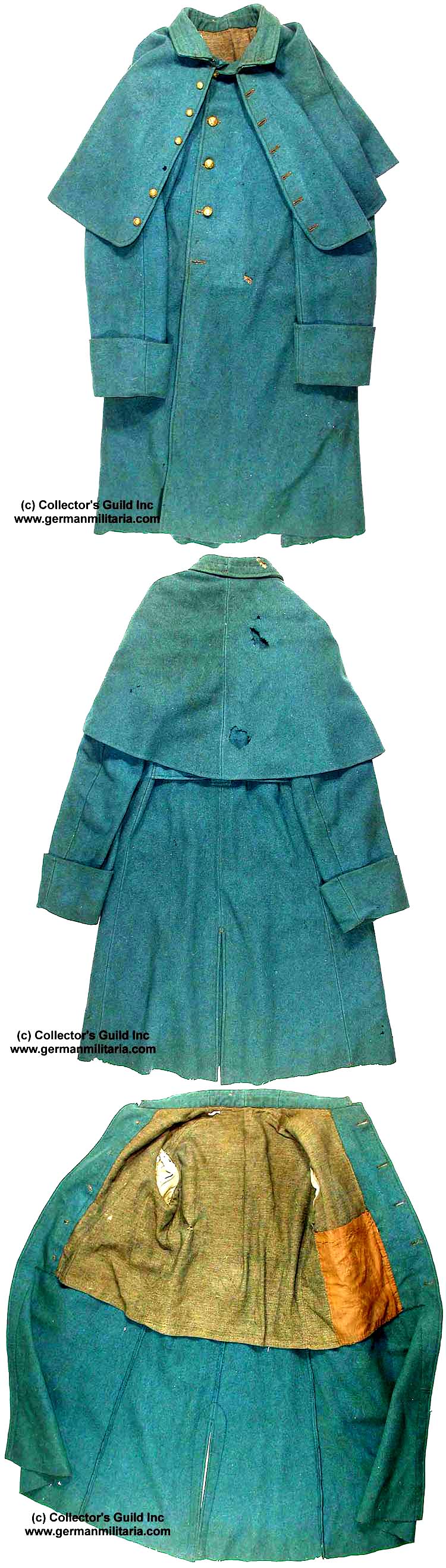

                      Here is a nice overcoat for sale with photos of the linings, among other details: http://www.germanmilitaria.com/Other...os/P10014.html

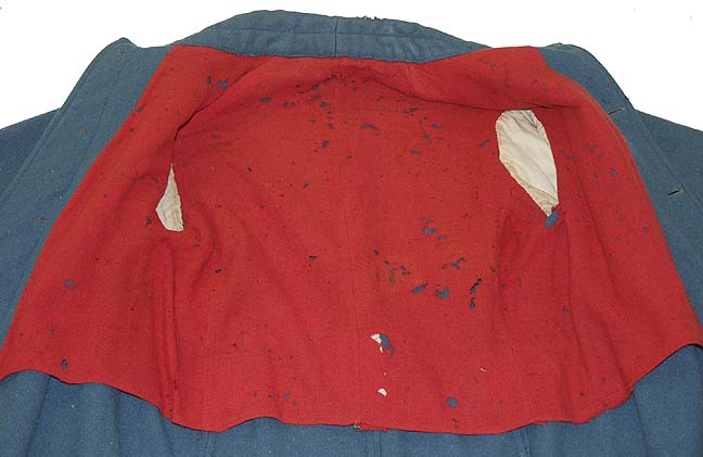

                        Sorry, I didn't get images up on the website for the lining, but I think I described it fairly well:

                          Oops, forgot this one, once again no lining photos, but I described it as best I could:
