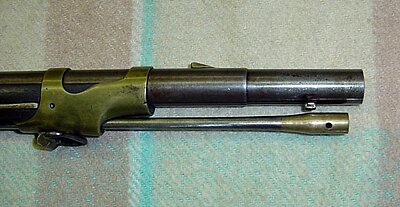

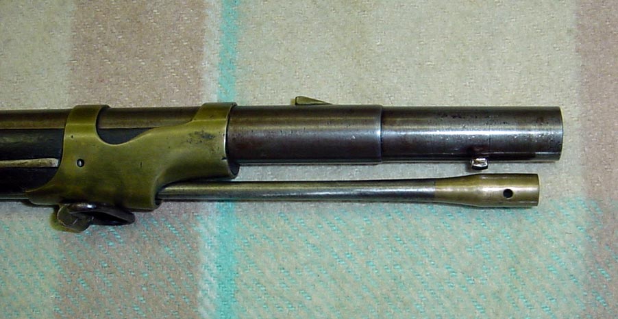

                        Based on what I have here, what versions would best suit any particular rifle? I would be interested, however, in having one rebuilt with a turned-down muzzle for a socket bayonet. I saw an original some twenty years ago in a gun shop in Jackson, MS. The conversion to M55 socket bayonet was rough (and drastic) to say the least, which led me to believe it may have very well been "southern" in nature. My preference would be to have the muzzle turned down for the M1835 bayonet with a socket bore of .844" and the rifle finished out as a "Tyron M1841" as referenced in Robert M. Reilly's book, "American Socket Bayonets and Scabbards" on page 58, or as any other contractor as may be plausable. Your thoughts welcomed.
                        If memory serves me correct and without looking it up, the turned down barrels were a NY contract and used the M-42 bayonets. There was also the DRAKE conversion which included provisions for a socket bayonet which is harder to come by. Some 41s identified to Mass soldiers used the Drake conversions.
                        I included a picture of the turned down barrel M-41 FYI.
                        Jim Mayo

                          Yes, in 1862 Massachusetts contracted with Augustine Drake of Boston to alter their Windsor M1841's.
                          Basically, Drake replaced the front sight with a musket sight, and the rear sight with a three leaf short range sight. History not exactly clear on his socket bayonet which may have been a European (possibly Englsih) contract.
                          By December 31, 1862 there were 1742 on hand, with some being issued in 1862 to at least three MASS regiments.
                          The bayonet is similar to some associated with Sharps NM1849 and NM1863 Rifles and oddly enough some Fayetteville bayonets- they being knda/sorta/mostly "M1855ish" socket bayonets with just a slightly larger socket.
                          The lathe turned muzzle version NUG took the .69 M1842 socket type bayonet.
