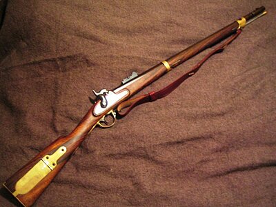

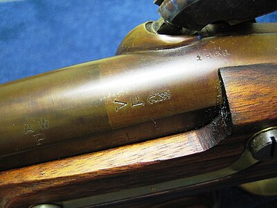

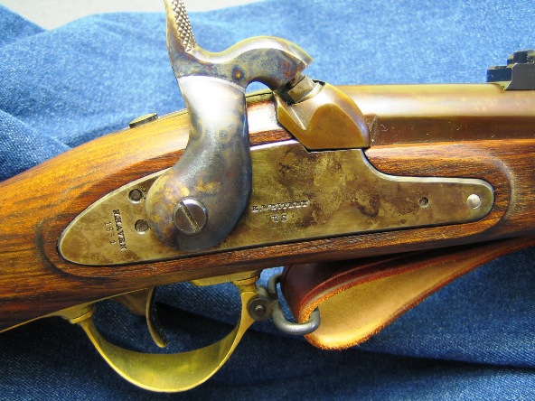

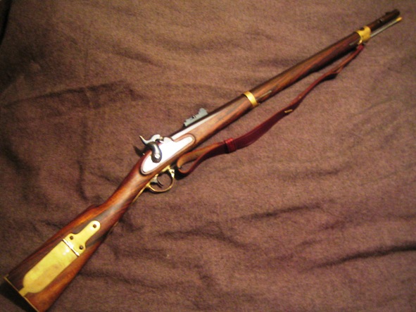

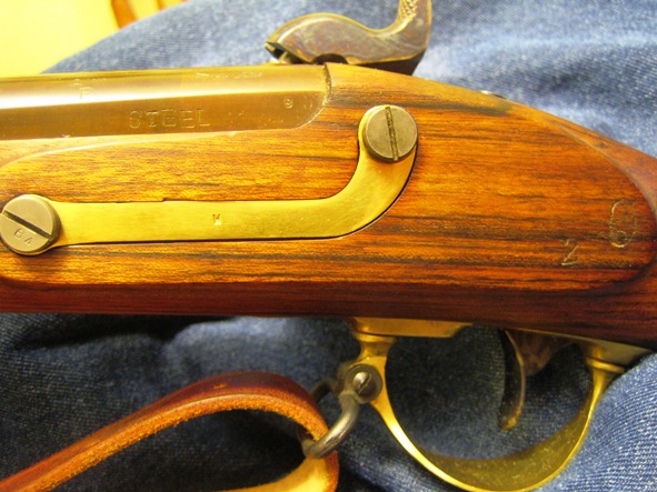

      Todd helped me work up a short front band Whitney arsenal conversion last year and that weapon turns heads everywhere I take it. The craftmanship and talent that Todd possesses and puts into his work is second to none, in my opinion and I know firearms, very well.
      You will not be disappointed by anything that Todd does.
      If I had infinite financial resources I would keep you busy indeed, Mr. Watts. I always have unusual projects in mind.

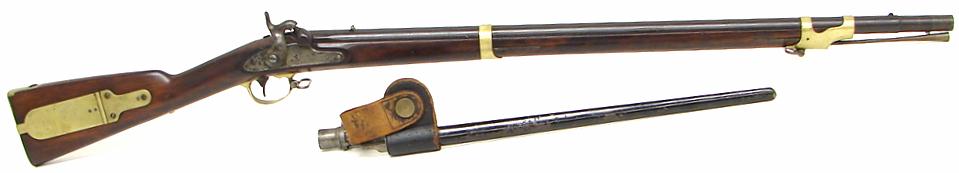

      On a similar note, I was asked to do an experiment and it worked out well. The park asked me to see if they could convert their old Zouave into a Mississippi Rifle. It is a real old Euroarms purchased by a "historian" a few decades ago who apparently forgot what his professors taught him about research. It turns out that the Zouave barrel will marry up perfectly with the Mississippi stock and hardware, although the front band has to be the short variety and it takes small amount of work on the height of the front sight and a small amount of work on the bayonet bar to make sure those two appendages will not crack and fracture the brass front band. Other than that, it works perfectly. So if one has a zouave sitting about with nothing better to do with it... The only thing I have not figured out is what to do with the old Zouave stock, firewood?
      I have posted some photos of the Mississippi that Todd created for me.

              As anyone can see from the photos, your rifle would be the envy of any crowd. Todd Watts just out and out does beautiful work. I have two of my own Mississippi's standing up in gun-rack just begging for the opportunity. Soon fellas, soon...
              Matt - I have several questions for you. #1 - Which repro did you rifle start out as? #2 - What parts did you have to furnish for the "make-over"? #3 - Which, if any, did Todd furnish? #4 - Of any you had to supply yourself, who or where did you get them? Lastly, #5 - I noticed that your rifle retained the screw in the lower sling swivel instead of being riveted. In looking at originals online, I did see one with the lower sling swivel secured by a screw instead of being riveted (don't recall the maker-am looking). I thought maybe this could have been a post-production modification. What have you seen or read that would indeed support leaving the screw in place? Was it perhaps a Whitney variation or did any other makers you know of do the same thing?

                Rick,

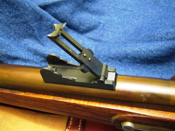

                It was the Euroarms .58 caliber that I demonstrated with at the Pea Ridge 146th back in 2008. I purchased the rear sight and the Whitney stamped lock from James River Armory, though both were in the white. The bayonet bar and the 1855 front sight came from S&S firearms. S&S also has the rear sight for this model as well. The ramrod is the Mississippi Rammer from Dixie Gun Works, though the arsenals also used a rammer that was all steel and they used a tulip head rammer as well. I opted for the brass tipped rammer because we had some photos of an original Whitney. The Rifle Shoppe made the short front band. All in all it was pretty amazing. Craig and Todd and I talked it over for a while to get the details straight and I just sent the gun and parts to Todd. It was an amazing project and doing the research and collaborative discussion done on it was a big part of the fun of the whole experience. On the sling swivel, I too have seen them both ways on several different makers.
                Another bayonet mounting type which would facilitate using the .58 with the long front band, and I believe from my research that this was the type issued to Company B, 36th Illinois, the fellows that shot Ben McCulloch, the barrel had an 1855 front sight but it was turned down slightly at the muzzle with a lathe to accept the standard 1855 socket bayonet rather than a sword bayonet.
                Also, I checked the reproduction "Zouave" bayonet, which has a much closer blade profile to that of the Yaghatan blade bayonets used with the Mississippi rifles, though the repro blades are shorter in length, it will fit this mounting system and it locks up on my rifle very well. Compared to the 1855 bayonet it has a few other characteristics that would make it a better choice for reenacting. One, it is much more cost effective being 79.00 instead of 130.00. Two, the blade does not cross in front of the muzzle of the weapon. The original 1855 rifle bayonet also curved up in the way of the muzzle, whereby the Yaghatan blade sweeps away from it. You would not be able to fire with a fixed bayonet with the repro 1855 bayonet, the other repro would be safer if used thus. Though I have not had occasion to fire with bayonet fixed. The "Zouave" bayonet is just what the reproduction is called, for some reason. It is just another type grip/ricasso pattern of 1855 bayonet similar to that used by several Confederate and Federal arsenals, for example the bayonet used for the Plymouth rifle is very close to this design. I have not tried it but I would bet that the Enfield saber bayonet repro will probably fit as well. I have long toyed with the notion of taking the blade from the repro Enfield bayonet and having it pinned into a 1855 grip. As the blade is fixed into the handle with two steel pins through the grip, the chore would be removing the pins and then blades from the specimens without doing too much damage.
                Another note of caution about the bayonet bar and the long front band. I snapped two long front bands in my experiment with the park's Mississippi in trying to figure a way to work the band on and off of the barrel. Even the short band, as Todd said in the posts above, takes some serious concentration to maneuver it around. I just disassemble the weapon carefully and leave the front band on the barrel when I do so. I slide it comlpetely forward and then slide the barrel away from the stock.

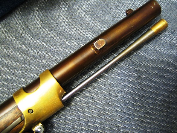

                      I posted earlier about the arsenal conversion of US Model 1841 where the barrel was turned down to accept a 1855 bayonet. I forgot to mention the other method whereby the barrel was turned down and a stud was attached to the bottom of the barrel for the purpose of affixing the 1835/1842 bayonet. I remembered that collectorsfirearms.com had an original Remington New York contract rifle that was altered in this manner. The photographs on their site provide a good visual reference of the firearm for those interested. They do have a bayonet in the photograph with the rifle, however it is in a later scabbard for the Trapdoor Springfield bayonet. I attached one of the photographs to this post.

                        This sort of modification would be fairly simple to do. They have kept the front band and stock as-is, and merely moved the sight back past the diameter reduction, brazed on a stud and refinished the barrel. For our purposes it'd be a really unique MS rifle for those that can't stand having anything that anyone else has ever even heard of.

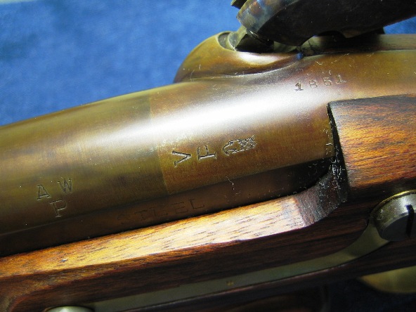

                          I thought I would be safe with a Colt alteration for many years to come...
                          Here is a closer look:
                          • #88
