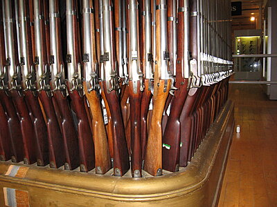

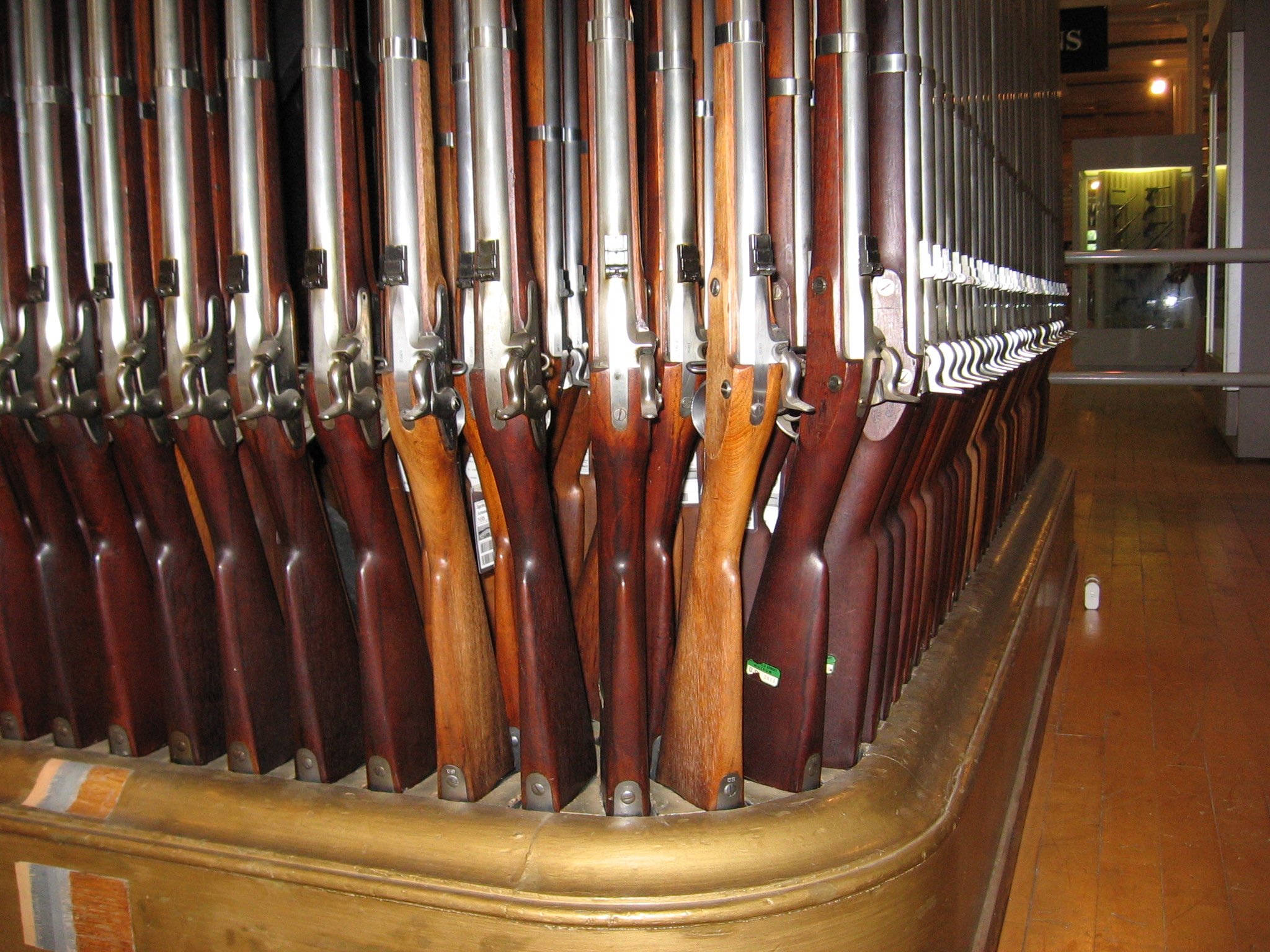

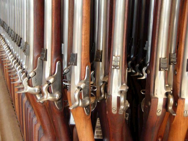

                        I was asked recently about the "appropriate color" for a musket stock. This question has come up in the past, so I thought I would post some pics to clarify the issue.
                        In a nut:
                        Walnut stocks on original muskets varied greatly in color, from a light honey-colored shade to dark brown or red-brown shades.
                        Attached are a couple shots of "The Pipe Organ" at Springfield Armory NHS that illustrate this point. The display consists of scores of US M1861 rifle muskets and three flint US M1816/22 muskets, all in superb condition.
                        For reproduction stocks, the main thing I try to avoid are visible bands of light and dark on the stock as I have yet to see an original musket with a two-toned stock.
                        Enjoy!
                        • Re: Musket Stocks - The "Right Color"?
                          Indeed!
                          And that is a range of Pennsylvania grown American Black Walnut on "Springfields."
                          And the Northern Italian Walnut used on British 3rd Model "Enfields," is a horse of a different color as well... :)
                            Those sure are some pretty pictures!
                            Michael Comer
                            one of the moderator guys
                              Thanks! As they say, they're "...worth a thousand words". Personally, I think that many of the ad nauseum discussions we have on these and other fora could be cut short and the debate ended with some good photographs. So, I'm making it a project to do just that, to whatever extent I am able.
                              Anybody want to loan me an unaltered Armi Sport and EoA Enfield? :tounge_sm
                                Thanks for posting the pictures. These great pictures bring to mind a question I have. I have heard that the rear sight on an 1861 was often blued. Was the whole sight blued, or just the sight leaves? How common were blued sights? The sights in the pictures look all blued, not just the leaves.
                                Lawrence E. Kingsley
