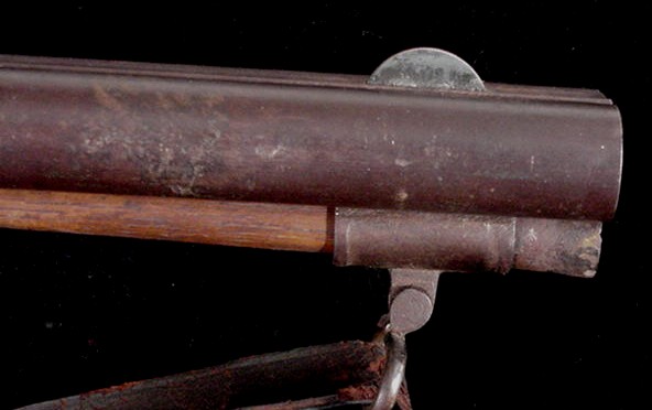

I am interested in defarbing a SxS bp shotgun to more closely resemble those carried early in the war by some confederate troops. Can anyone help me with information on the sling attachments? The front attachment is particularly vexing. I have seen drawings that appear to show a band of material (either leather or metal) at the forend, but there is not enough detail to be certain...

Check www.oldsouthantiques.com and click on "Past Items" to see a CS shotgun with from barrel bands. Hope this helps. What impression are you using this for other that just early war?

Thanks John,
...for the sling illustration and the view of a shotgun with a sight 'blade', not just a bead. It makes me wonder if this double barrel was used for firing balls and not just shot?
A simple sling for carrying long-barreled fowling pieces is made from a long piece of leather with a slit cut back from each end. One end can be looped and slipped around the barrel in front of the forestock and the other around the throat of the butt stock.
For cavalry, using the illustration in the EOG Confederate book as a reference, I used a sawed-off shotgun. The one I used had a brass strap-keeper off a McClellan saddle screwed into the stock to use with a carbine sling.
In practical use a shotgun gives one an extra shot, quickly, but takes twices as long to load as a carbine or rifle. It's almost impossible to load a fowling piece on a horse, the length of the barrel and the tiny pistol caps used are impediments, and I have read two instances where cavalrymen left them on the side of the road.

I own an original shotgun used in CS service with Birmingham (England) proof marks. The trigger guard has an iron loop, about 3 inches in diameter that probably was used as a sling swivel attachment. No front sight nor evidence of having one. Small compartment with a hinged lid on the underside of the rear stock, probably for caps. Silver fore arm cap.
Conversion to one like this would not be hard.
