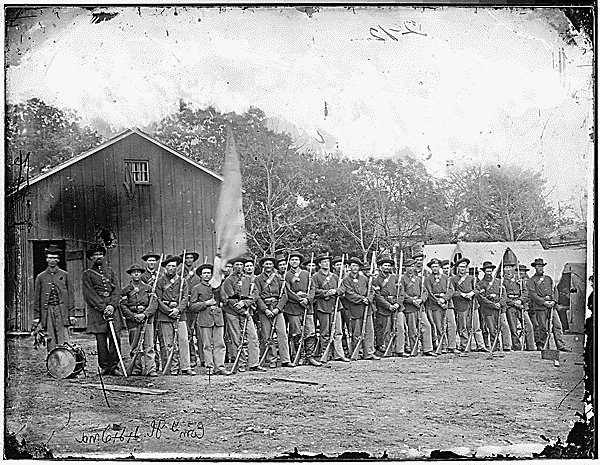

                      Building on some of the discussion, I have been looking at and debating some of my own ideas on wearing federal accoutrements.
                      I guess I am seeking some honest opinions on some observations I have made. When recruits were trained to load and fire, they were instructed to bring their cartridge boxes to the front, meaning to me that they were in a position farther back. I have tried wearing my accoutrements, particularly the cartridge box, in a number of variations based on evidence. When the cartridge box is under the belt, or on both the belt and shoulder strap, it is quite a chore to move it around. I wear my box pretty high.
                      Looking at photos, I see that the shoulder strap is very nearly completely under the armpit on some soldiers. The attached image is a perfect example. The only way I have found of duplicating that look, is to move the cartridge box all the way to the small of the back. My strap is of standard length, and I am 5'5" tall, and my box will fit into the small of my back with the strap falling under the armpit. If I leave the box loose, meaning not under or looped through the belt, it is no problem to reach around and pull it forward for firing. Just reach back and pull it around. It also doesn't bother me on the march or the run and is more accessible.
                      Look at the attached image and chime in on other thoughts.

                        Re: wearing accouterments
                        Comrades,
                        Comrade Possum Skinner wrote:
                        "When recruits were trained to load and fire, they were instructed to bring their cartridge boxes to the front, meaning to me that they were in a position farther back. "
                        That is not always the case, and to my mind, is another "reenactorism". It is a result of too much emphasis being placed upon Hardee's manual vice other systems for various weapons. Hardee's Rifle and Light Infantry Tactics encourages the men to pull the box around to the front, but his system was designed for a cartridge box that rode on the waistbelt only ( the model 1855 accouterment set). It was normally in the small of the back when not in use, and was brought around to the front to become, in essence, a belly-box for firing. A box worn on a sling cannot easily be used in this manner, and was, in fact, never intended to be used in such a way.
                        His system is also the source of the idea that the soldier is to "reach around" and grab the cartridge box when grounding or raising arms. That keeps the box, worn on the waistbelt, from sliding around when the men bend over. Boxes worn on slings do not have that problem.
                        The waistbelt was initially adapted for the enlisted man to keep the various accouterments in place when the men were moving at a speed faster than common time. Prior to the 1830's the cartridge box and the bayonet were both worn on slings (think Rev-War here). With the advent of the percussion system, it was found that a small pouch or box was the easiest way to carry the caps, and it eventually found it's way onto the waistbelt. Interestingly enough, the English initially placed the cap box onto the cartridge box sling, before moving towards the American system of belt suspension. Various bayonet suspension methods were also tried before devolving into the angled belt-worn pattern.
                        At this point the belt was not needed to hold all the slings in place, but WAS needed to keep all the other parts in place.
                        Anyway, I digress.....
                        The "pull the box to the front" only works when the box uses a waistbelt suspension. Any use of the sling negates that part, and you should just reach around and draw a cartridge.
                          Thank you for your observations Mr. Kindred. The use of old style manuals with modern (at least modern in 1861) equipment certainly explains a lot of the reenactorisms. It is interesting to note that the U.S. Manual of 1862, essentially a reprint of Hardees with another name, also instructs the recruits to pull the box forward. It seems like someone would have corrected this procedure earlier, but I suppose it might have been simply corrected in the field.
                          What about the position of the cartridge box sling on the attached photo? How is that particular look achieved if not by placing the cartridge box in the small of the back? It seems odd to me that these men would have just done that for the photo if it was not something they were used to doing.
