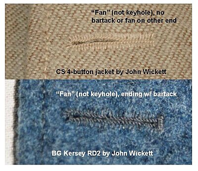

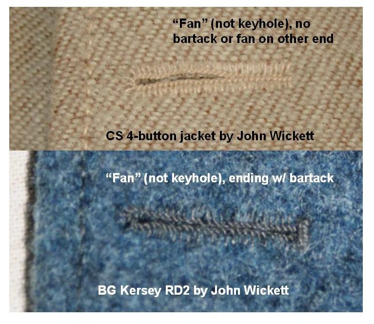

    OK... I'll get things going... gather those rotten tomatoes... here's two garments that I made this year.
    Re: Examining Repro Buttonholes (CS)
    Those qualify as "quite nice" in my book, John. The stitching, particularly on the brown version, is dense enough to cover the fabric entirely, without looking crowded. You managed the reinforcement/stabilization well, and your tensioning well, because the hole is quite straight, and not bowed out along the legs. Stitching depth is tidy, and looks to be well-suited to the fabric weaves (deep enough to be stable, not so deep as to "stand out" during use.)

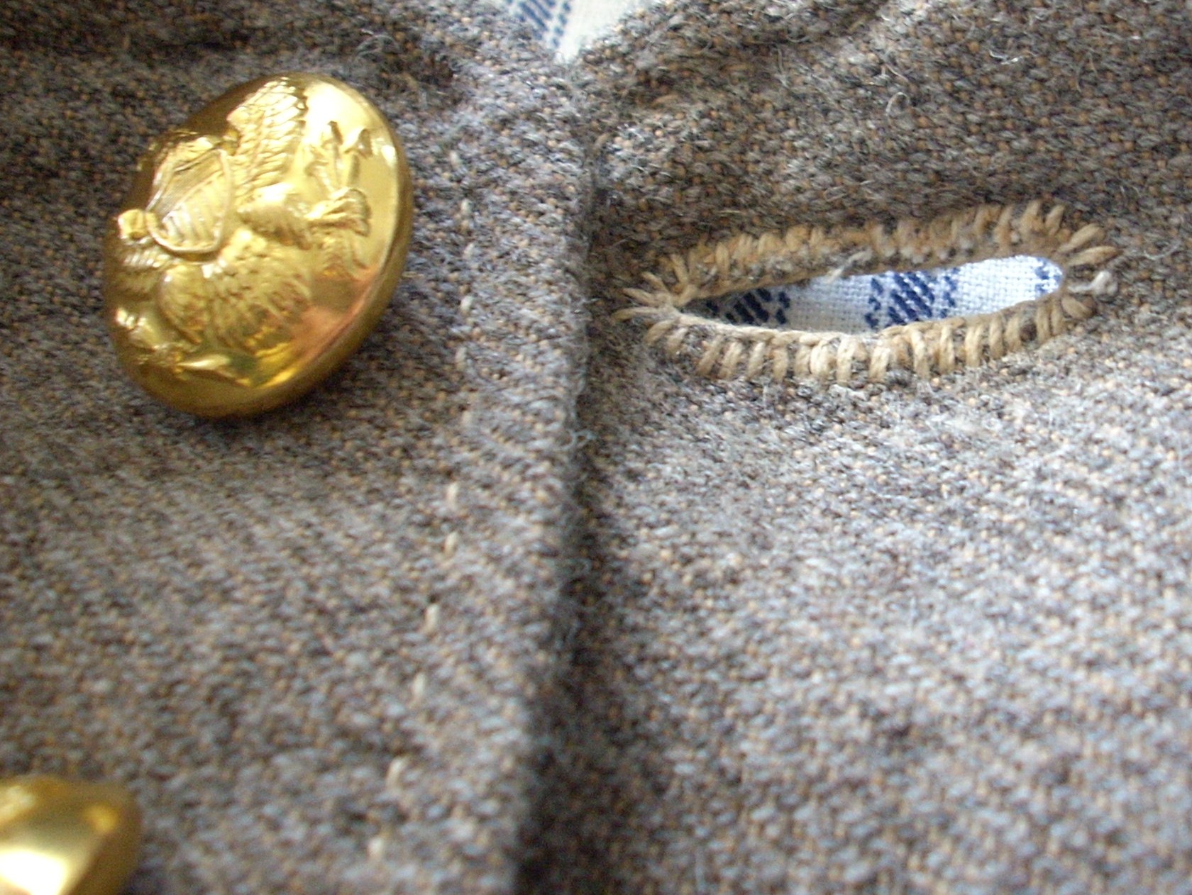

        Here was my stab to to hand sewn buttonholes.
        Here is the link to the entire garment.
        http://www.authentic-campaigner.com/...ood+sweat+tear

                Not much I can add to Elizabeth's comments. Looks like a pretty good effort. Your stitches are evenly spaced both from each other and the distance from the hole. The thread looks like a heavier thread, though... what is it?
                Paul,
                The hole looks like it really opened up during sewing. How are you cutting the hole? The instructions posted by CJ Daley have really been my "bible" for sewing buttonholes. One of the valuable nuggets in there is the recommendation of using wood chisels to cut the holes. You get a really clean cut that way, helping ensure they hole stays a "slit", rather than opening up. Most of my buttonholes that appear more open now are due to use, rather than construction.
