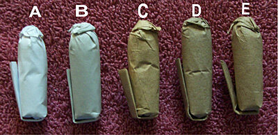

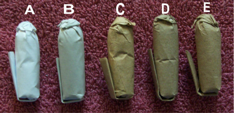

              I know this thread is a bit dated, but I thought it would be proper to post a photo of the different color paper I have on hand to make cartridges…
              A. Typing paper
              B. “Gray” colored typing paper. Note: This color is the same color as recycled newsprint I bought at Michaels!
              C. Paper that came from parts shipped in where I work, a bit lighter than 3-M masking paper
              D. 3-M masking paper I bought at Lowes.
              E. Shipping paper I bought at a UPS store, quite thick, and darker than D & C examples, but not by much
              I wish I could find a paper a bit lighter than what I made cartridge C out of. I have tried using “Ivory” colored typing paper I bought at Staples, but it’s too yellow, their “Tan” color is also too yellowish in tint.
              Not having read already mentioned articles on the subject, I’m of the opinion that the 3-M masking paper comes as close as we can get readily at Hardware stores, to match originals.
              I’m still looking for something better!

                Re: Which type of paper be used to make your cartridges
                Kevin Dally
                This may be your answer...
                I use the wrapping paper that movers use to wrap dishes and glasses in when packing for a move. The sheets I have are off white in color and tear easily with the teeth. However, they are strong enough to withstand twisting and folding for loads. Very nice paper for rounds.
                Avilable for purchase either at a local UHaul store or online: http://store.uhaul.com/Protective_st...Wrapping_Paper
                I also use it for wrapping cartridge bundles (10 rounds + 12 caps) and for wrapping hard tack packages.
                Useful stuff...
                Good luck!

                  Kevin, the ordnance manual specifiys 40 weight paper. In the past I have used 40 weight kraft paper which did very well.

                    50lb drawing or "cartridge" paper as it is also known as. Some research that I've done has turned out some very heavy weighted papers used. British military I believe used a 70lb paper.
