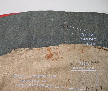

Sir,
The British size markings are most often found on the upper right of the center-back piece. When you're wearing the jacket, they would be on your left shoulder blade, close to the spine. I have not seen the jacket with the American system markings, so I do not know if it was in addition to or instead of the British markings. This photo shows the markings in the Lt. Michael Glennan jacket. Image courtesy of the Museum of the Confederacy.
The information you seek about uniform issue sizes can be found in the Quartermaster manual. Mr. Daley has posted the relevant excerpt from the Federal QM Manual on his research page at http://www.cjdaley.com/issuesizes.htm One would have to check the Confederate QM Manual to see if the size specifications are the same.Michael McComas
