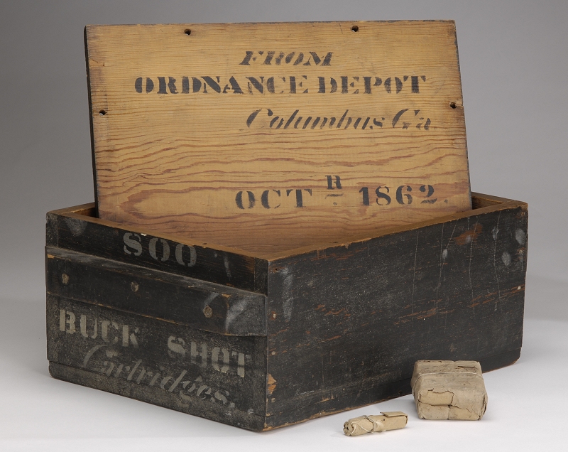

                          Pic of shotgun round associated with the Columbus Arsenal:
                            Re: shotgun ammo
                            Hi,
                            Here is a picture of a 69 caliber buck shot ammuntion crate and pack, made by Columbus Depot. The picture is part of the Wray Collection.
                            Andrew Kasmar

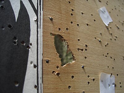

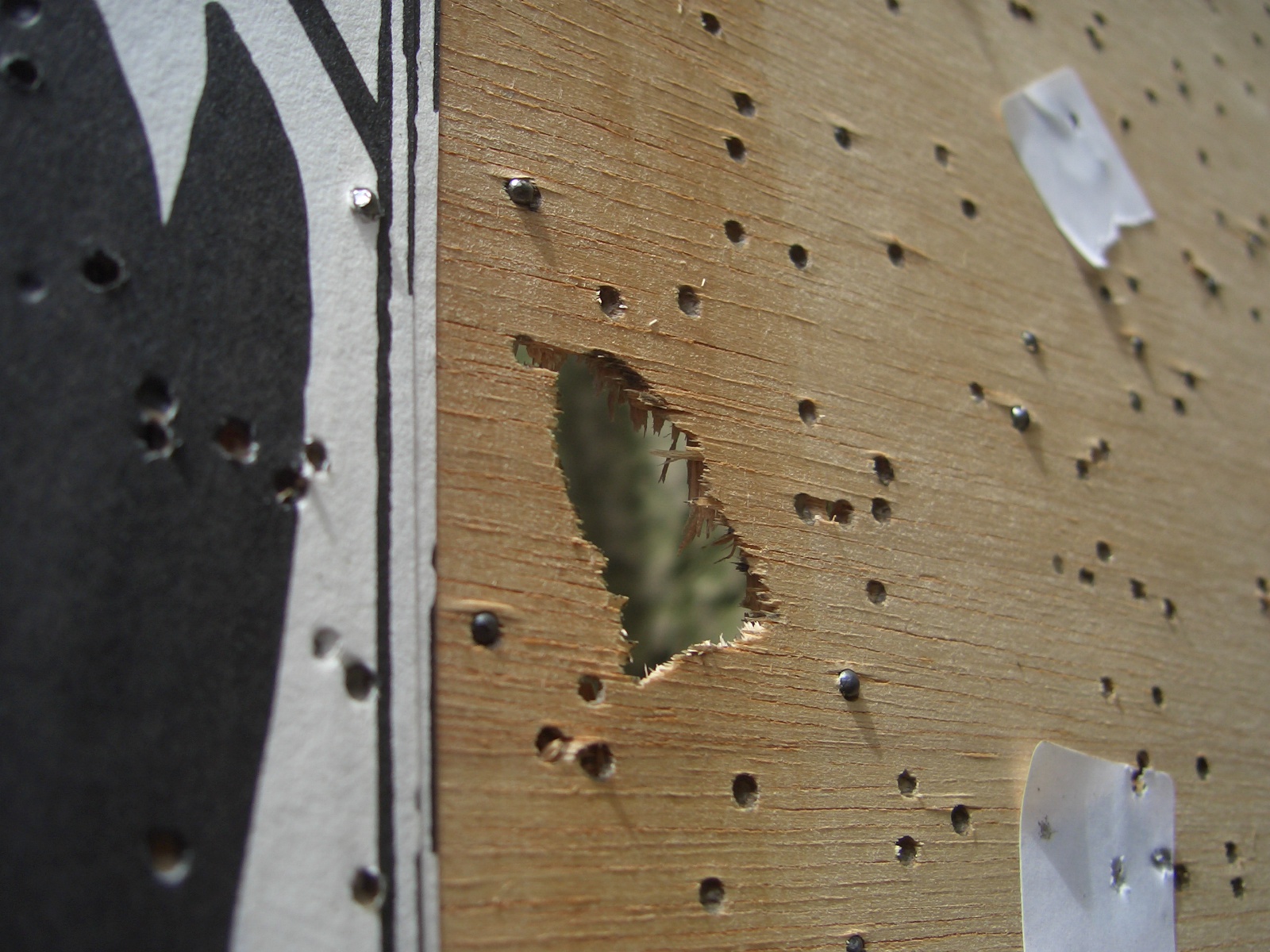

                              Having experimented with black powder shotguns I am now wondering about wads as I came across an unusual effect. My two test weapons are a 12g percussion DB and a .69 1842 smoothbore. I have shot clays with these with some success and it was the clay shooting clubs regulations that caused me to question this. They Demand that fibre wads are used. Bear in mind that to 1lb of shot we are applying 60grains here with some success against clays but this is a light round with good disperson but little real power and so when we upped it to a better power 85g against board test targets. The spread tightened and we were able to get real man damaging penetration. Then the effect occured. My shot cluster morphed into a bullet. A little experimentation with paper wads showed this was only likely to happen 10%(ish) of the time. This was of course caused by flames seepng around or through the paper and welding the shot into a lump. Very understandable now why the clay club has this in regs. Anyone know if they used leather wads or the like with these shotgun ammos to stop this happening as the resuting shot weld is irregular and unpredictable?
                              I flask load the powder but pre roll tubes for the shot. (Which is then brightly marked with pen to ensure it is not mistaken for powder cartridge.)
                              Just out of interest we also drew the conclussion that even wadded slugs from a shotgun tumbled badly, LOL, as this pic shows. This has an adverse affect on accuracy. But a nearly correct fitting .75 Brown Bess ball in the 12G acheived consistantly better results so I would stand by the earlier conclusion that they would use .69 in the period 16g Shotguns as this is a close fit and would acheive similar results. Hitting a Man sized target at 50m was no problem and a good many were hitting the 100m target and this was with no rear sight.
                              Excuse me for this as I often think if you want to know if something works just try it and see.
                              Having just measured some of my thimbles one is about 16g/69cal, 70g when filled and therefore would make a just less than 1lb slug and this would seem reasonable. as for railcars at 300yrds well that would depend on what the car was made of and how the bullet was wadded. The bullet in the pic below is 1lb at 50yrds.
