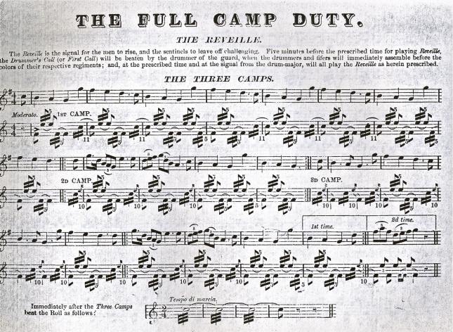

    Correct if I'm wrong, but I don't think Strube specifically said always play 7 stroke rolls, or 10's or 11's or 15's for that matter, from left to right---he just showed them that way, and not the others, in the lessons.
    Has anyone seen this blog? http://robinengelman.com/2010/06/24/...-1853-to-1869/
    Anyway, it conveniently has a page from Strube, which helps me to continue to beat this dead horse. See how the 11s are in the middle of the staff? Top of the staff means start with the left and end with the left, bottom of the staff means start with the right and end with the right, and the middle of the staff means start with the left and end with the right
    So to answer the question, yes, Strube showed in the lessons that 7s, 10s, 11s, and 15s are always played left to right, and indicated with his notation that they are always played left to right.
    Now that I think about it...Strube is probably the only manual from 1850-1870 without errors.
    Conclusion: don't play your 7 stroke rolls backwards, if there is a backwards 7 stroke roll in a manual, it is an error.

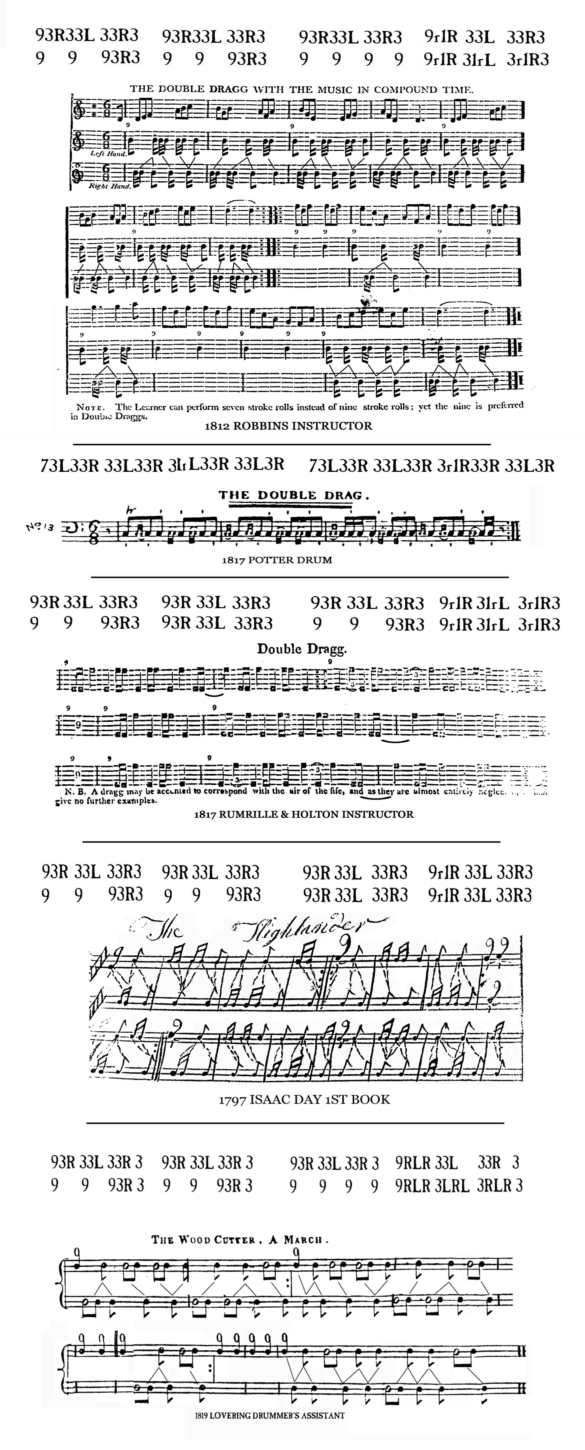

                            If Benjamin Clark was weird, then so were Charles Robbins, Rumrille & Holton, Isaac Day and Levi Lovering. That is how Double Drags were played in America up until at least 1819, and in print until Klinehanse in 1853.
                            15's are always beat left-to-right because as I recall they always end on the downbeat of the new measure. Not true for 7's.
                            I think we have a different definition of hand-to-hand, mine being back and forth between left and right, typically reversing the sticking.
                            You also can't apply "common sense" because there are many instances where the beating is purposely harder to play the way it is demonstrated than it could be played otherwise. I think some teachers just liked to make things a little more difficult to do. Or were they errors? I'm not making that call.

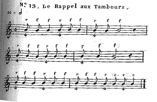

                                Not taking into account that most manuals didn't show you left and right hand sticking, I pretty much agree with that. Certainly by 1870 that was universal. In 1861, who knows, maybe not so much.
                                By the way, here's the original version from the 1831 "Ordonnance sur L’Exercice et les Manoeuvres de L’Infanterie"
Name:	1831 French Drummers' Call.jpg
