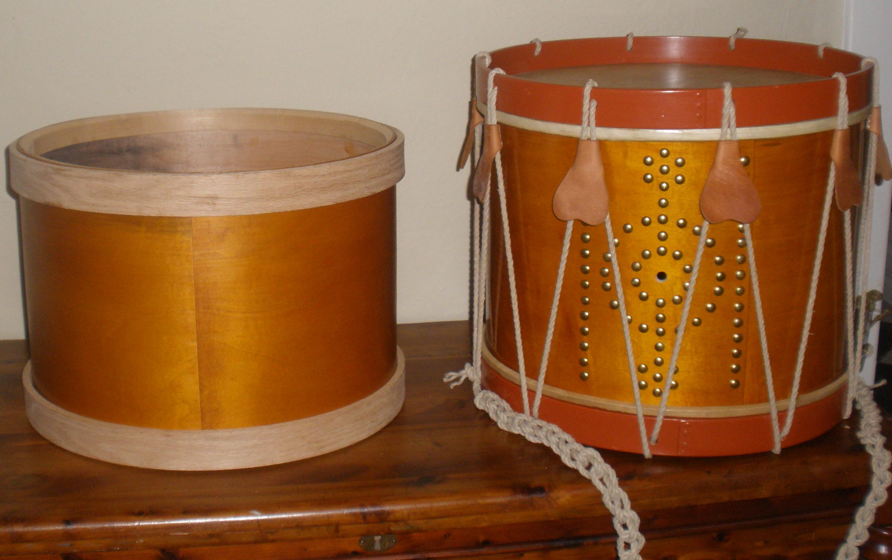

      I still think the originals were made out of maple. That was the main reason I didn't buy one. The prototype I saw at Gettysburg Remembrance Day a couple years ago was very well-made. But to me, there's just a big difference between poplar and maple. According to their research, in the 1800s they used lumber from the tulip poplar that grew on the land they owned. But I think they should have based the reproduction on the surviving originals, rather than some notes from the factory. Maybe they used the poplar for their toy drums...who knows? But I'm kind of glad they didn't make any out of maple because it inspired me to make my own steambent maple shells!

          I have seen and played the snare Will Chappell made pictured above. Let me say it is BY FAR the absolute best reproduction drum I have ever handled! Hands down, Will has blew away all the big drum makers with his repro! If you want a drum done the right way that is top shelf and beyond anything you can get from anyone else you need to check out one of Will Chappells drums!!!

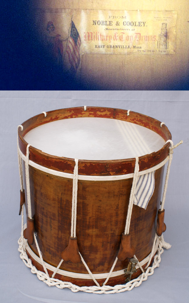

            Well, the original Noble and Cooleys didn't have a decorative brass tack design so they did try to say true to the original with the copper cut tacks.
            Here are a couple original Noble and Cooleys. Note that somebody put that rag in one of them when they "restored" it. To my knowledge, Noble and Cooley isn't putting rags (mufflers) in their drums.

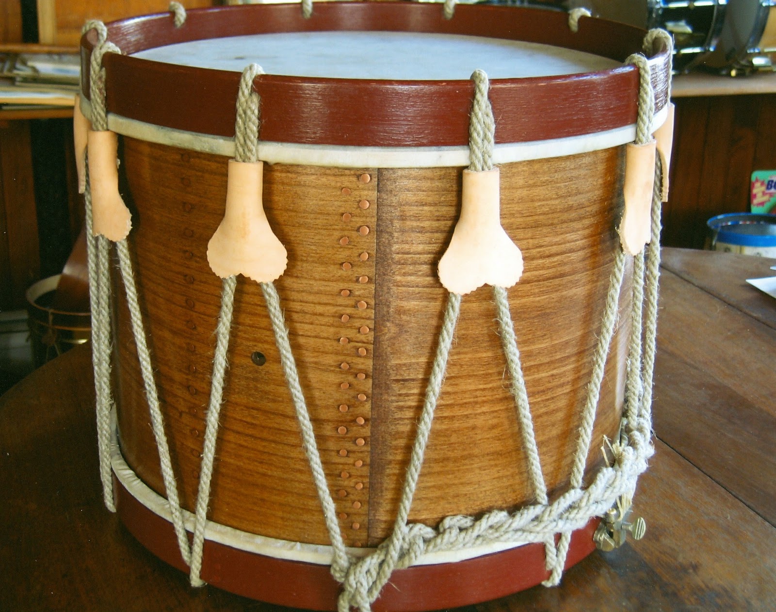

                  Here's the prototype repro made from poplar.
                  I would be interested in seeing photos of more Noble and Cooley repros. Two original Noble and Cooleys are shown in my earlier post.
                  Of course the Noble and Cooleys are well-made. But in this hobby, the accuracy of a reproduction is judged not only by the techniques used to make it, but also the raw materials.
                  I would say N&C has done a great job with the craftsmanship, but are the materials, i.e. the wood used to make the shell, true to the original?

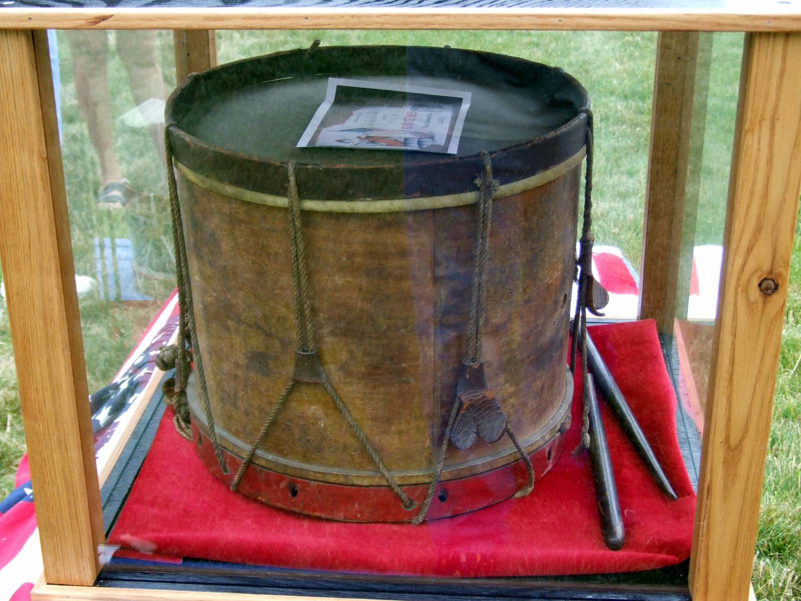

                        Thought I would post a picture of the drum.

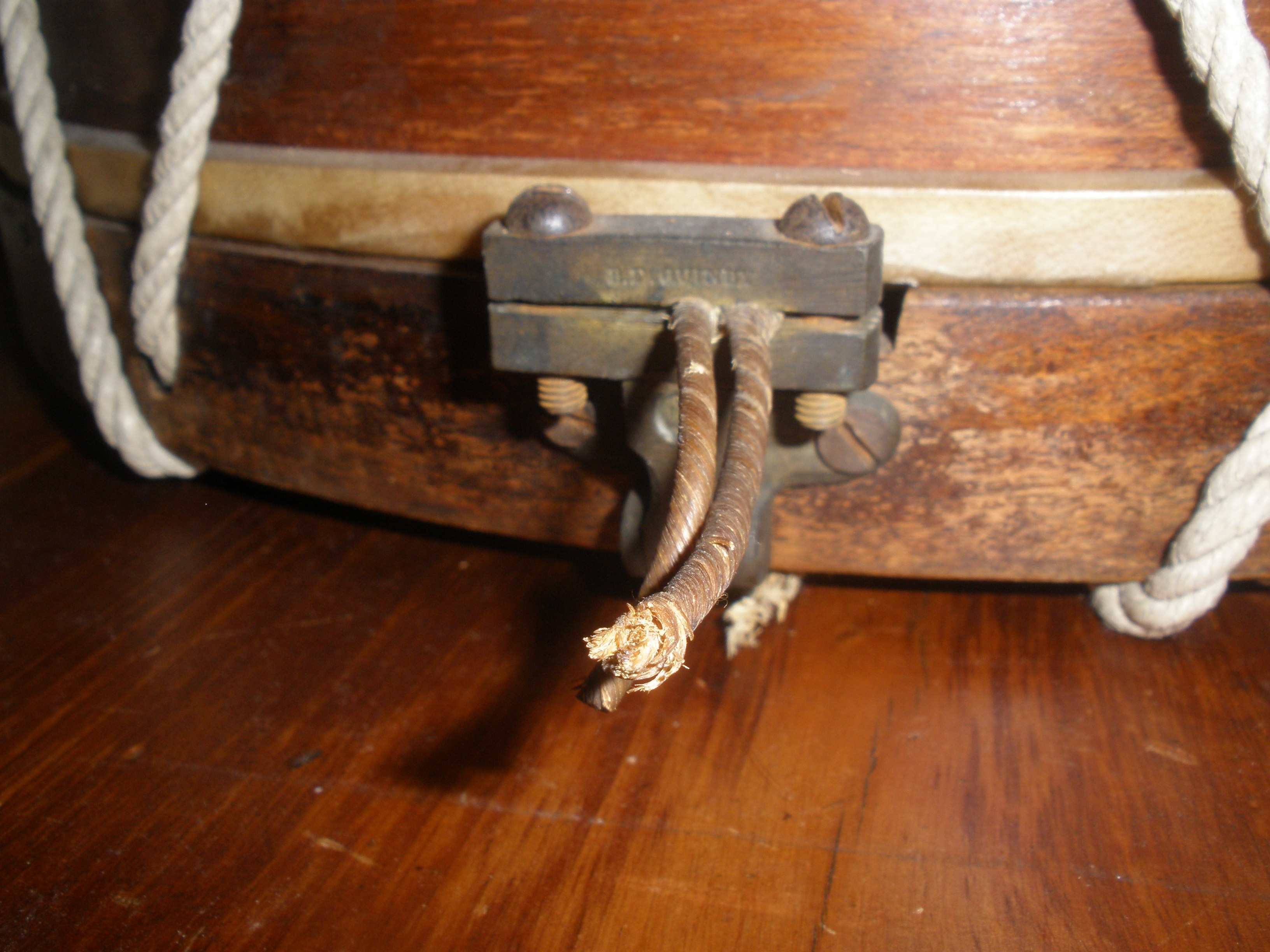

                          What are yalls thoughts on this strainer? Jay Cooley told me today that George Carol is making them for him. If it were my company, I would look else where.

                            The strainers are made by an Amish man by the name of Emmanuel King at the Cattail Foundry in Gordonville, PA. They're $15 each if you purchase from him directly.
                            They compare favorably to the one on my John Lowell drum (attached), and this style strainer was the most commonly found on period drums. There were of course slight variations from maker to maker.

                              Also, I've never seen an original with more than 6 strands of snare gut. Small detail I know but just saying..... I'd also go with a little thicker gut. The thin gut seems to be more prevalent on turn of the century drums from what I've seen. The drum doesn't look bad and I love the paint they used for the hoops. They should have sourced their rope through Will and got that kick butt hemp rope that is dead on to the original. Again, I mentioned that to them in Gettysburg in 2008 and it went in one ear and out of the other apparently. Looks like they are using that cotton cooperman rope that cooperman likes to call linen, yeah ..... Right it's cotton sorry to burst their bubble. Also, man how pretty a Maple shell would be! Poplar is just not a pretty wood when finished. It has a lot of grey runs in it. Have an artist throw an eagle on that thing and make it a kick butt eagle drum.
