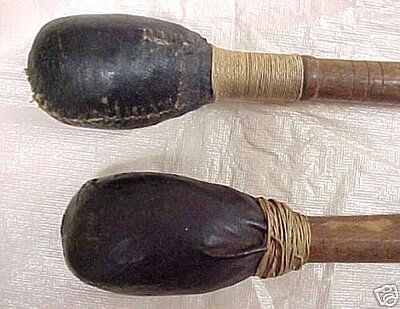

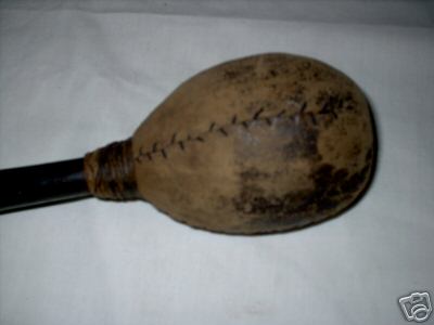

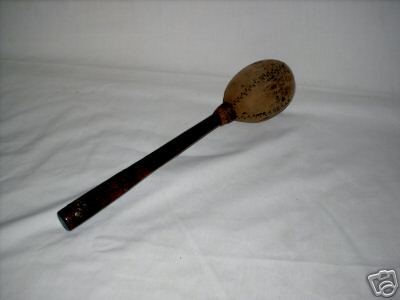

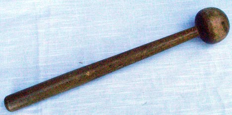

          For your amusement, a plain wood beater, possibly from the CW era

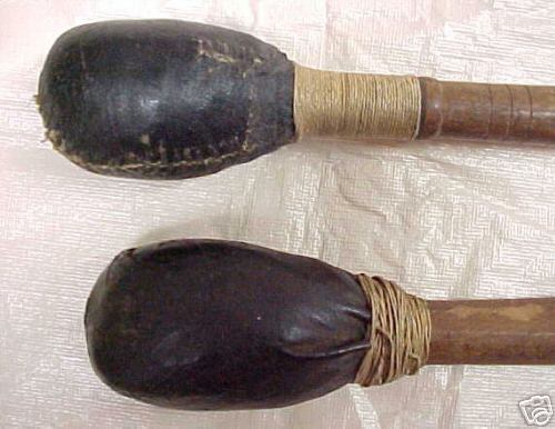

          And some more examples:

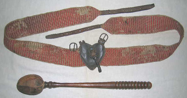

            And another bass beater and cool sling. We have plans to reproduce this sling as well. Anyone have any ideas of where to get the webbing?
            The beater in this picture is more like the type Will is reproducing. The exception is this beater has has the fancy design cut into the handle.

              Very cool beaters and sling. Just as described in R&H. I know Needle and Thread in Gettysburg has regular white cotton webbing that I have used to make slings. Perhaps they can refer you to other vendors that might carry a fancier pattern webbing.

                  Mark, I forgot about that thread. I did get that image from E-bay. A very cool sling it is. Our Bass Drummer is slow to fall due to the straps we have for the drum now. We normally have to help him out with it. Hopefully when we make this sling it will solve that problem. It will be a very authentic and unique sling and it will look cool too.

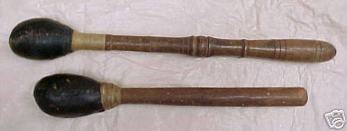

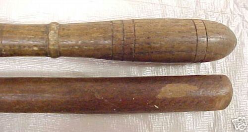

                          I can't believe how many originals are on ebay this week.
                          Ebay 140173621608
                          Will Chappell
                            Re: Period Bass Drum Sticks
                            Doesn't surprise me. They're on ebay all the time, and can usually be picked up for less than $50. I've got nine, and no two are alike.
                            The double beater method seems to have been the rare exception, based on the lack of surviving pairs and looking at bass drumers in photos. Nevertheless, Hart in 1862 had bass parts which used two beaters. So I'd say, generally one, sometimes two. Probably the more advanced corps with fancier music used two.
                            Of course how old are these beaters? Hard to say. Not alot of technological innovations in stick design over the years. As with snare sticks, the only distinguishing feature I can see is later, more modern sticks tapered much less. Most modern sticks are cylindrical. The drumming theory through the nineteenth century apparently was you had to have that counter wieght on the back of the stick for balance and good drumming. That theory apparently died in the 20th century, and is almost non-existent today.
