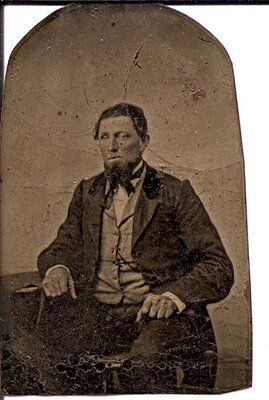

    The woman's clothing/hair for the wedding picture are very 1840s; Cornelia has 1860s sleeves, Grandma could be anywhere from the 1840s into nearly 1860s, and the mother/child could be sisters, and holler 1840s, possibly into the very early 1850s (but I'd say 1840s more).

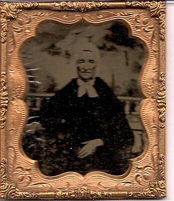

        Also, you can consider the dress of the person, but most importantly, you must take into consideration the age of the subject & the type of image. The elderly lady for example appears to be on a tintype, however, this type of image was not made during the timeframe her clothing would indicate. She would have continued to wear clothing representative of her era, the 1840's.

          But, just to confuse things: women did not necessarily wear out of date things, and the old lady is not necessarily wearing out of date clothing... I do place her anywhere from the 40s to the 60s, but without viewing the photo first hand, it's hard to miss the clothing details that will place her far more specifically. Many telling aspects of women's clothing is easily and cheaply updated, and clothing does die a natural death at some point, even with very good upkeep and care; holding onto 20 year old styles is *not* the norm.

              Thing about Grandma is based on the image medium it could not be any earlier than 1855 (if it is a tintype).
              However upon closer examination of the image I notice that there seems to be some flaking?
              To the owner, is the image on glass or on tin?

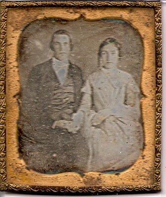

                What I have denoted as the "wedding image" is a tintype with a brass mat between the image and the glass. It is encased in a union case of leather with a flower motiff on the exterior of the case. The image is very silvered, to such a extent that the scan provided is the clearest way of viewing the image.
                The second image, "Cornelia", is another tintype under glass within a gutta percha union case. The interior of the case has a label for "Littlefield, Parsons & Co., Manufacturers of Daguerrotype Cases. L., P., & Co., are the sole Proprietors and only legal Manufacturers of UNION CASES with the Embracing Riveted Hinge. Patented October 14, 1856, and April 21, 1857." Red velvet pad with pressed design facing the image.

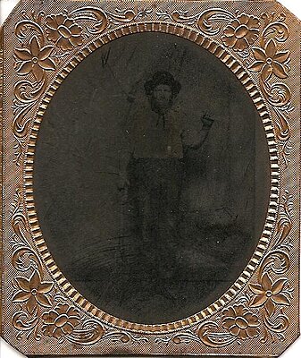

                "Garrett" is a tintype with heavy dust and aging. The brass matting around the image carries the imprint "Holmes Booth & Haydens Superfine." on the left side of the mat, and "Waterury. Conn. No. 43." on the right side of the image. By the way, this is my favorite image, as you can see sleeves rolled up, braces, and areas of wear on the pick axe over the shoulder. I have no true way to prove it, but I BELIEVE (and I've been wrong before) that this may be an image of a relative that went to the California gold fields.

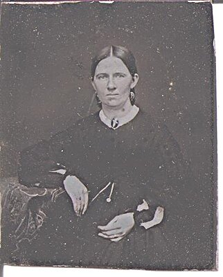

                "Grandma" is in a half of a union case made of pressed leather or treated cloth (more than likely leather, but I know there are people out there more knowledgeable than I about what these cases were made of. It looks like leather to me.) Pulling the image from the case, which I should have done in the first place, there is a tax stamp on the back of the image with a cancellation from Palmyra, NY dated May 22, 1865. Tintype. There is some puckering of the image on top of what would be her right hand.

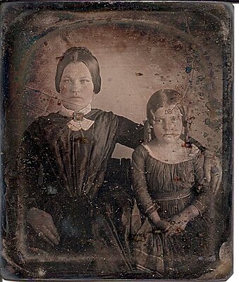

                "Mother and Child" is again in a leather union case with a floral motiff on the exterior, red silk/satin? lining facing the image on the interior. This appears to be on a sheet of copper rather than tin. There are scraps of paper used as shims that look like they were cut from the newspaper, but nothing that I can make sense of. This image is also so silvered as to be best viewed at an angle or with the scan provided.

                  The "wedding" image and "mother and child" are daguerreotypes (photgraphic images made on silver plated copper - very different process than wet-plate collodion). Judging from the medium and the dress, these both appear to me to date from the mid to late 1840's.
                    It is also possible that this is a later copy of a daguerreotype. As Ms. Clark pointed out though its hard to make a call on this without examining the actual plate and image in person.
                      Minieball's assumption is correct regarding this image, it is a daguerreotype, especially with your description being almost 'silvered to the extent that scanning was the only option'. It is very unlikely it is a copy or photo of a photo.
                      This is great, because you can almost 99% date the image. However, the tax stamp indicates when that image was made, not necessarily when it was taken, so if this is a copy, it could have been taken earlier, or in other words a copy of the original photo. Closer examination would determine this. Tax stamps on photos were utilized between Sept 1864 - Sept 1866.
