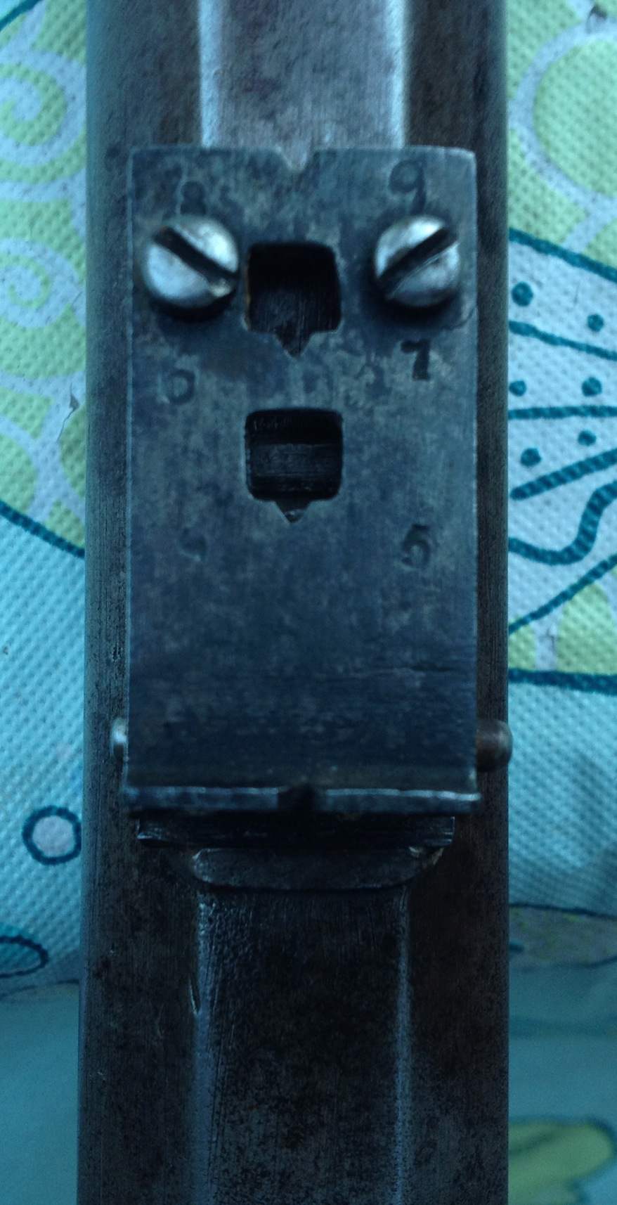

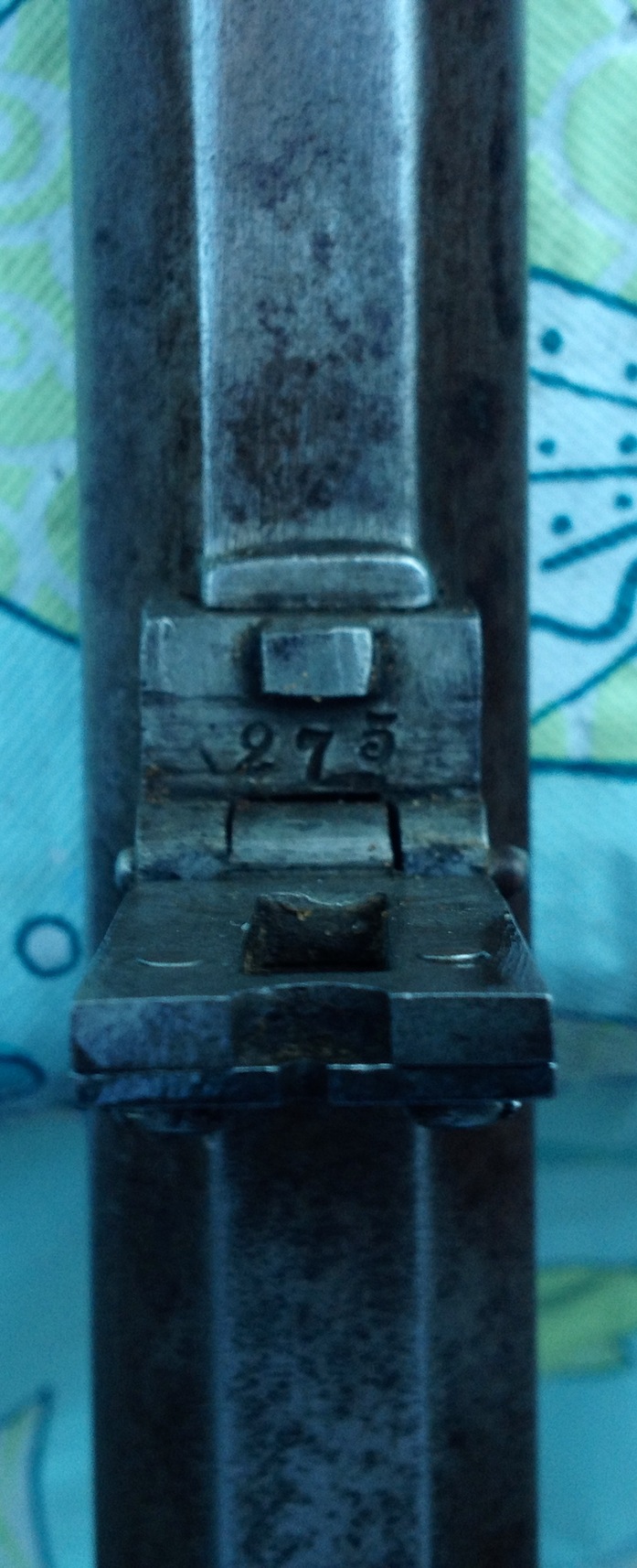

    Markings under and on top of long range site:
ID:	230924 Click image for larger version

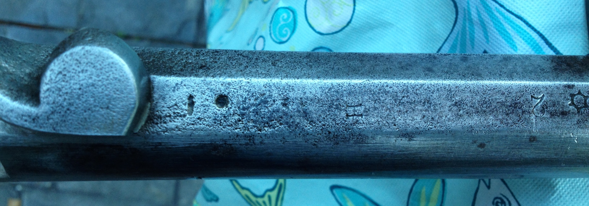

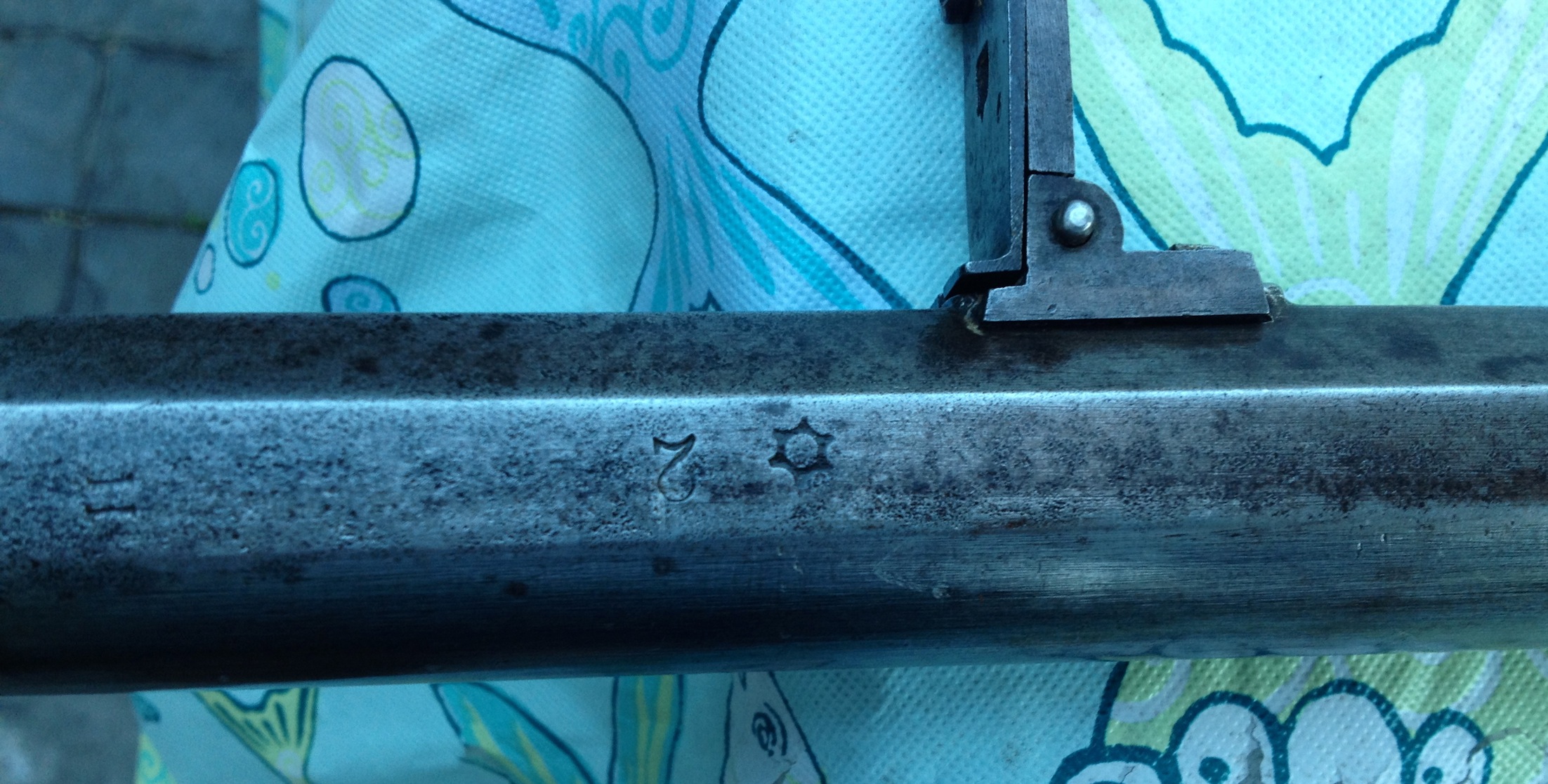

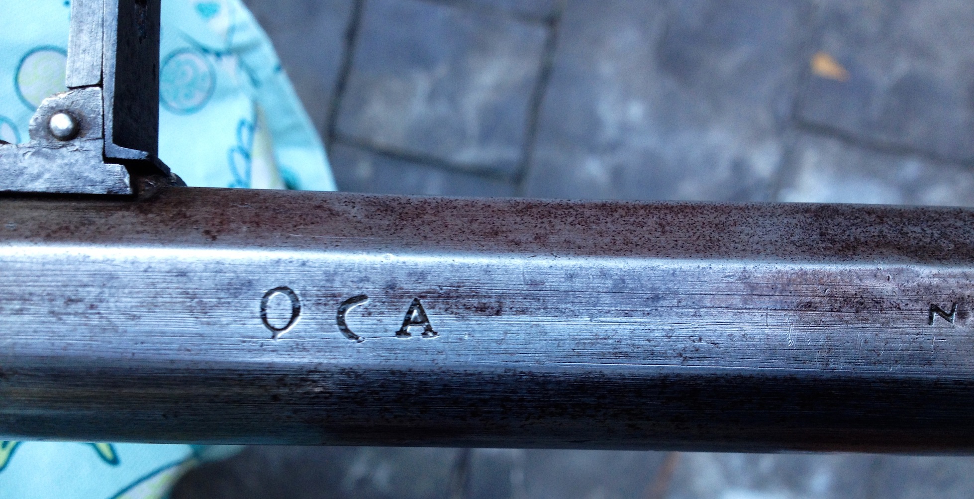

    Markings along sides of barrel. Some of these are partially concealed below the woodline of the stock:
ID:	230925 Click image for larger version
ID:	230926 Click image for larger version

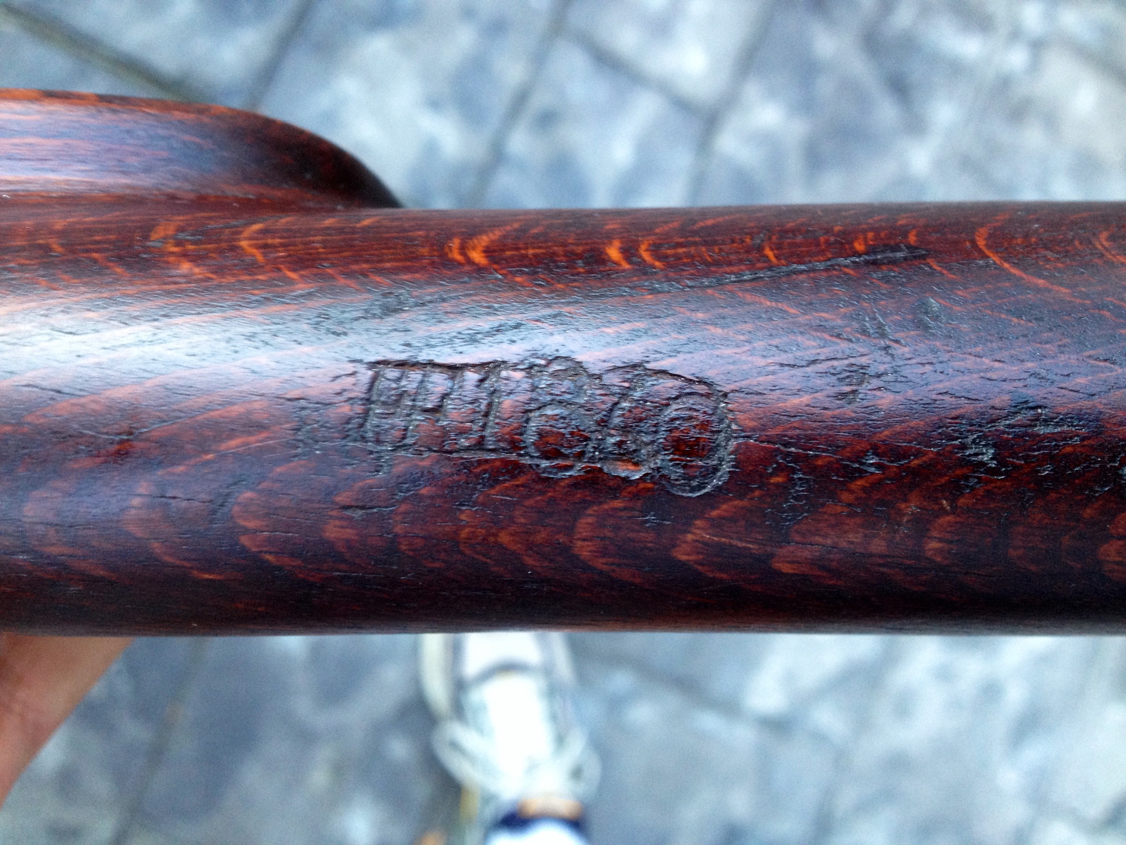

    Stock Cartouche "FF1860". I believe the "FF" is for Ferdinand Frueth... although I have no confidence that I'm spelling the last name correctly!!

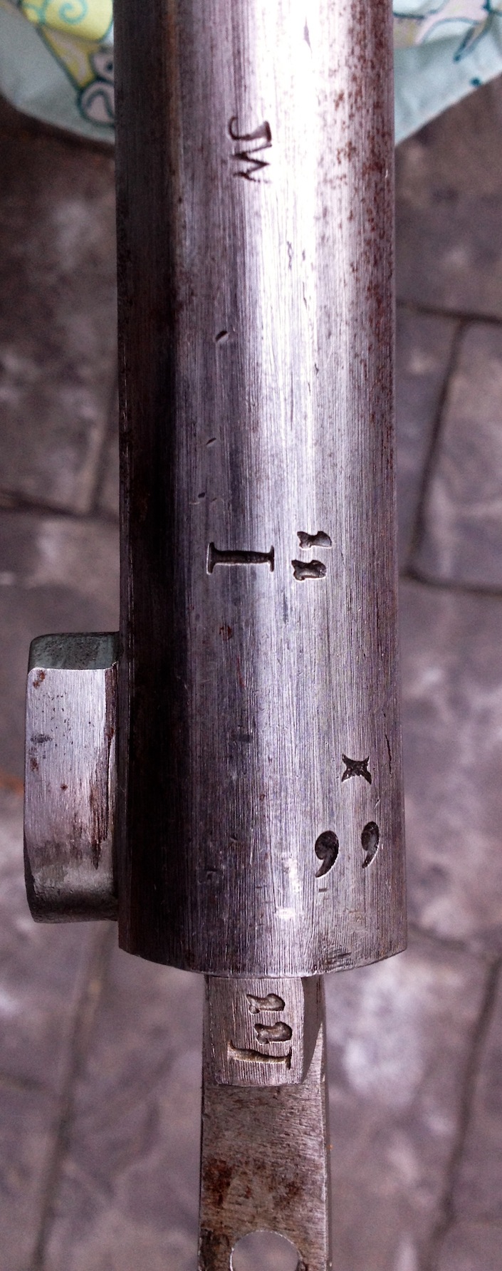

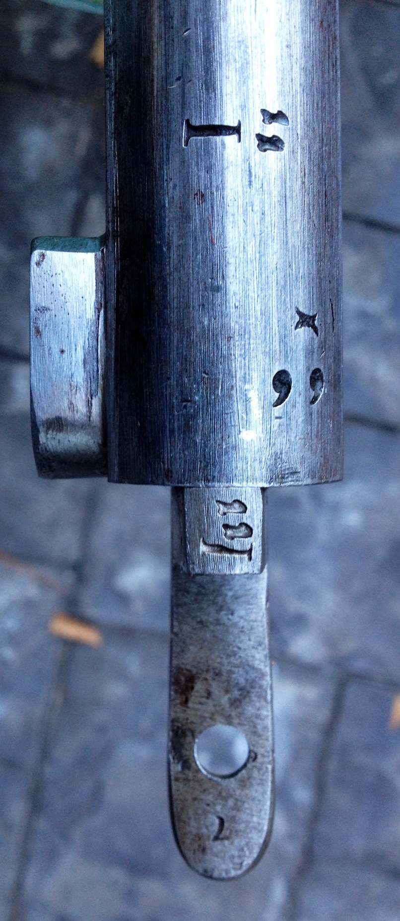

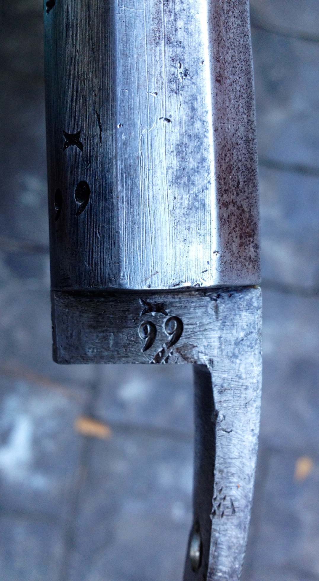

    Barrel markings concealed when the barrel is installed:
ID:	230929 Click image for larger version
ID:	230931 Click image for larger version

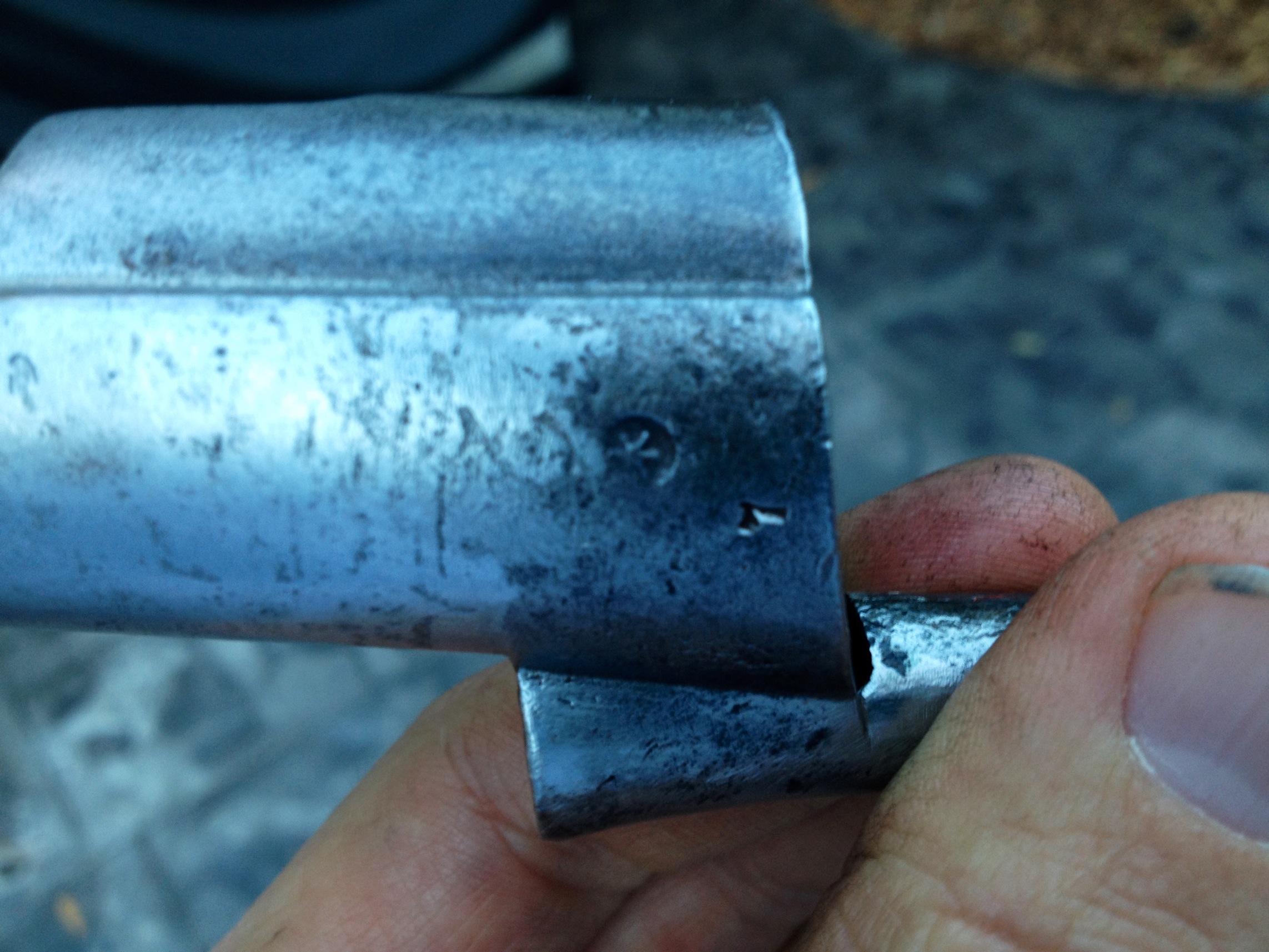

    Top barrel band:

      I found it interesting that my initials are on the bottom of the barrel! ;-)
      (see IMG_1867)

              Re: Detailed photos of Lorenz markings
              Mr. Wickett,
              Regarding the markings on your Muster 1854, Type II, System Lorenz rifle:
              Photo 2: The numbers are long range markings in hundreds of Schritt (i.e., "4" equals 400 Schritt). A Schritt was a military pace 29.5 inches long.
              Photo 6: "FF" was one of the marks used by Ferd. Fruwirth, Vienna, Austria; one of the major Austro-Hungarian Army (k.k. Army) firearms contractors.
              Photo 10: The "star" appearing marking was a k.k. Army inspection and acceptance stamp. One often sees it on bayonets.
              The other barrel markings are from individual workmen, assembly numbers, and proof markings. Unfortunately, I have been unable to find a "crib sheet" in English or German to translate them. One also often finds unit markings, but not in this case.
              Don Dixon
