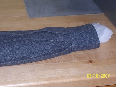

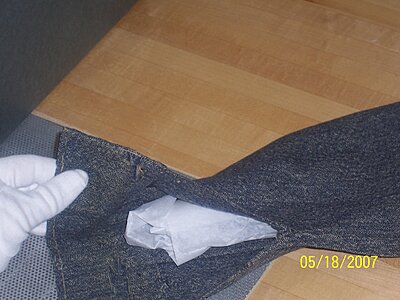

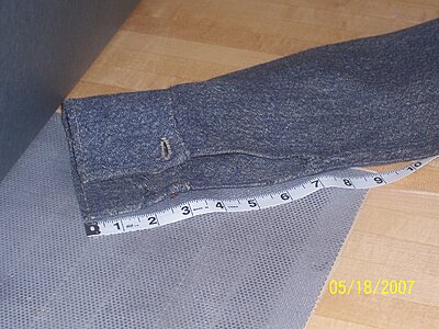

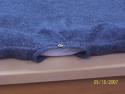

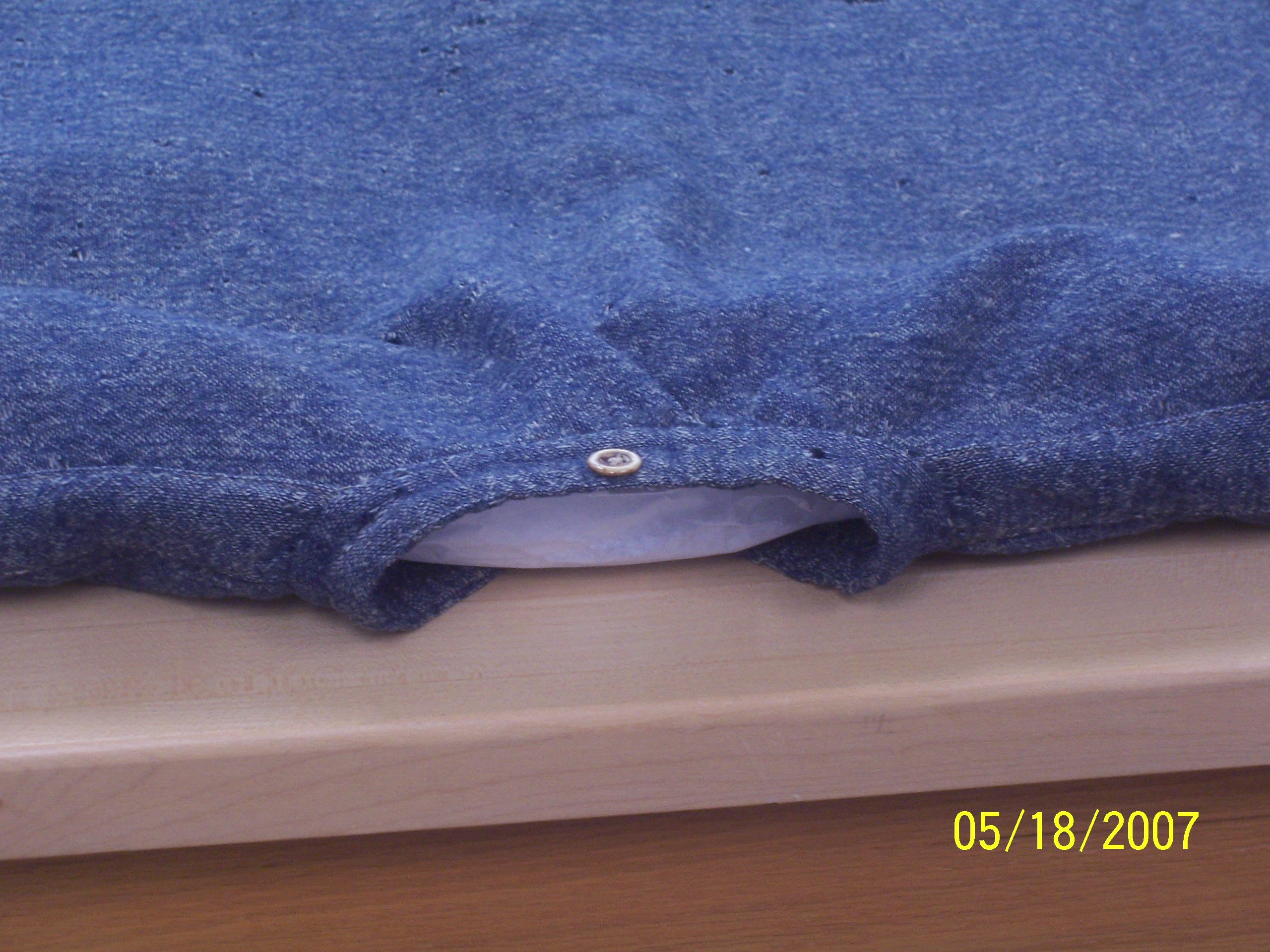

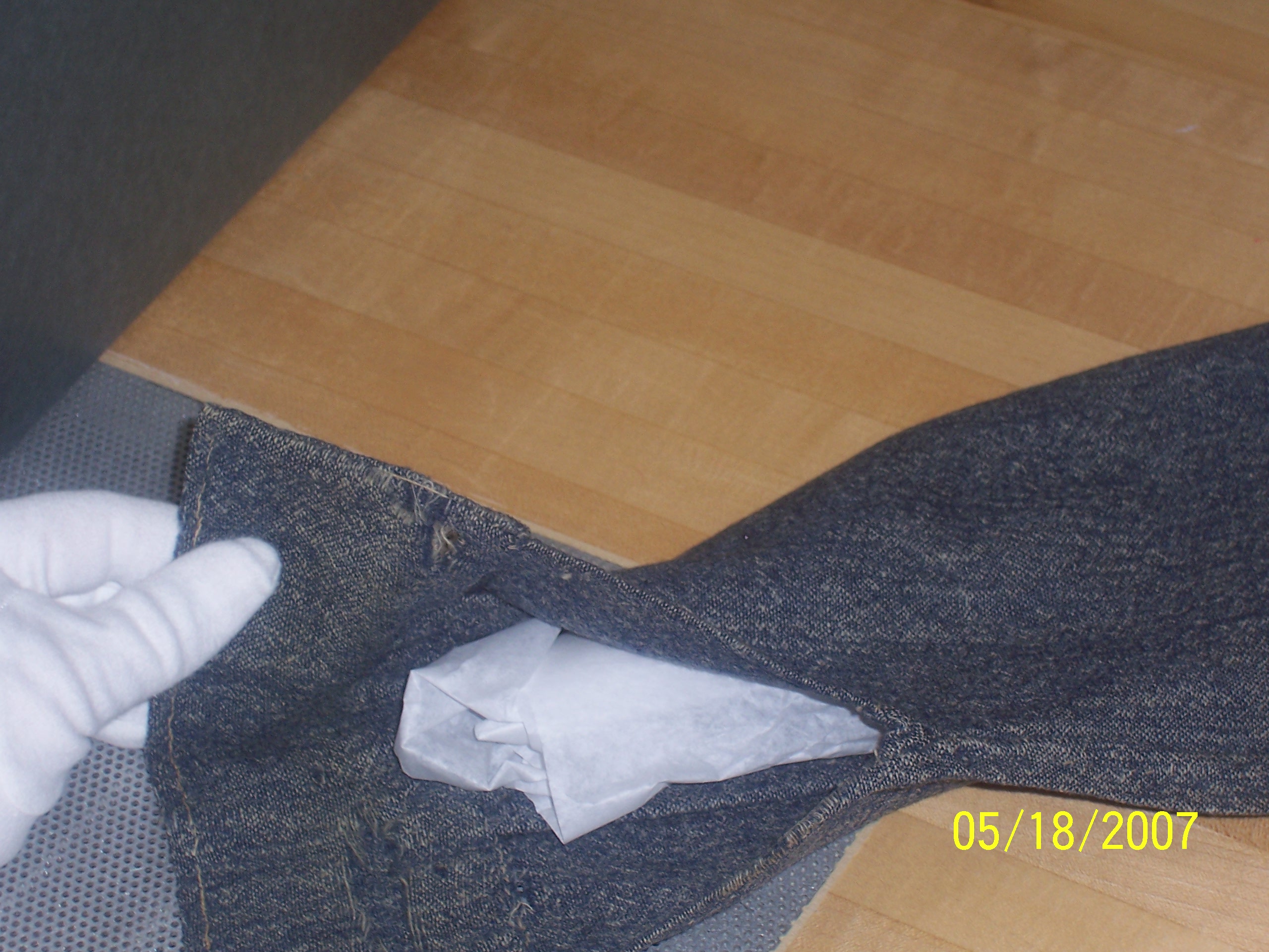

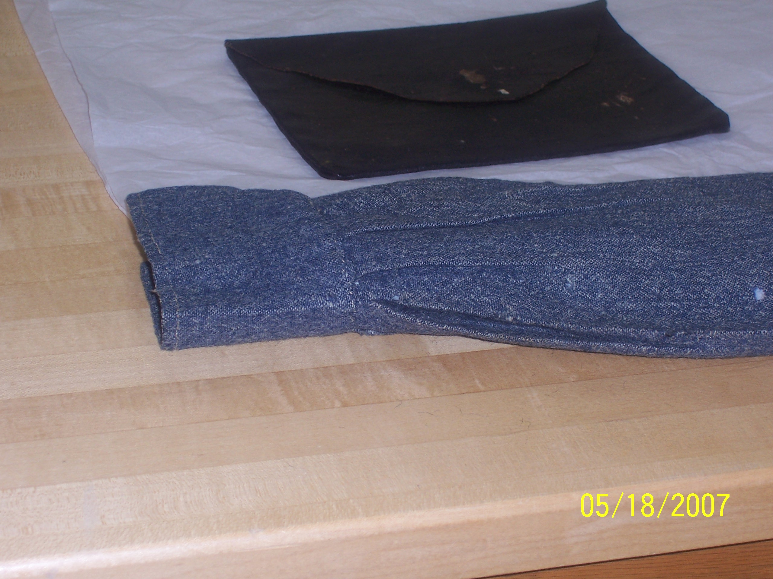

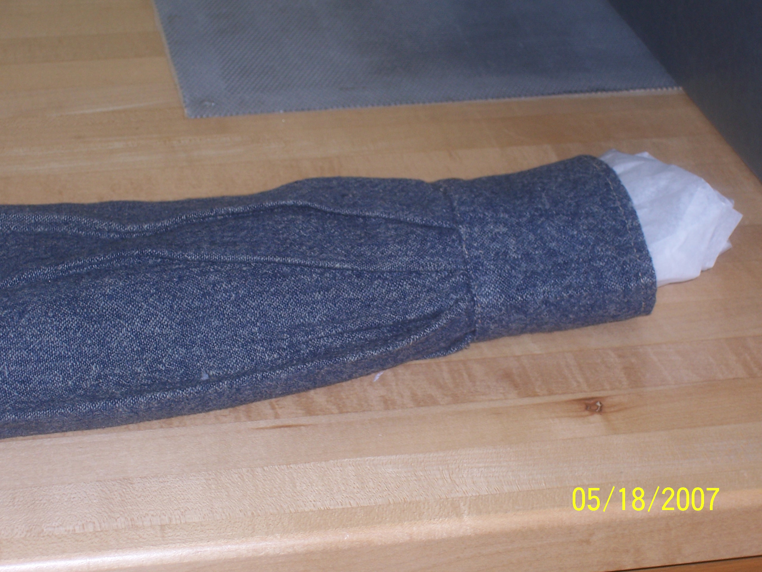

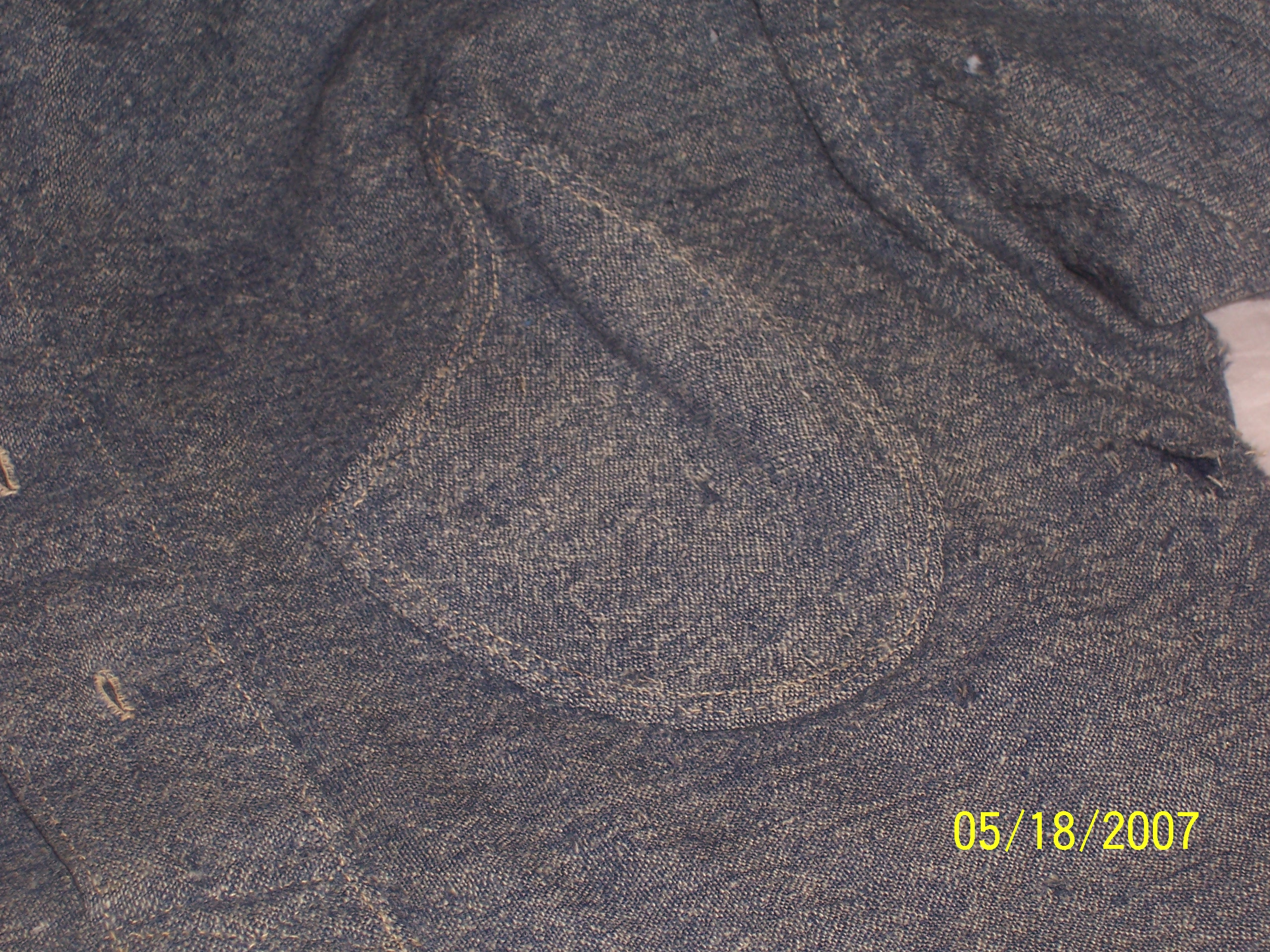

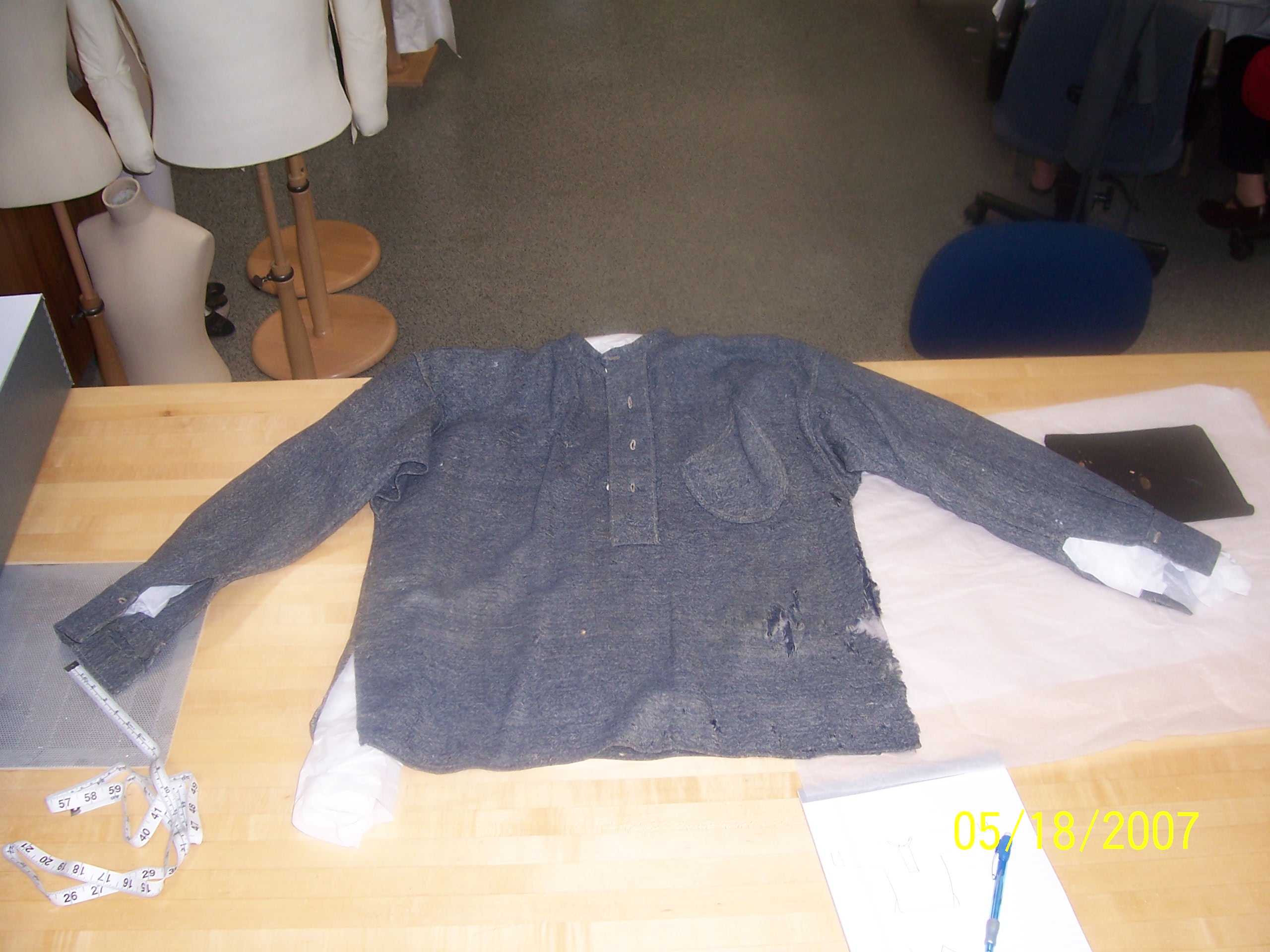

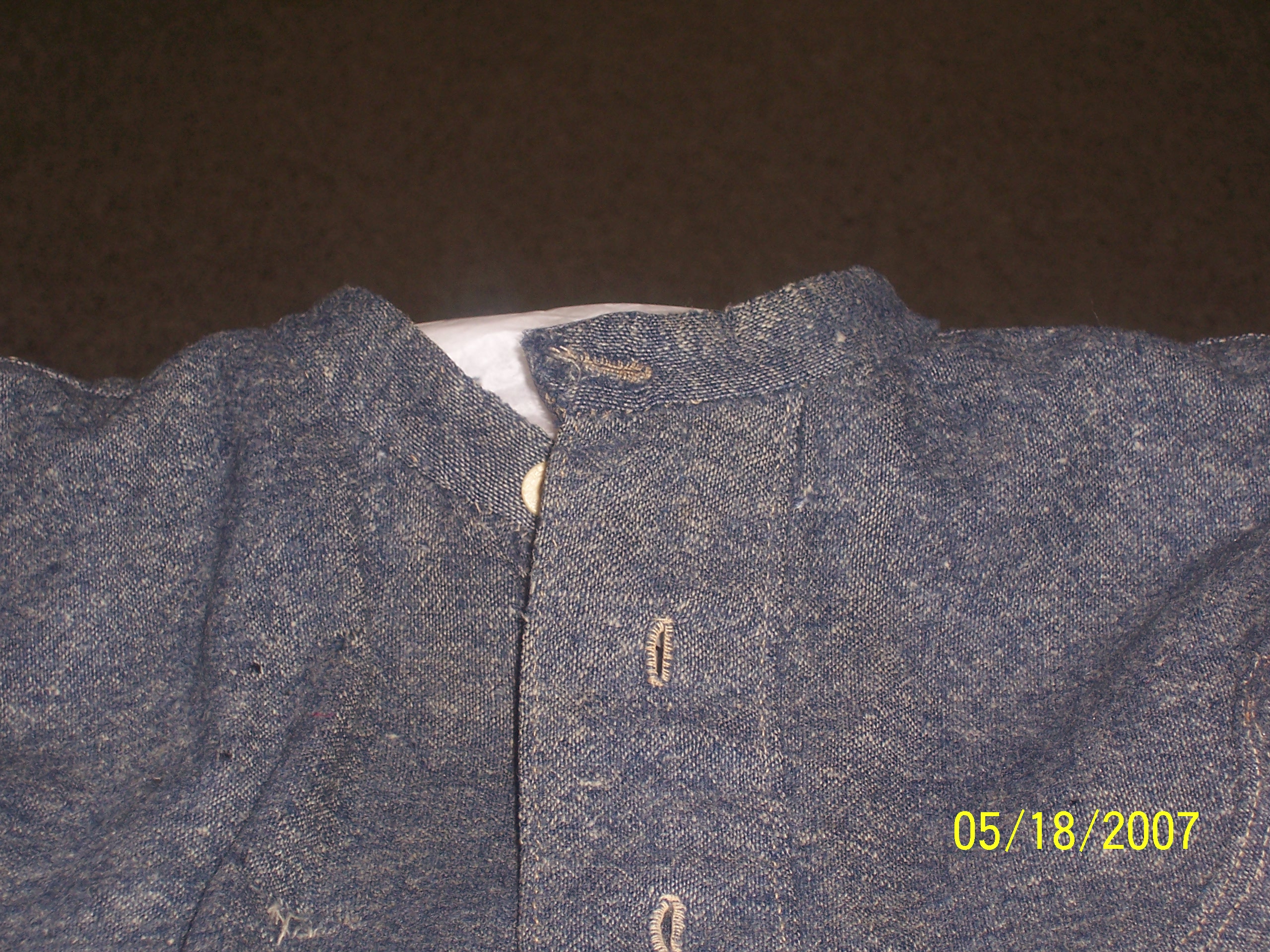

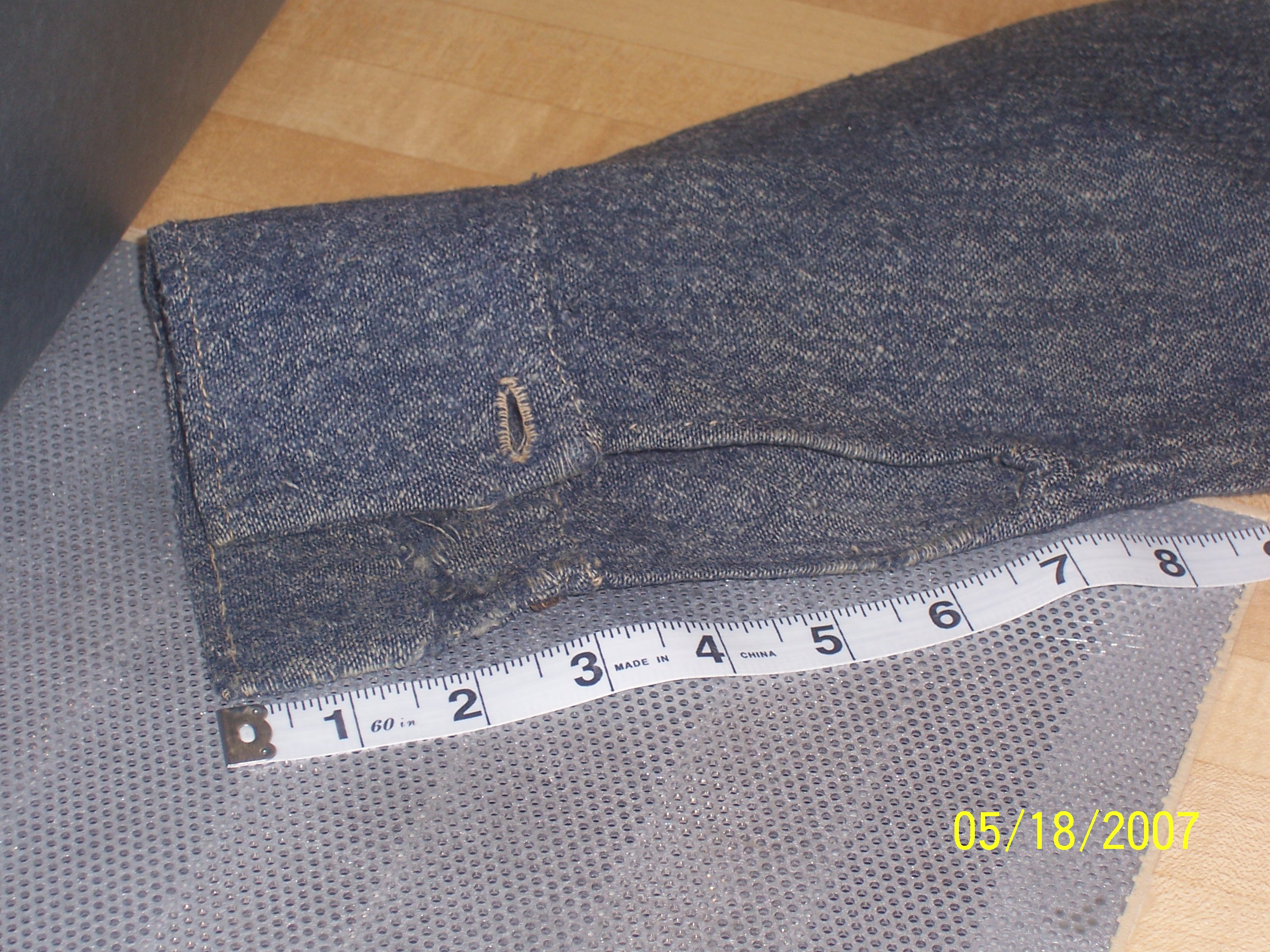

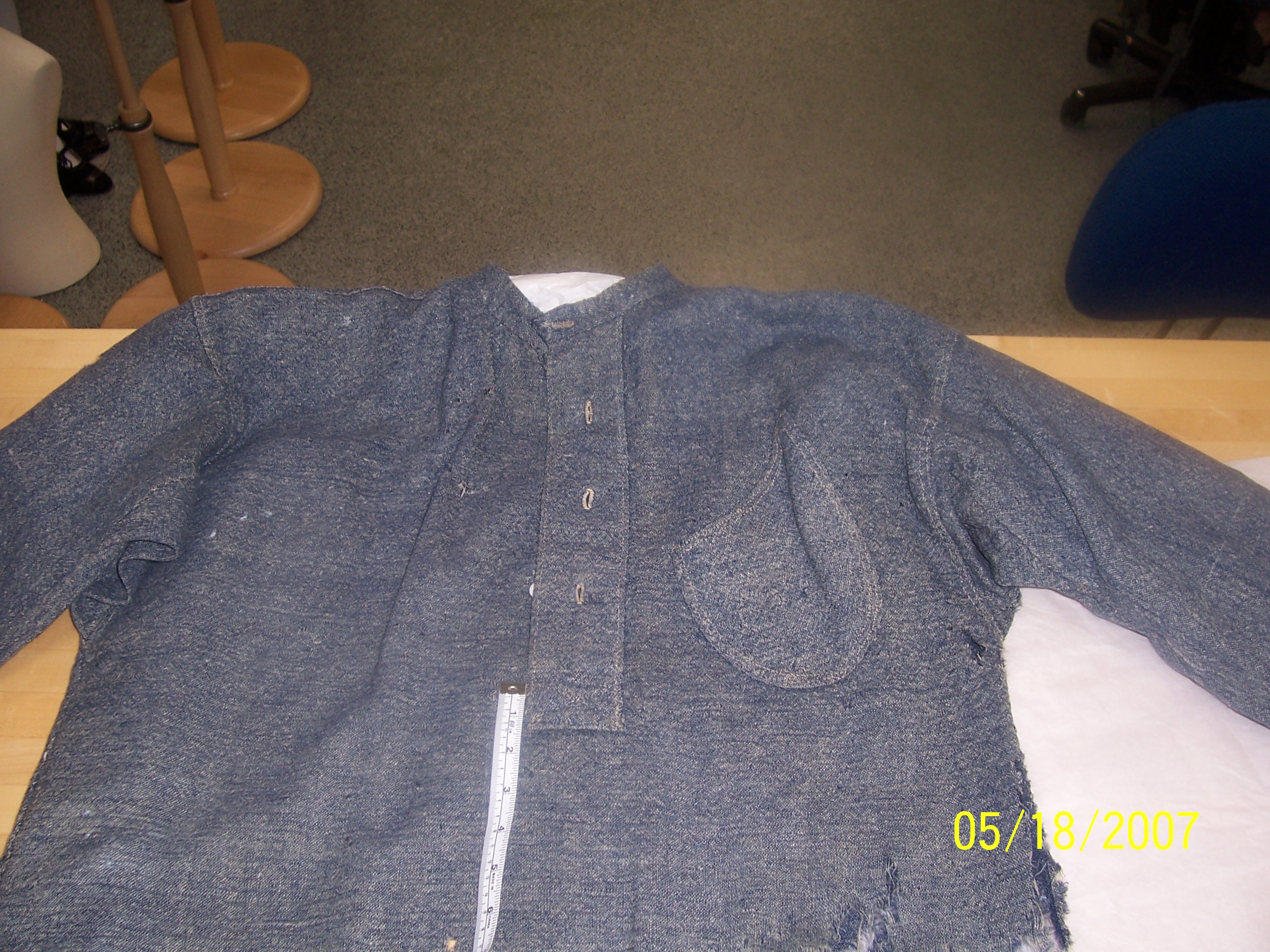

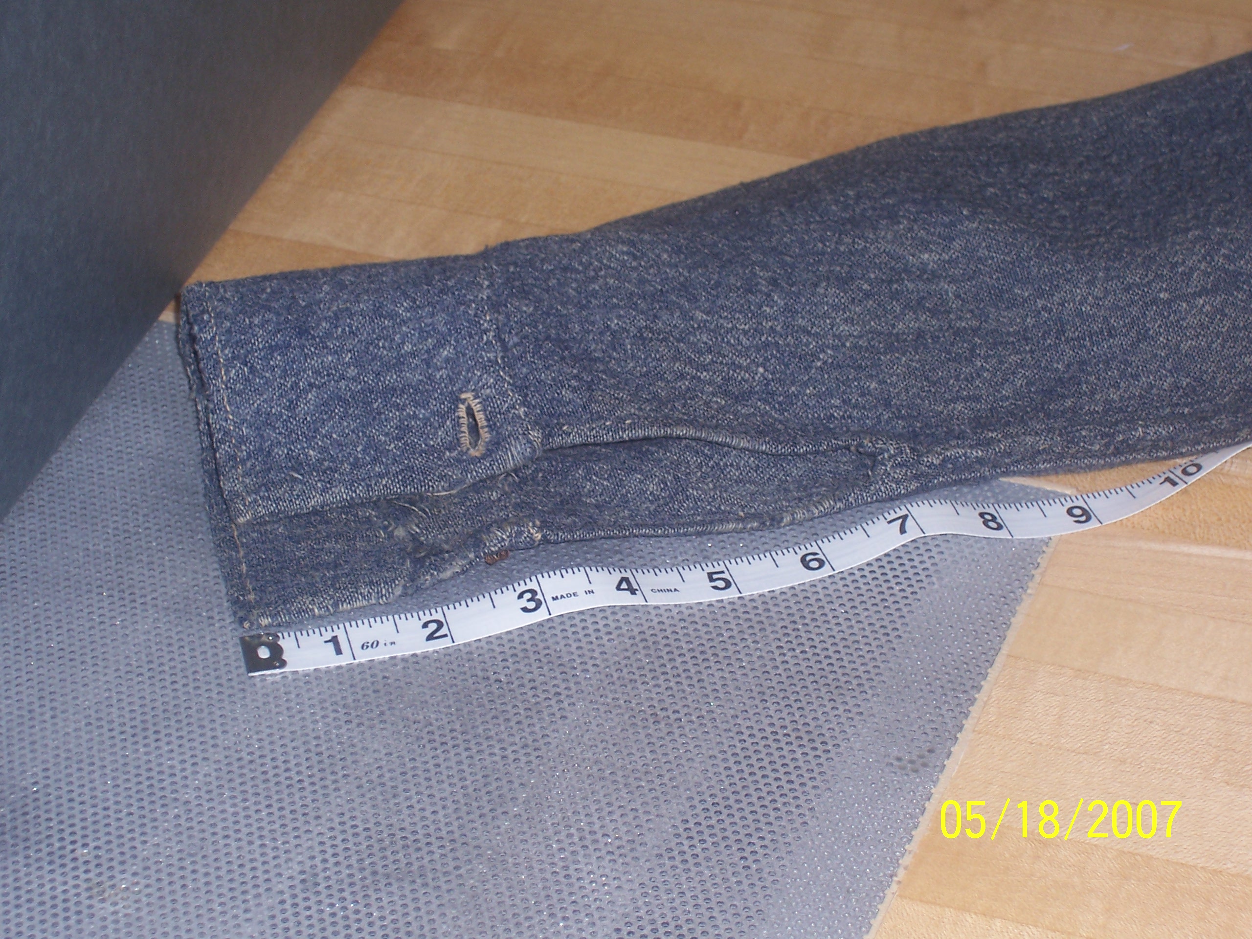

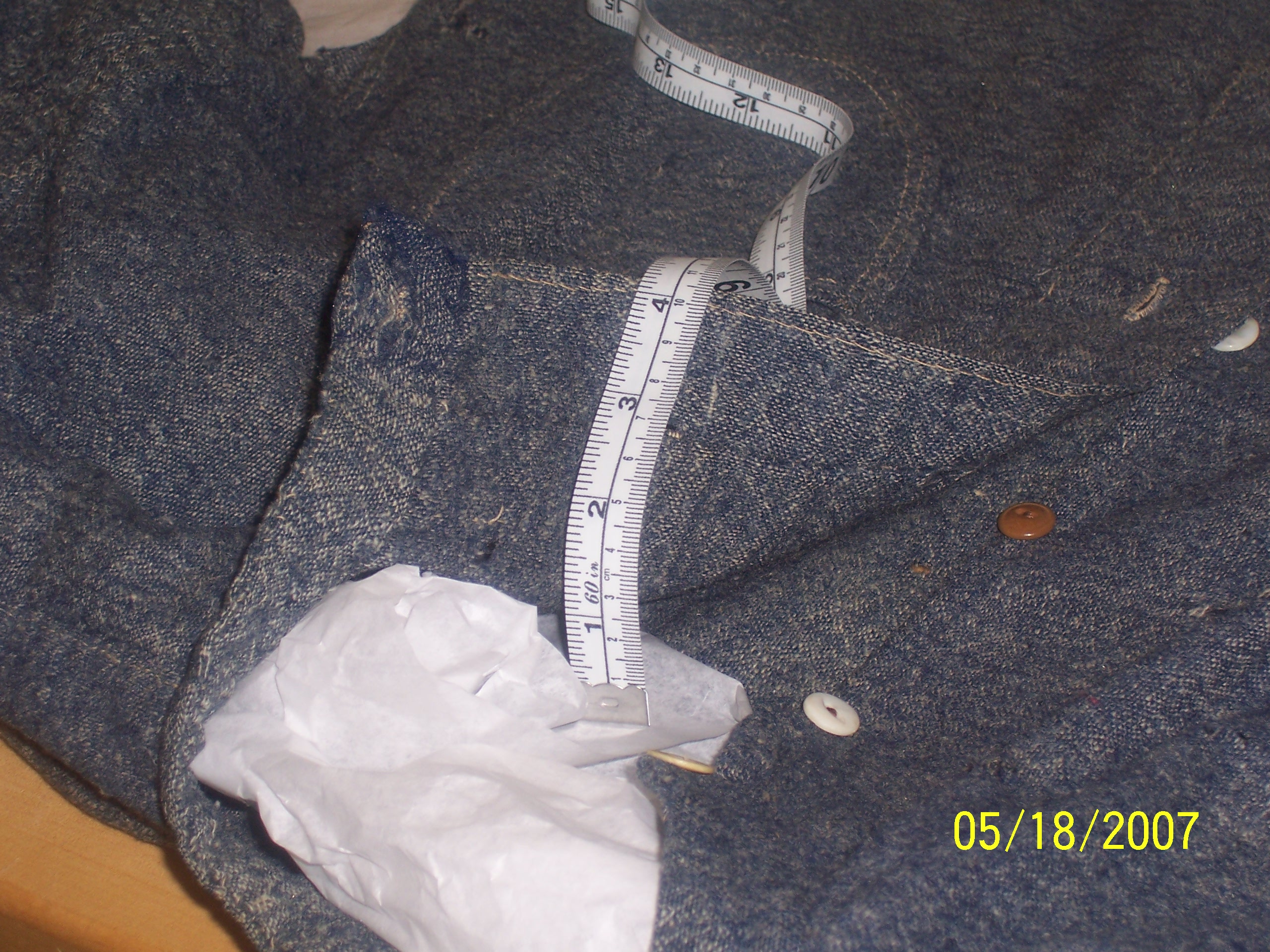

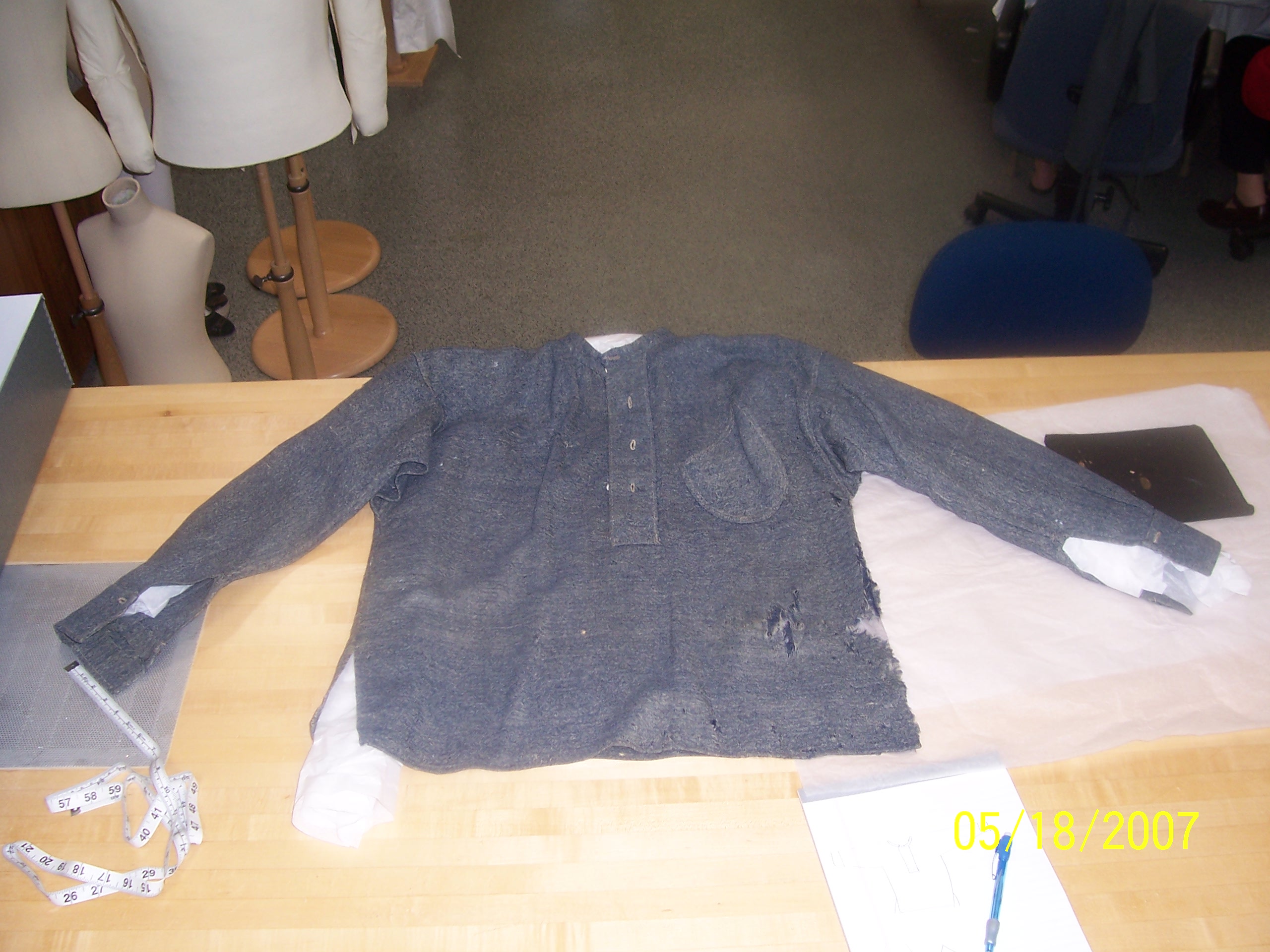

    Here are some photos of the NC MacRae shirt I took last week at the NC Museum of History.

          Oh, I should mention that the photos that make the material look blue more color correct. Most of the pictures were taken with a flash. The last few were taken on a tripod with natural light from a nearby window.

            This is a great shirt. I have made a variation of this shirt several times since the mid-80's after Ray Bass gave me the pattern. Its essentially a bunch of rectangles pieced together.
            I have always loved that "moon" pocket....very cool!

                    Is anyone familiar with the construction technique used to attach the sleeves to the body of the Macrae shirt? I've sewn shirts from kits and am familiar basic techniques (i.e. attaching with a back stitch and felling the seam), but from the images above the sleeves looked as though they were attached using a double line of back stitching or running stitches. Are my eyes deceiving me on this? Similarly, it looks like the pocket is attached to the shirt using a double line of stitches. Any insights into the construction techniques for this particular item would be much appreciated.

                      I'll check my notes to make sure, but if I remember correctly, the sleeves are attached with the right sides of the fabric together as you would do typically. However, the raw edge of the seam allowance is pressed to one side (not turned under) and tacked down with two rows of half backstitches. So three lines of stitching total to attach and fell the sleeve/body seam. The pocket is attached with two rows of half backstitches.

                        Agreed, Craig, and the entire shirt is assembled by hand, if I recall correctly.
                        As an aside, Ben Tart has the correct material for reproducing this shirt. I do not know if he produces a kit or blank for it, however.

                          Thanks Craig, that's very helpful and explains what I was seeing in the photos! For anyone else who is assembling this shirt, I've posted the notes from the NC museum of history below as the link in the original post appears to be on the fritz (apologies for the all caps, that is the result of copying directly from the NC museum):
                          Item # H.1917.42.1
                          "WORN BY JOHN BURGWYN MACREA, 36TH NCT (STARR'S LIGHT BATTERY). 2ND CO. B, 36TH REG., NC TROOPS (2ND REG NC ARTILLERY); BECAME CO. B, 13TH BATTALION NC LIGHT ARTILLERY, NOV. 4, 1863. REPORTEDLY WORN DURING BATTLE OF BENTONVILLE. THIS CLOTH IN THIS SHIRT MAY HAVE BEEN IMPORTED FROM ENGLAND. "
                          " MAY HAVE BEEN WORN WITH SHELL JACKET (1917.42.3) AND TROUSERS (1917.42.2).
                          SHIRT MADE OF BLUE AND UNBLEACHED WOOL FLANNEL, PLAIN WEAVE.
                          SHORT STAND UP COLLAR WITH ONE BUTTON. CENTER FRONT PLACKET IS 2 1/4" WIDE AND EXTENDS 12 ", WITH THREE BUTTONS. FABRIC STRIPS (1 3/8") REINFORCE SHOULDER LINE.
                          LEFT BREAST POCKET, PATCH STYLE WITH ROUNDED BOTTOM AND SET ON AN ANGLE. SHOULDERS ARE DROPPED, AND THE SLEEVES ARE SET IN WITH NO GATHERING.
                          SQUARE UNDERARM GUSSETS.
                          ONE PIECE SLEEVES HAVE SMALL GUSSETS ADDED FOR STRENGTH WHERE THE SEAM ENDS ABOVE THE CUFF. THREE AND 1/4" CUFFS WITH ONE BUTTON EACH (RIGHT BUTTON IS MISSING).
                          SLEEVES PLEATED INTO CUFFS, NOT GATHERED.
                          ALL HAND SEWN, FRENCH SEAM CONSTRUCTION. BUTTONS: ON PLACKET, ONE IS BONE, FOUR HOLE, DISHED CENTER; TWO ARE MOTHER-OF-PEARL, TWO HOLE, ELLIPTICAL DISH IN CENTER; ONE IS BROWN, SLIGHTLY DOMED WITH EDGE, TWO HOLE. ALL ARE 1/2".
                          ON SLEEVE AND BACK OF COLLAR: BROWN, FOUR HOLE, DISHED CENTER, 1/2". THE TOP PLACKET BUTTON (BONE) IS POSSIBLY ORIGINAL TO THE GARMENT. THE OTHERS ARE PROBABLY REPLACEMENTS"
