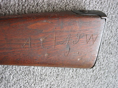

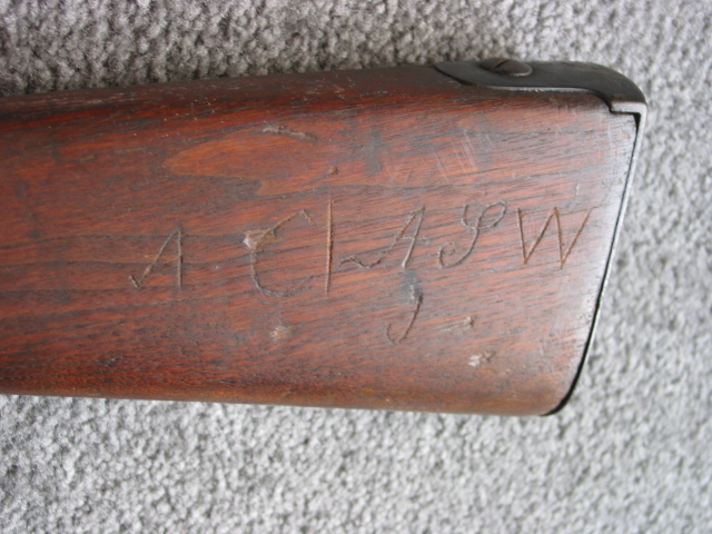

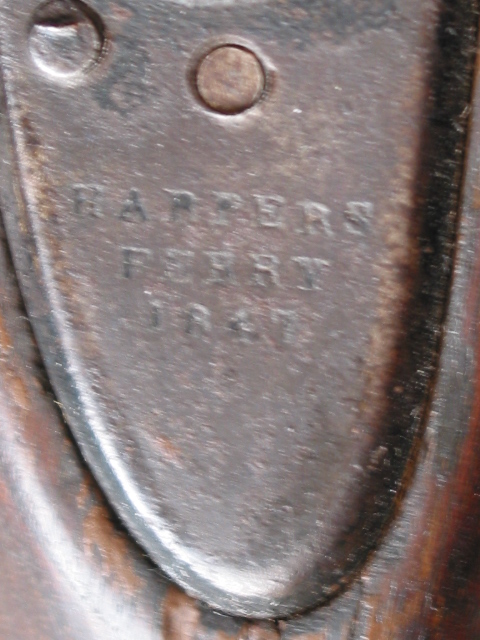

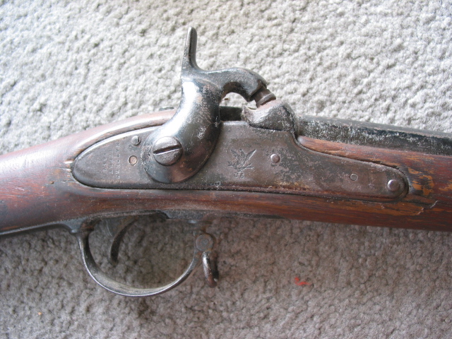

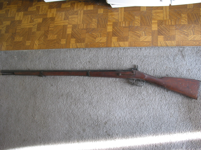

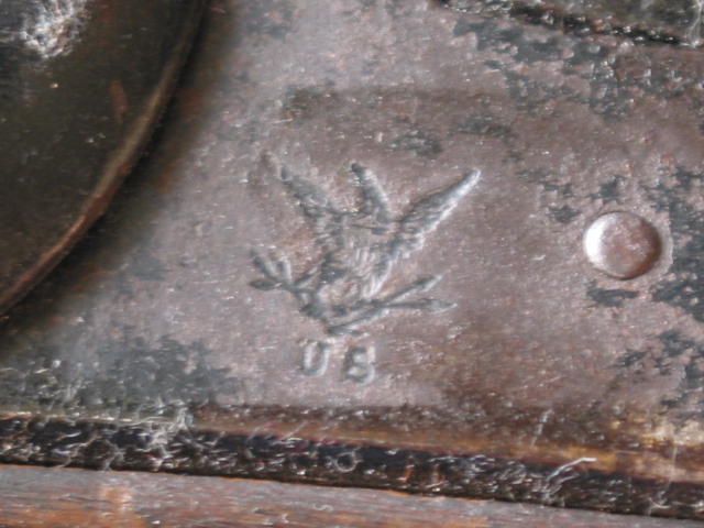

                Below are some photos of my original '42 with an 1847 Harper's Ferry lockplate. At some point in it's life, it was painted black. I'd like to clean it up a bit. Is there a safe way to remove this paint with out compromising the musket?

                  A few more pics. As you can see above, it has been shortened as well.

                    If this piece is all-original, it blows the theory of the tall thumbspur being a "Harpers Ferry Thang". Another theory bites the dust?

                      The black paint can be removed with a solvent such as paint thinner, acetone, or even paint stripper, and a soft rag and/or brush like a tooth brush.
                      Wear rubber gloves as solvents can be toxic, as are their fumes.
                      And.. disassemble the gun first as chemicals have a tendency to bleach and damage wood.

                        I'll add to Curt's caution on gloves:
                        Be aware that gloves you wear may be soluble in some solvents, especially the thin "examination" type gloves. Have a look at your gloves as your work, because they may be disolving slowly as you go.

                            Sorry if I wasn't clear.
                            The piece is considered as a whole. This being the case, in my (limited!) experience, I have noticed that Springfield-made US M1842's appear to have a shorter thumbspur than those made by Harpers Ferry.
                            The piece pictured appears to be a Harpers Ferry example, yet it appears to have the shorter variety of thumbspur. If one assumes that the piece is comprised of parts that have been together since the time of manufacture, then my (and others) theory of the long thumbspur being associated with "The Ferry" has been disproven... at least in part. :wink_smil
                            Does that make more sense?

                                I have seen the tall hammers on US 1842s from both Armories, but they seem to show up more often on the Harpers Ferry marked guns. Hammers are one of the parts that interchanged on that model fairly easily. Hammers wear, crack and then get replaced. Don't get too hung up on the height of the thumbspur and exclusivity of that style hammer to the output one Armory.
