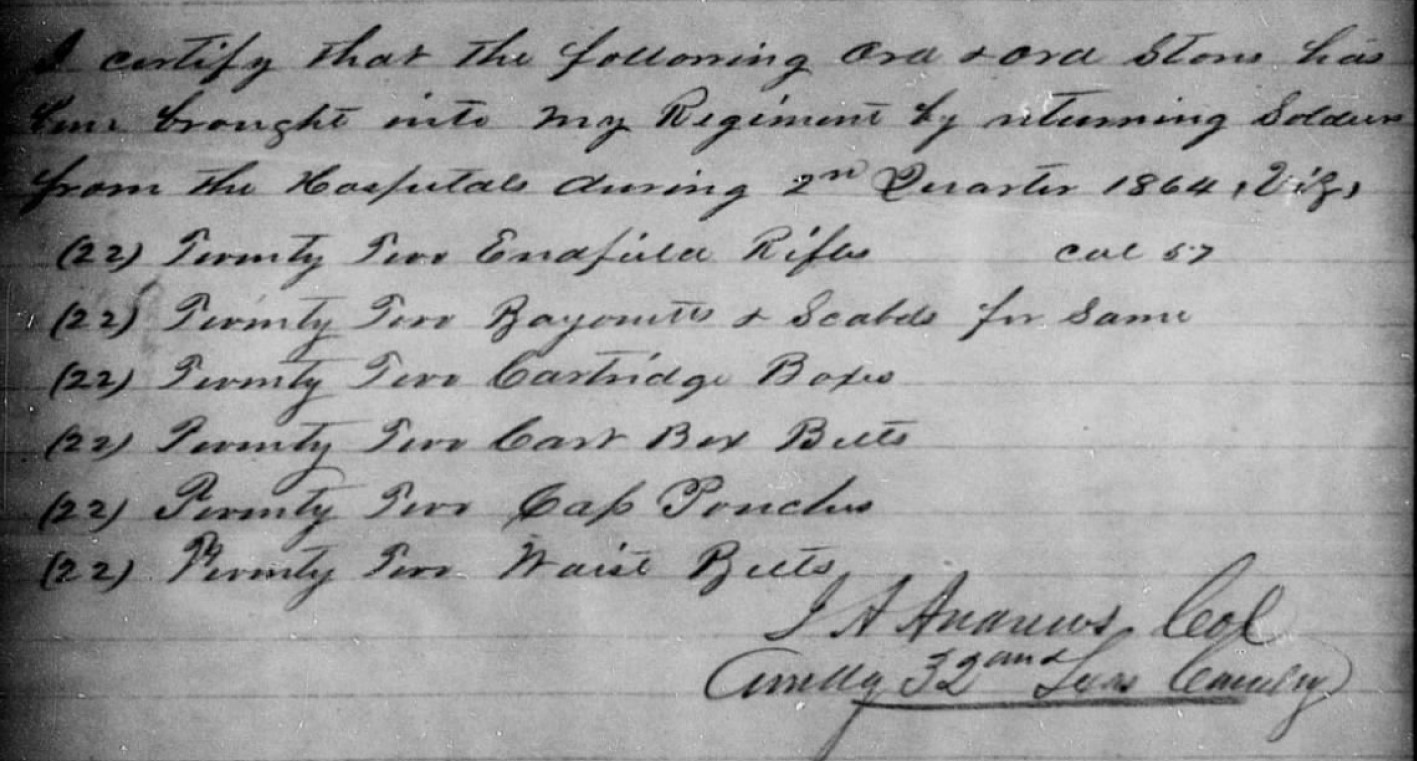

    I knew soldiers were generally issued new clothing leaving hospitals to return to their units. What I was not sure of was whether they were re-armed prior to returning to their field units. Attached is ordnance receipt of the regimental commander for the arms and accouterments for 22 soldiers returning to the 32d Texas Dismounted Cavalry Regiment (Ector's Infantry Brigade) for 3 months during the height of the Atlanta Campaign.

    Roger, Thanks for posting the first hand document. I had always wondered about how soldiers, especially on the CS side, dealt with the hospital. In short and meaning, what did they do with their stuff. I posted a while back because I was curious what a trooper did with his horse. As we know, on the CS side, a trooper was expected to provide his own horse and was reimbursed for the that horse if it was killed or disabled. We also know that, at least in the beginning, the many CS troopers had their own tack and in many cases arms. The question I had, if he is wounded and went to the hospital, what happened to her personal items like his horse, equipment, and possibly arms? How would he ensure that he got them back when her returned to the field? I don't think we ever got a definitive answer like the document you posted. I would imagine it was accountable, but it maybe lost to history on how it was done.

      I have seen records of CS soldiers that were wounded or killed and the government settled the account with the family to include saddles, shotguns, and other personal items (including a great great uncle). If the Company had the records or the soldier or family had the receipt, it was usually settled - at least previous to the end of 1864. Unless a friend shipped the equipment home for them, it is doubtful they saw the same equipment again.

        When a soldier died in camp or was so sick as to be sent to a rear area hospital his arms and equipment were supposed to be taken up by the regiment and then turned over to the brigade ordnance officer, who in turn would send it back up to division, ect. Often if the sick/dead soldier had a good weapon like an Enfield Rifle then that would be kept by the unit and a lesser or damaged weapon sent in it's place. When a man returned to the regiment he usually had to wait a little while before being issued a new weapon.

          I am sure you are correct when it was an issued item. Not to derail the original post, but when I first asked the question in a different thread regarding men in the hospital, I was wondering about his personal items, mainly his horse. I was more interested in what he did when he returned to duty. The first post is interesting because it shows soldiers being issued equipment once leaving the hospital.
