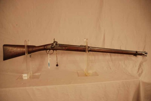

                Check out Gunbroker item #406281757 Enfield two band used by Charles R. Saville of 28th Pa. I am no expert but I think its a naval model. When I ran his name he was in the 28th but several companies were used to form the 147th Pa. With them he served through the entire war. As to the photo at start of thread...the 28th originally had gray uniforms. Regimental history says they received short enfields and saber bayonets from a source in Philadelphia.

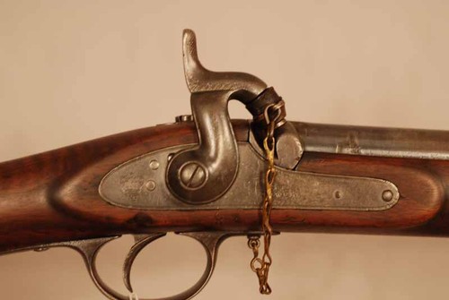

                  Looks to me like the nose cap is iron while the trigger guard appears to be brass as well as the butt plate. Mixture of parts when built?

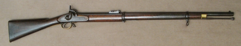

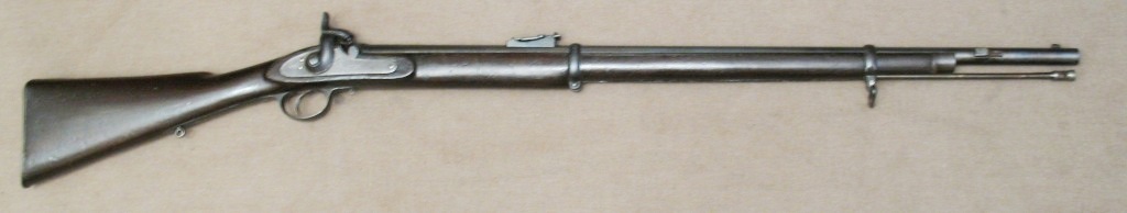

                        P-56 Navy brass mounted with broken off bayonet lug and a P-56 Army with steel hardware. There seem to be more of the P-56 and 58 brass hardware guns showing up than the iron mounted rifles. This brass mounted short rifle has the thin walled barrel and the sling swivel mounted on the trigger guard. It also has the Sinclair Hamilton inspection mark. I have found that when dealing with Enfields all the pattern characteristics for the pattern year do not always match up. It gives me a head ache trying to remember all the different guns.
                        The P-58 bar on band Enfields with CW history are very scarce. I did find the front band from one near Hatchers Run and I have been looking for one with the front band missing for a long time.;)

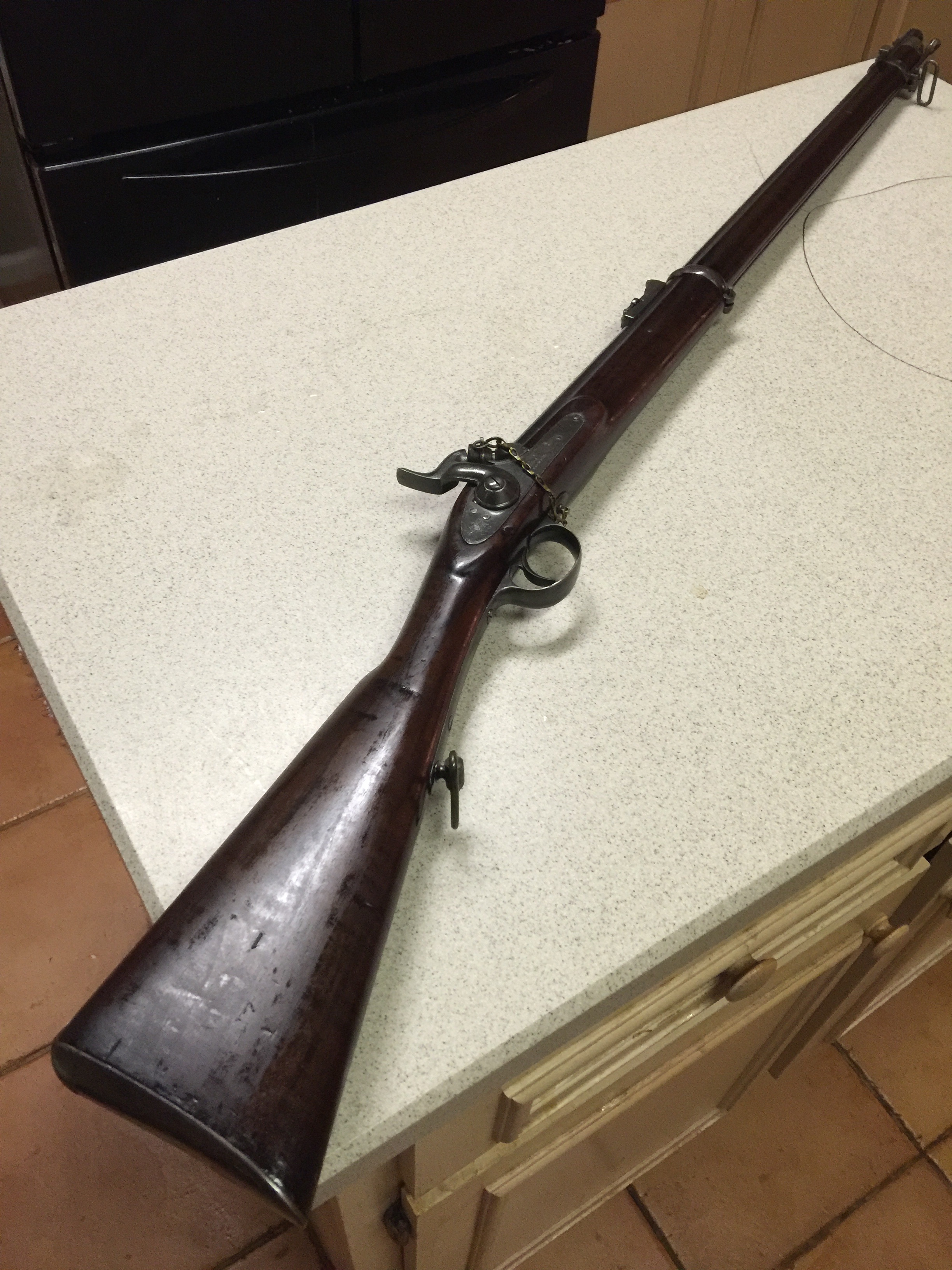

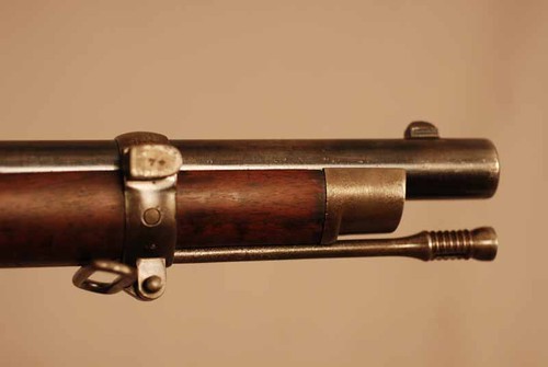

                            Here is a recent addition to my collection, a Pattern 1856, Model 2, "Bar on Band." While I have the sword bayonet for the other Army models, I am still looking for a reasonably priced one for this model. They have a 1/8' to 1/4" space between the muzzle loop and the top of the bayonet blade, as opposed to the nearly flush loop bottom on the muzzle ring of other standard models. Note that it sports the 1,100 yard rear sight increments of the other two band Enfields.

                              Is your's a .61 caliber? Unfortunately, many will require that final finish to making it fit correctly. My brother almost had one that work was actually the Pattern 58 Naval rifle. Shoot Tim Prince an email as he runs into them more than anyone else I know.
