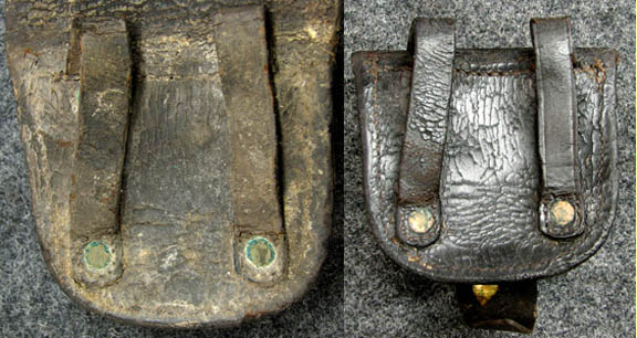

This original Federal cap pouch was stored in a very dry climate. The age hardening is quite severe. However, a careful cleaning and light oiling will bring alot of life back the cap pouch as can be seen in the second picture of the same artifact.

The reason for routine cleaning is to prevent a condition known as “Age Hardening”. “This phenomenon is observed mainly with thicker leathers found in military, carriage, and rural industries collections. It manifests itself by a darkening in the colour and a loss of flexibility. In severe cases, the surface structure is damaged and cracks appear”. When the humidity is high, the leather absorbs moisture which partially dissolves water soluble materials present between the fibers. As the humidity reduces, moisture within the structure of the leather moves towards the outer surface, taking non-tans and other material with it. These are then deposited in the grain and flesh layers as the moisture evaporates. Over a period of time, months or years, there is a gradual build up of material in the surfaces layer. This physically restricts movement of the fibres, particularly in the grain surface.”(7)

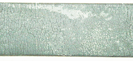

Age hardening: This picture shows the severe cracking effects over time of the age hardening process. This is an original belt but if proper care and cleaning had been taken the cracking may have been prevented
Age hardening as well as the wetting and drying effects from exposure to weather will attack thinner leather (accoutrements) too and eventually cause the grain surface to harden, crack and curl. Doing the recommended cleaning above will remove this build up of excess non-tans. Of course, a little oil will be removed at the same time and that is the reason for the crucial but judicious use of proper leather oils.

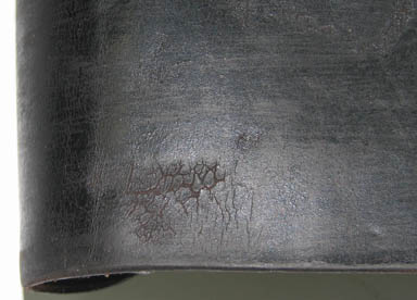

The cracking on the grain of this cartridge box is caused by too much oil. The amount of oil introduced to this artifact is quite excessive and has caused the fibres to expand beyond what the grain surface can handle. Other ways over oiling can show up is when the grain actually tears itself loose from the fibre structure underneath it.

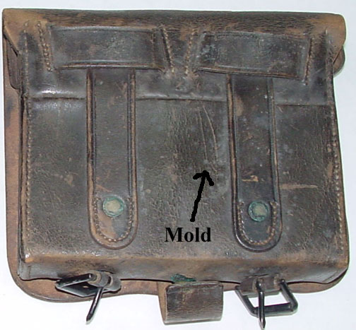

Mold (fungi) is another problem encountered with leather especially when in storage. “Tanners are only too aware, all skin based products are susceptible to attack by moulds. “Leathers may be destroyed if excessive mould growth is allowed to take place.” “The large majority of fungi are only viable if there is enough moisture to support growth. It has been shown that is the relative humidity of the atmosphere surrounding the object is less than 65%, growth does not occur.” (14) There is always a fight with humidity especially for those that live in the South, but it is a fight that must be fought. The problem is a little mold in one spot will soon spread to all of your leather and eventually decay its surface. It will also return again without some preventative measures. However, the cure is easy. First, light is mold’s enemy so exposure to sunlight will dry it out but to really get rid of mold a cleaning with white vinegar is a thorough solution. Simply wipe the leather. The PH of vinegar will not hurt vegetable tanned leather since it’s PH is about the same. There are also products on the market that help to prevent mold by natural additives that inhibit the growth in even the dampest of climates. With just a little care you can keep your leather from being green and fuzzy and possibly save it from destruction.

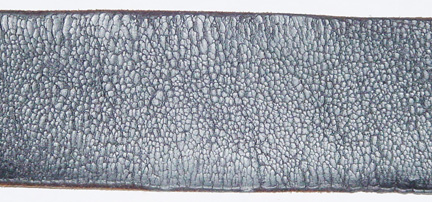

This box has mold on the leather. Mold is green, circular and spiders out. A little white vinegar will remove the mold.
This is not mold but rather a heavy fat such as tallow that has returned to the surface. Called "spewing" this is caused by the over use of oils especially those containing mineral oil. English leather of the period and today were known for spewing. There is nothing wrong with the leather it is just the way English leather curriers do their work. Spew can be removed by simply wiping or buffing the fat away.

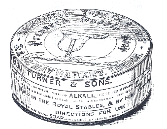

English Crown soap by the jar and “Castile” soap by the bar. Both were popular Civil War period commercial soaps.

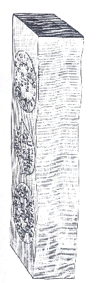

PHOTOS: (Note: all drawings courtesy original catalogs of : Moseman’s 1890's Illustrated Catalog of Horse Furnishings, D Mason and Sons 1880's catalog, Perkins Campbell & Co. catalog of 1888.
