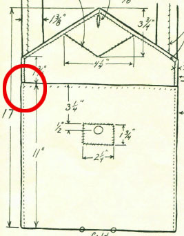

            Also, in regards to the construction of the Moses Alexander haversack, does anyone have an image of the part where the flap meets the main bag side seam? I am trying to figure out how the felled edge of the flap joins the main bag side stitch as I would think the felled flap edge woud need more cloth than the main bag side seam as shown in the Confederate Sketchbook. Don't want to mess up a detail if I can avoid it when making this bag.

                Bump! I am still trying to find interior seam details for the area of the Moses Alexander haversack show circled in red (see image). Any help in getting this info would be greatly appreciated. Thanks in advance! Click image for larger version
