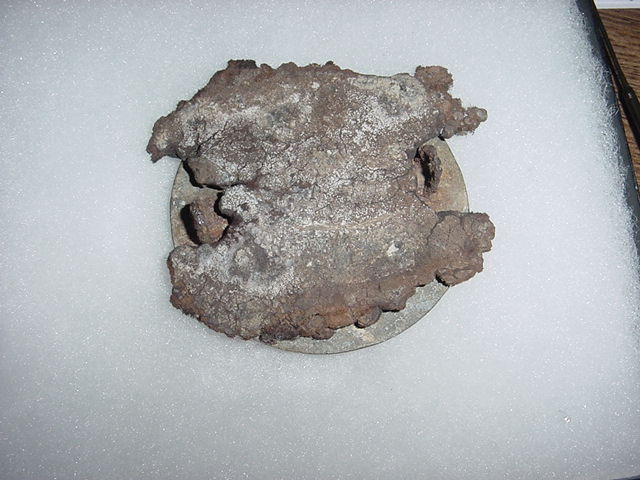

To Paul's point on the bent hooks, attached is the rear of a Federal plate found by me in 1963 at Cold Harbor from a position occupied by the 8th New York Heavy Artillery. Of course, that might be why it fell off!Bob Williams
26th North Carolina Troops

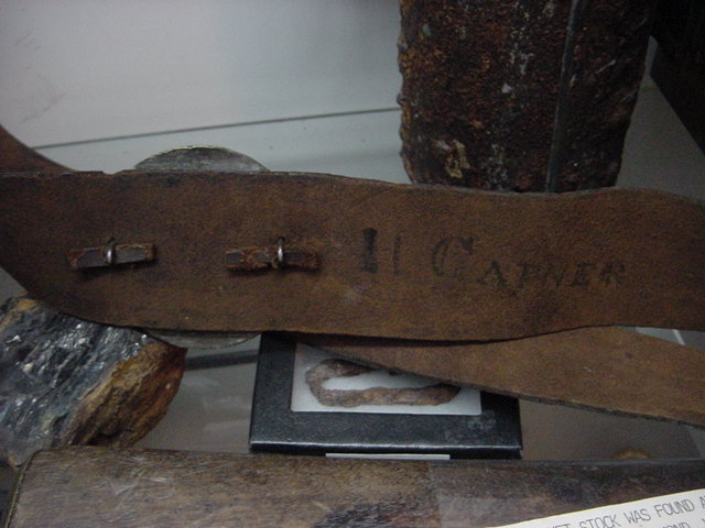

Most of my dug plates don't have any loops left but here are two that do.
One is dug with a good portion of the leather left and the loops are straight. No doubting how this one was secured.
The other is on a rig that belonged to Hugh Capner of the 23rd NJ. It is secured with leather.
Most I have seen have leather through the loops although I have seen many with the loops bent over.
