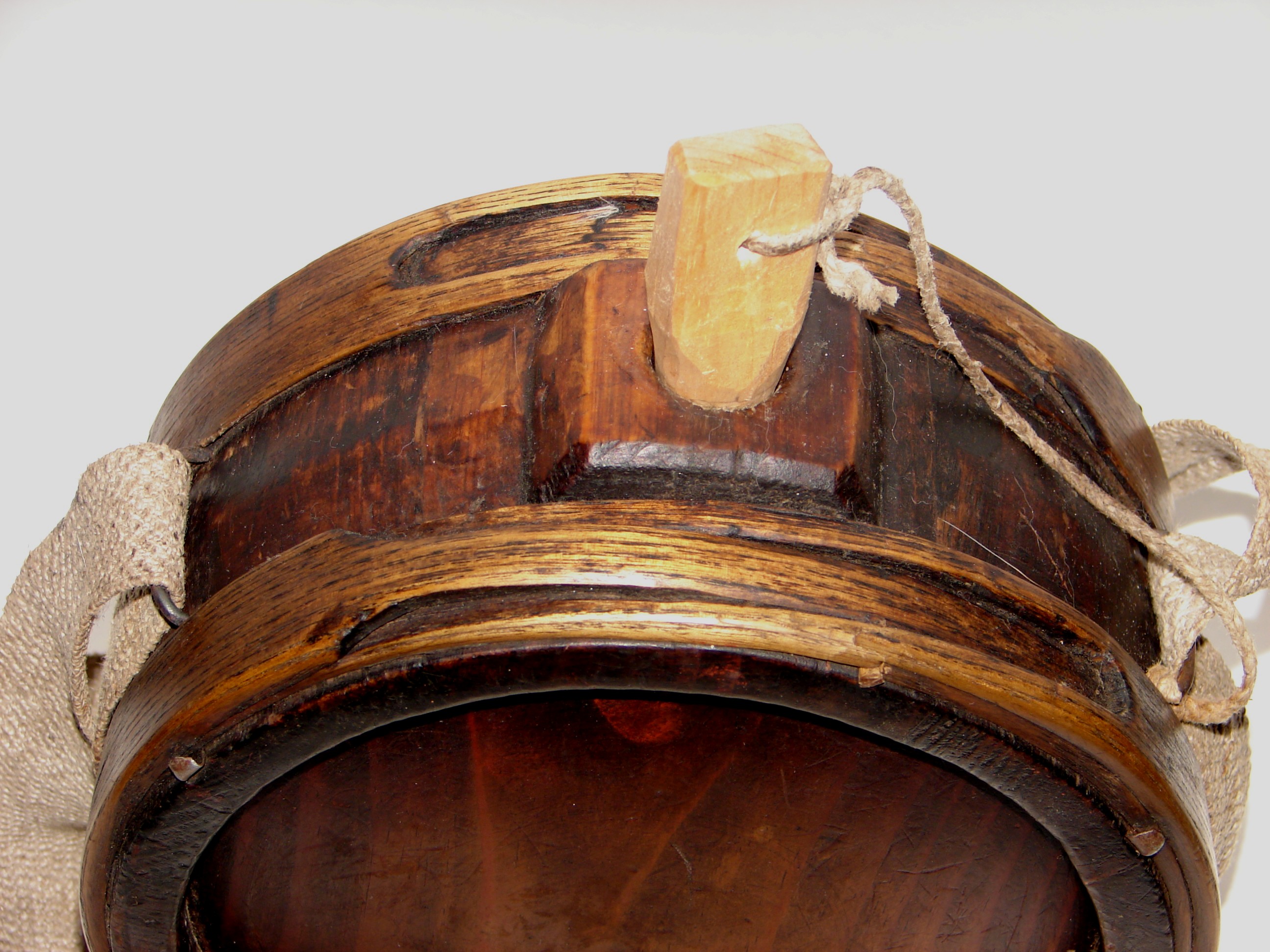

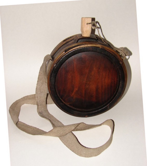

      This 18th century kag was made in advance of the Bicentennial. It hasn't been dry since.

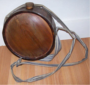

                  Hey did we get canteens made from the same feller? Mine is cracked on one side, has been for 2+ years, and it's STILL holding water! You can see the crack running along with wood grain all the way across the side.
                  I bought a wood canteen from Joe Walker, used it for a while, let it dry out because I was worried it would rot. Well, the bands got loose, and I had the bright idea for tighnening the bands. It swelled up when soaked in water, looked great for a time, but it KEPT swelling, and then came out badly egg shaped!:cry_smile
                  The one that I have pictured I bought also from Joe Walker, (way back in 2000) and it's still going, inspite of the crack.
