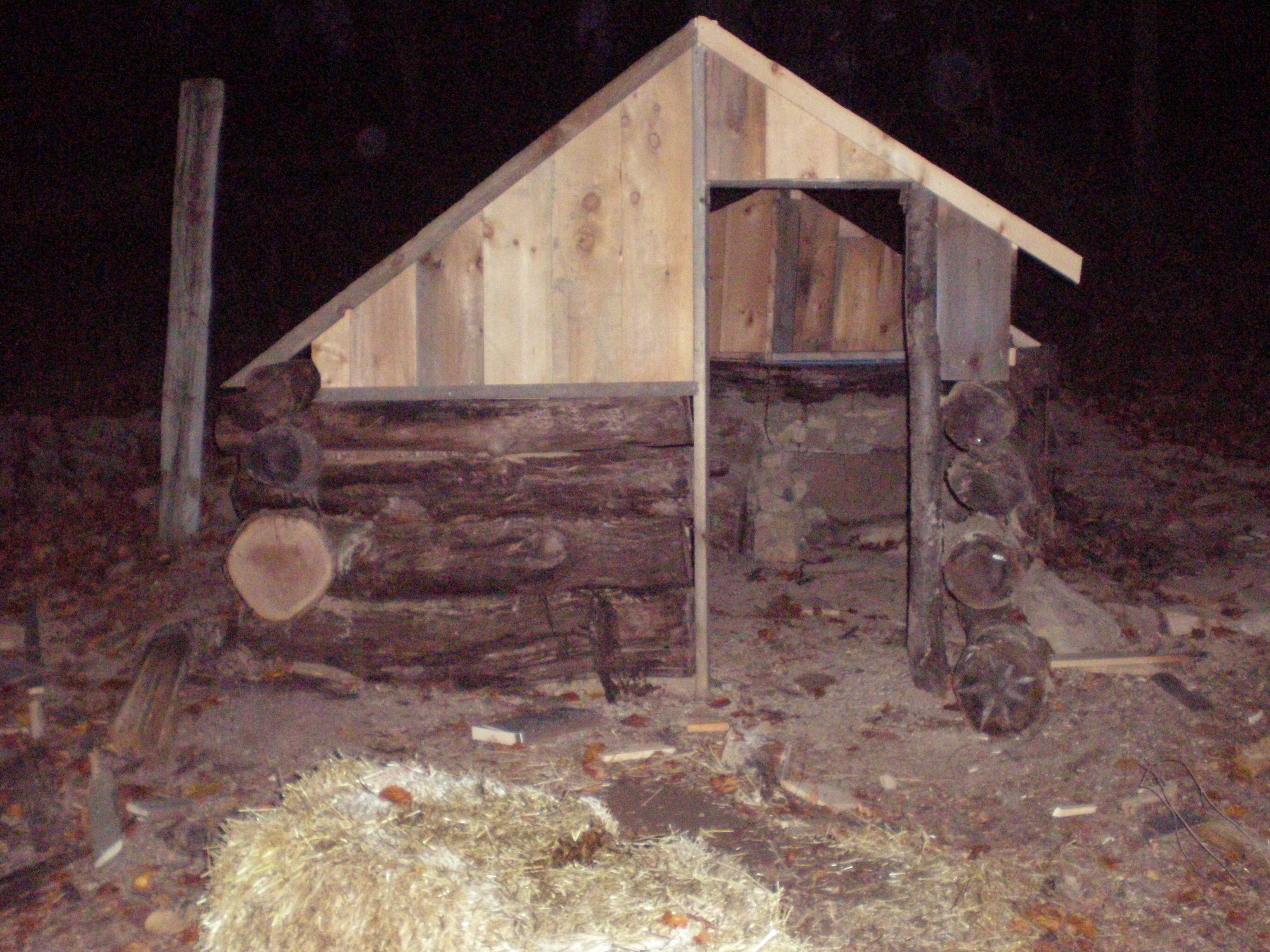

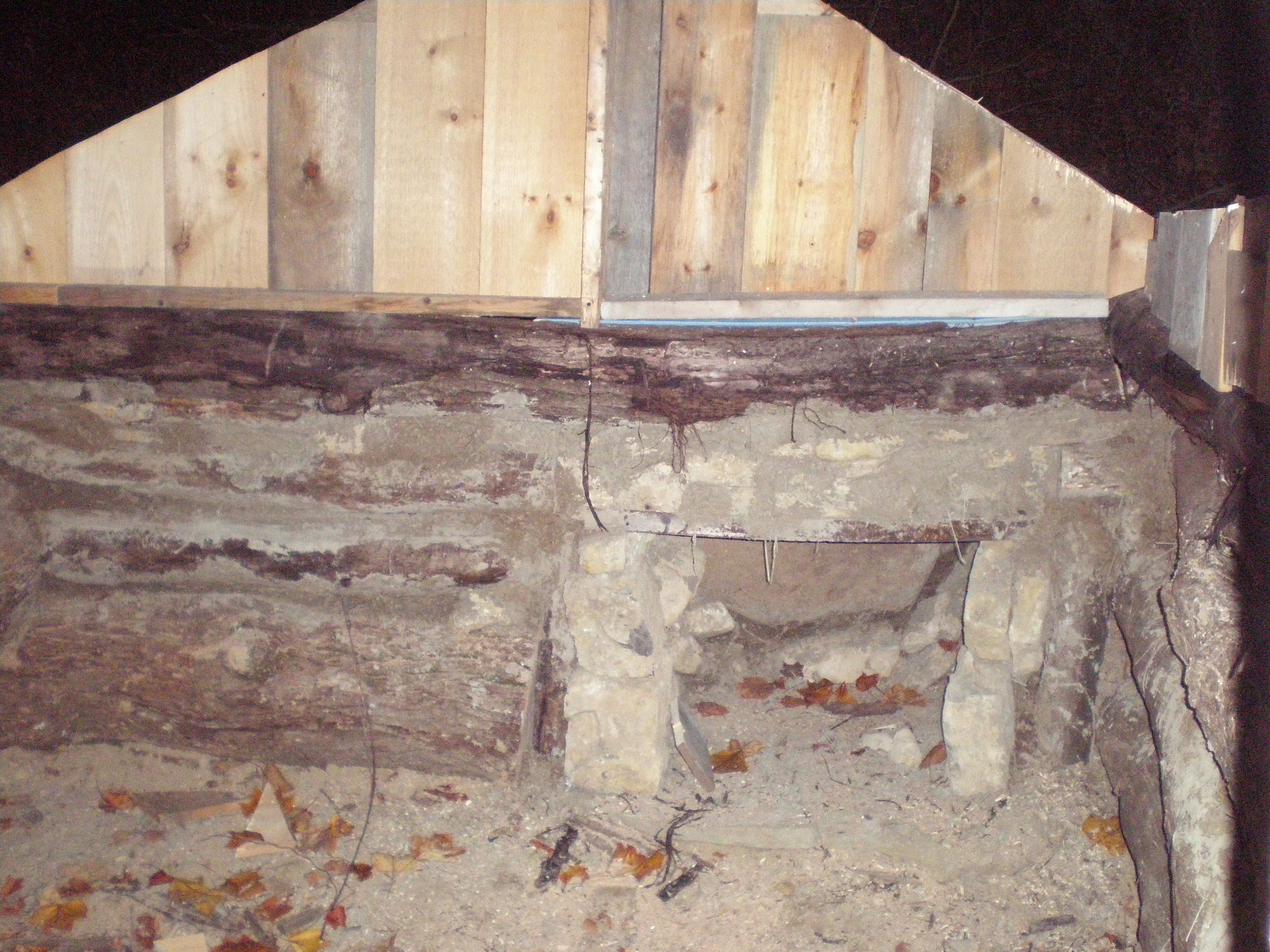

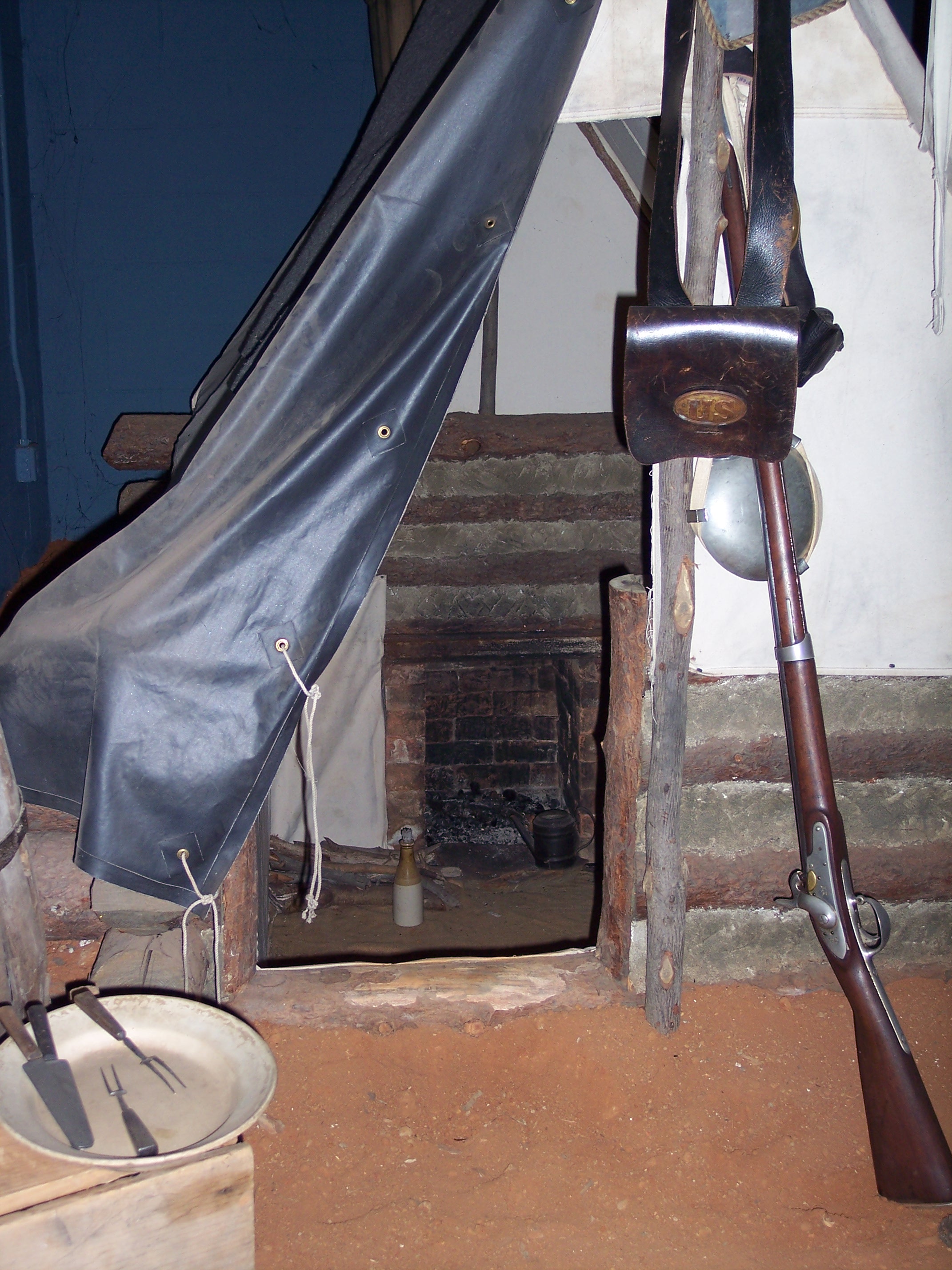

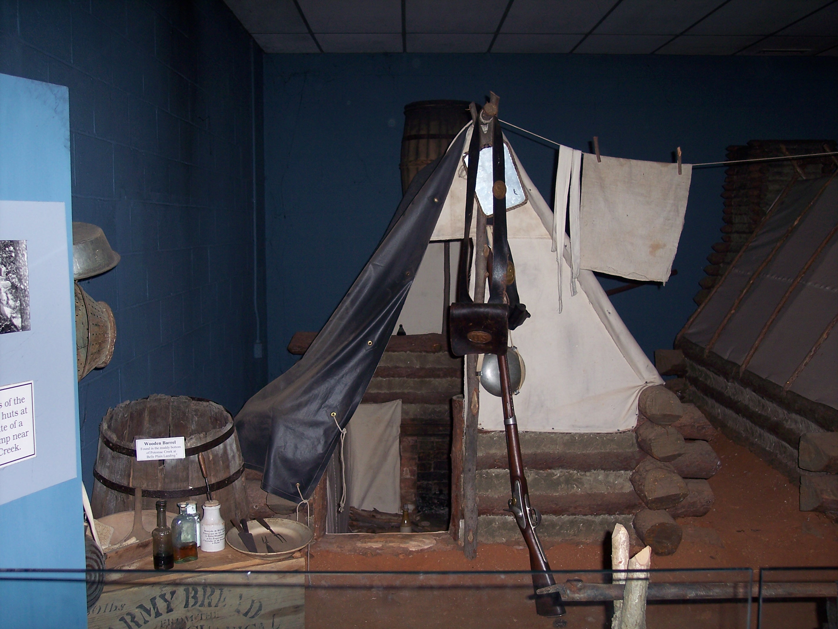

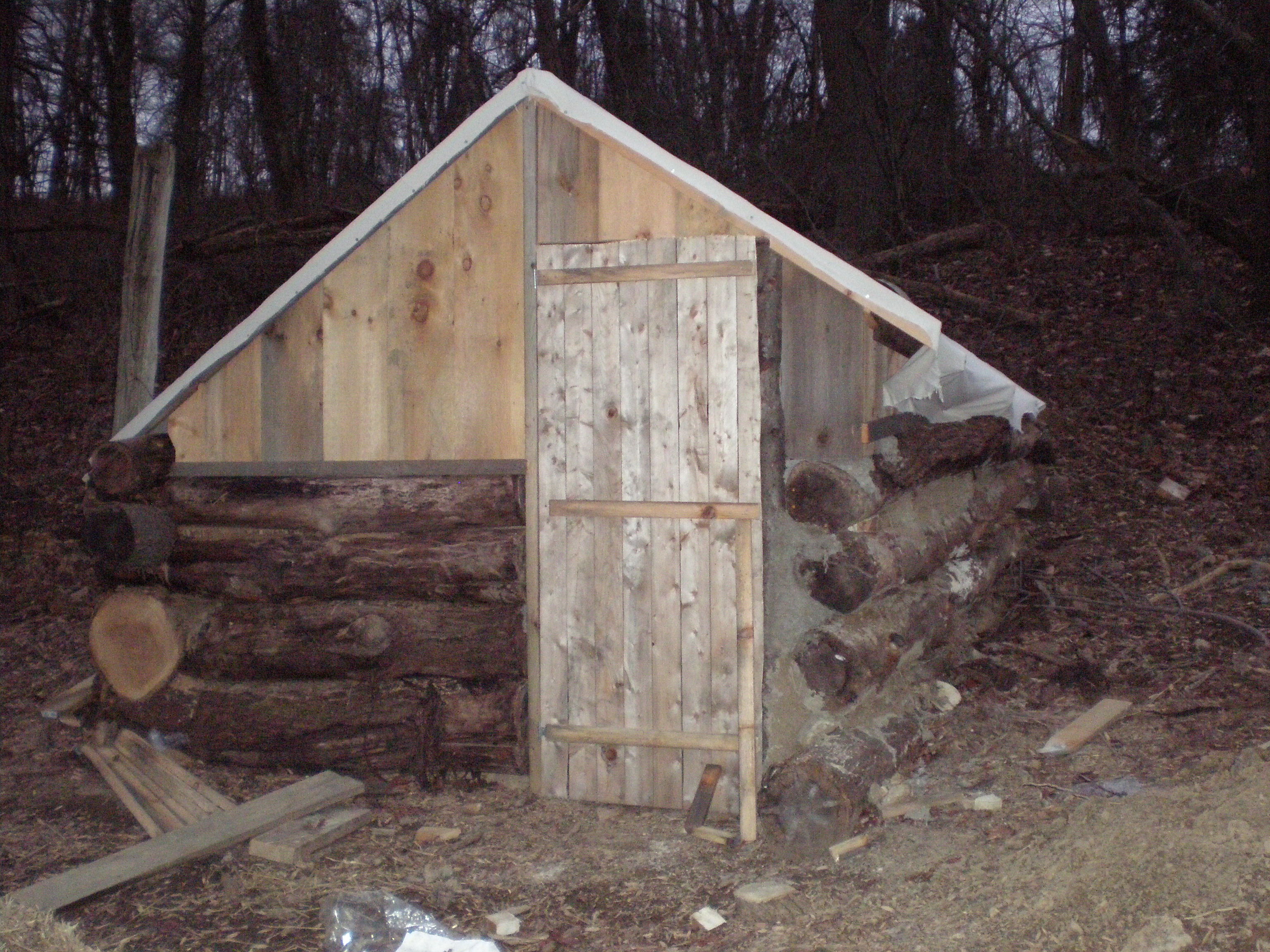

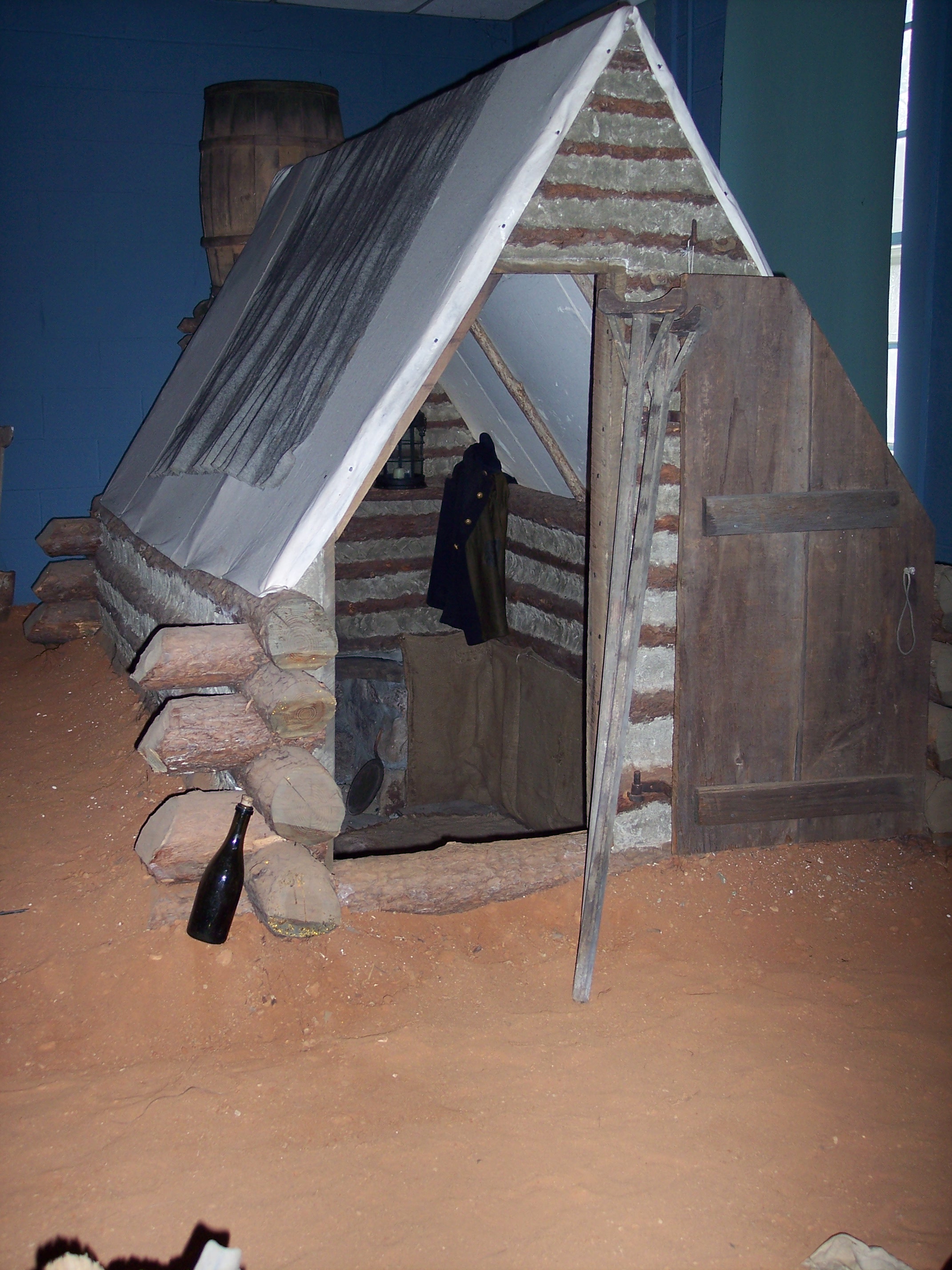

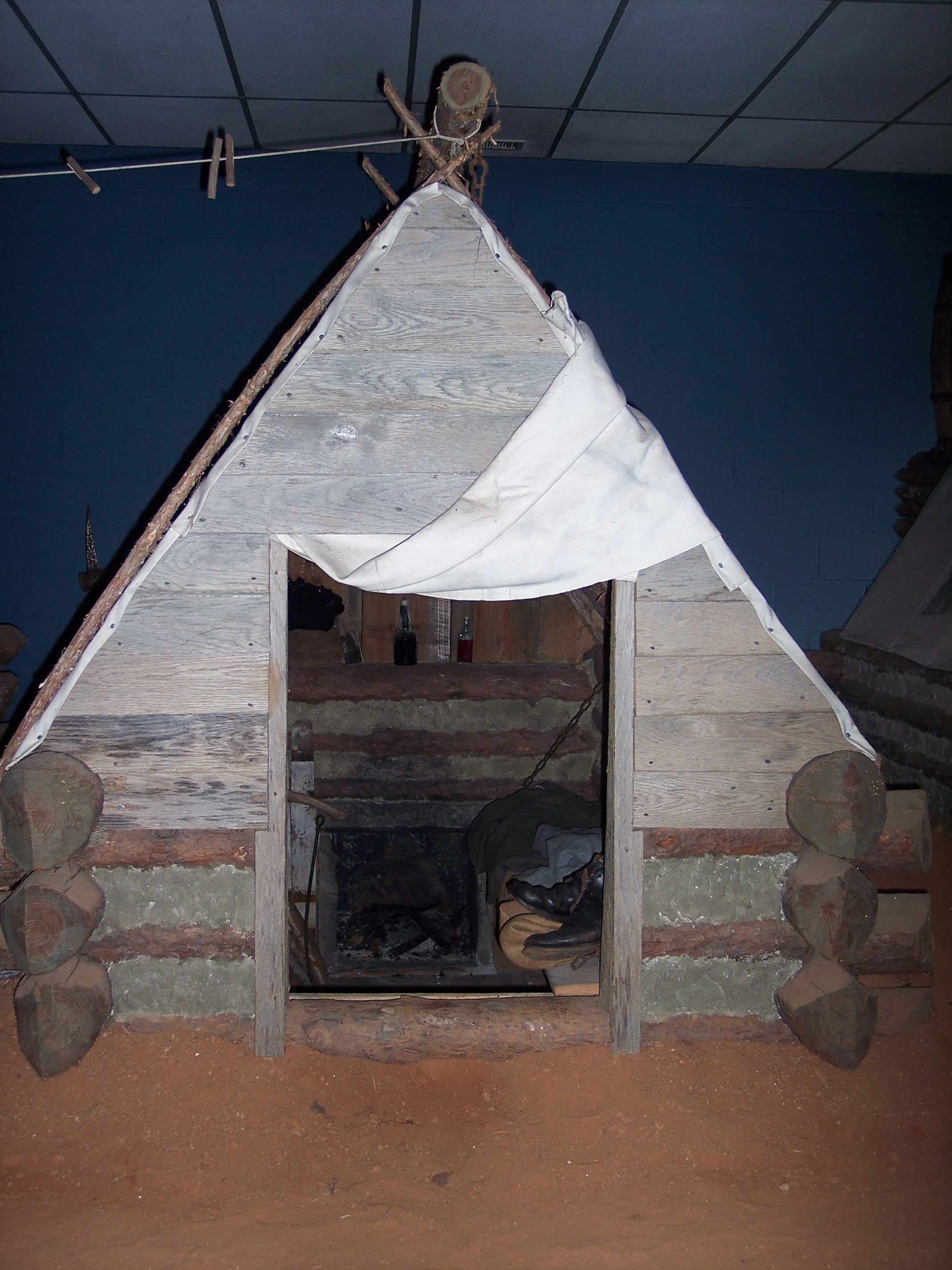

    Anyone have pictures of recreated winter quarters they have built? A few pards and I are in the process of building a few for a scenerio on my farm. The prior threads have discussions but not alot of designs or pix. The examples at White Oak Museum are great both inside and out, anyone have better pic of the indoor examples. I believe they are partially underground?
    Our first attempt was without levels, squares or measuring implements only a rope for measuring and crude tools. The mortor/chinking concoction was a test and building a fireplace that actually drawed right another. We did use some rough cut boards for end gables.

          Shawn, you can also checkout Morven Park in VA. This is where the 17th Miss camped in the winter of 61-62. They have recreated 3 huts that the 17th Miss built there from period accounts, diary entries etc... Also have a look on there site at the pic of one of them

                    Check out White Oak Museums web site. They have several huts built both inside & out. Here is the link:
                    http://www.whiteoakmuseum.com/

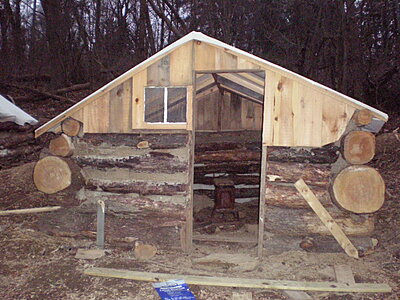

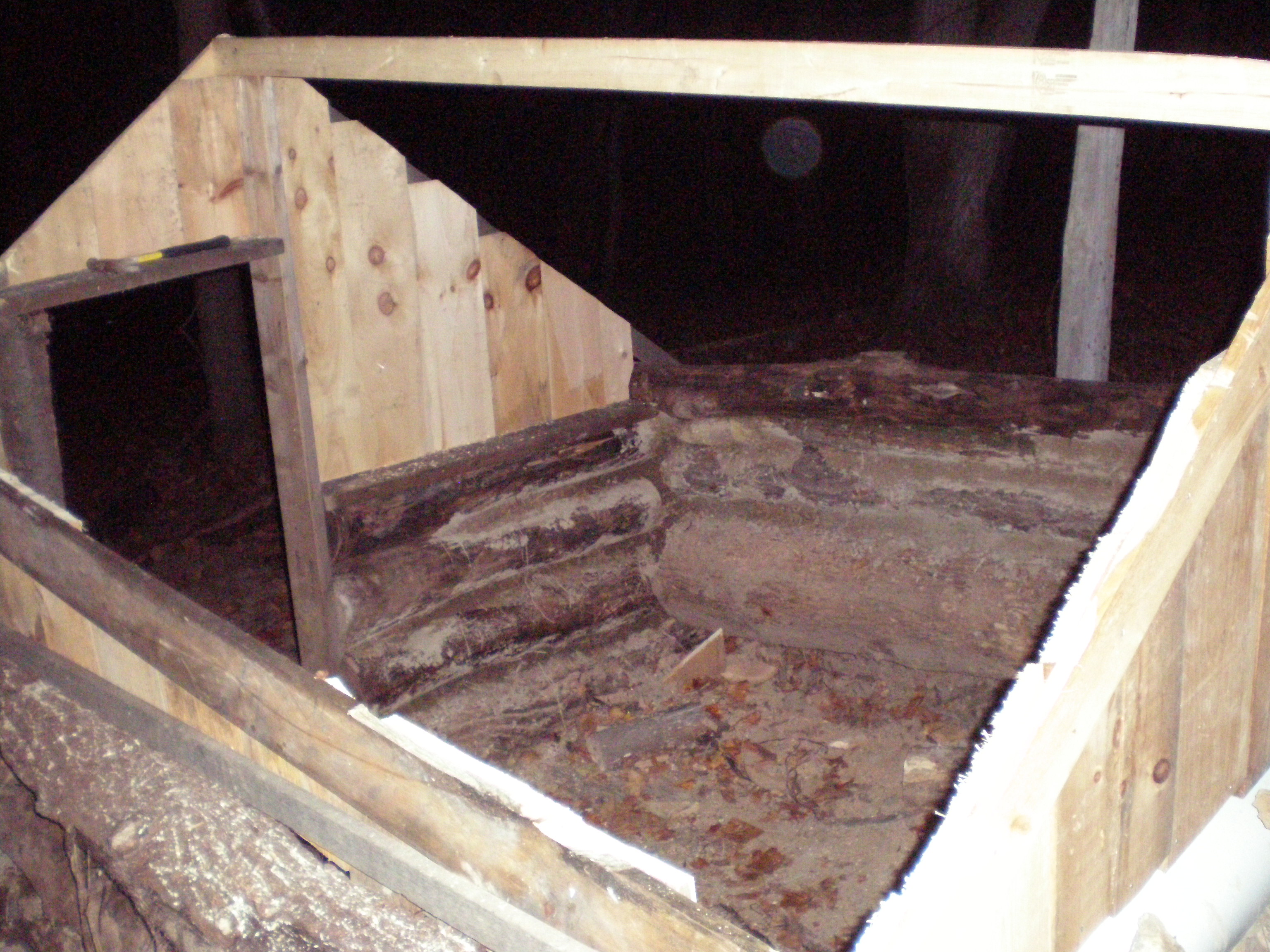

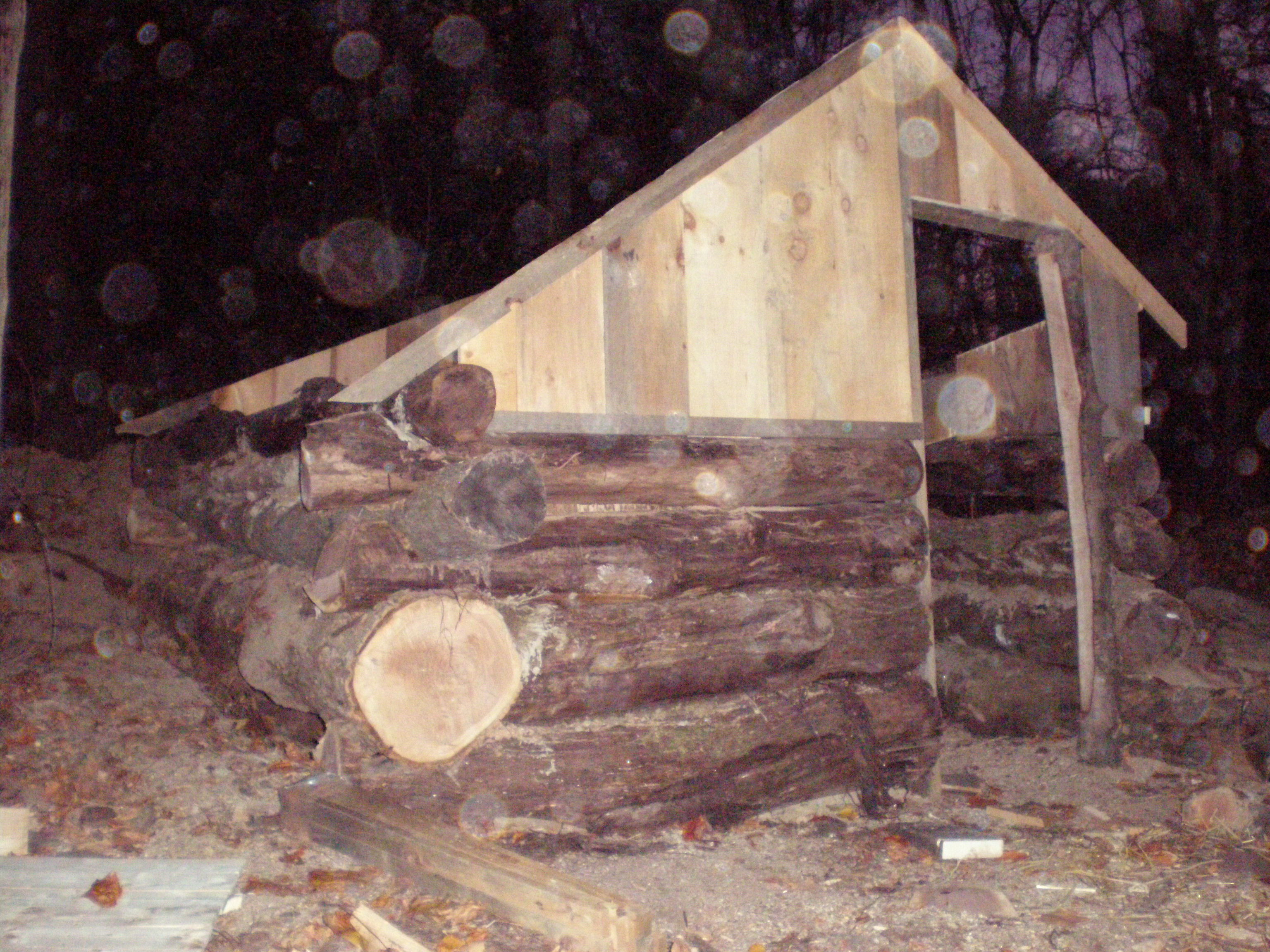

                      so far
                      Her is the first one pretty crude but will work
                        Re: Pix/ideas Winter Quarters
                        That's really neat! Are you using some kind of period building plans?

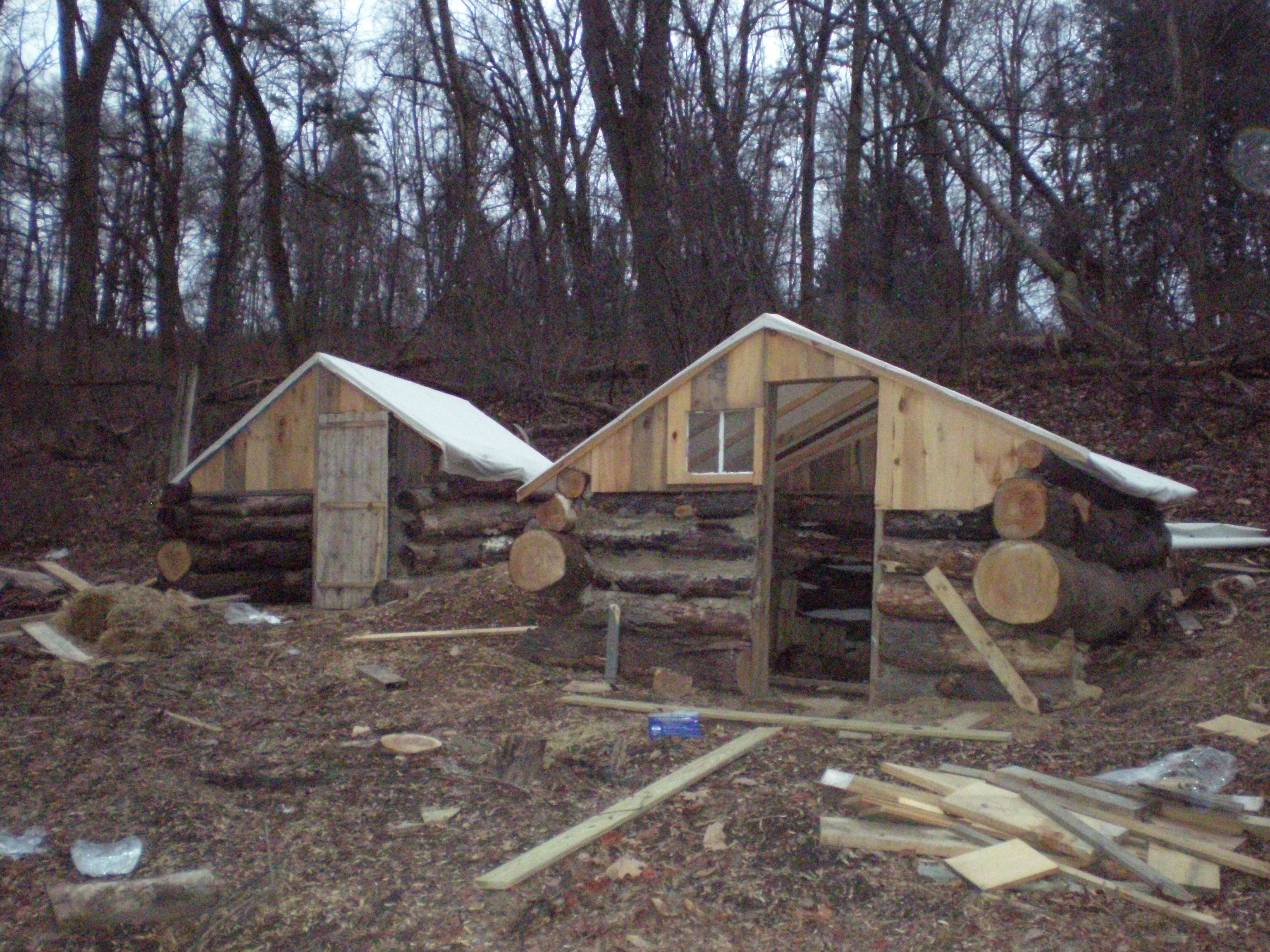

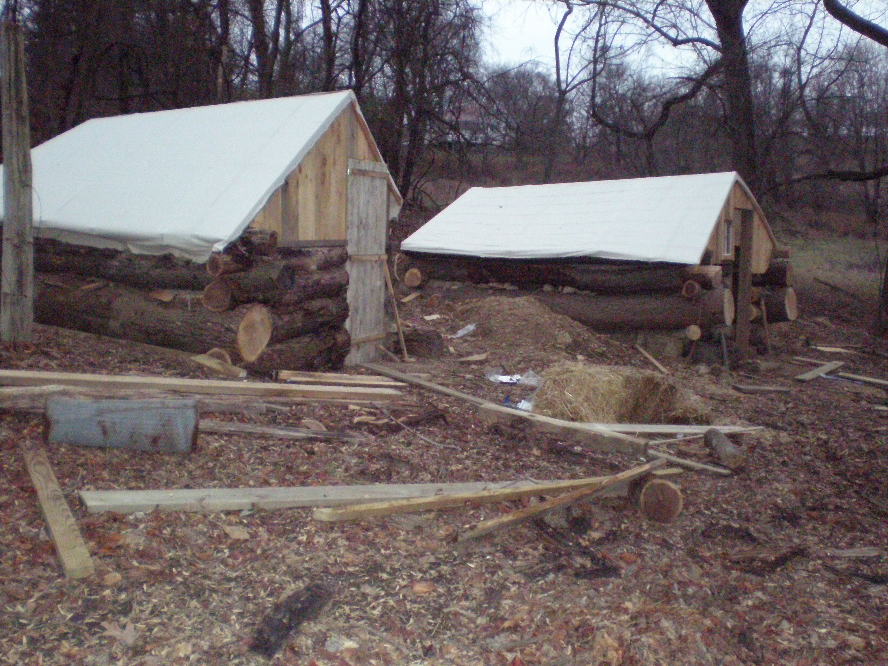

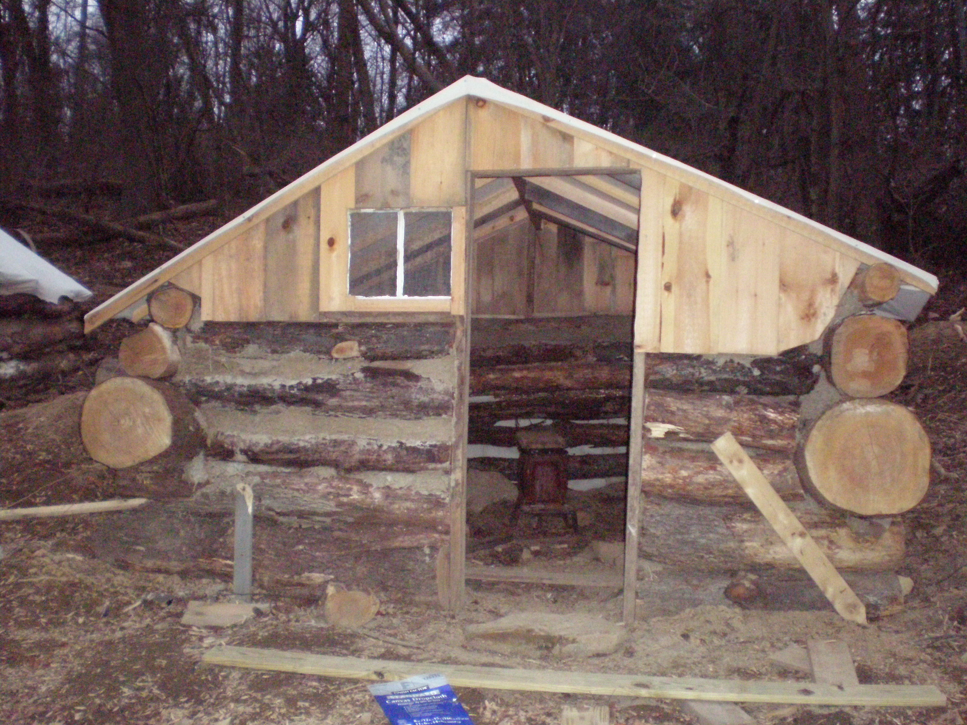

                            Re: updated progress
                            still working on them, the little one is done and the larger one needs a door and few more hours of chinking
