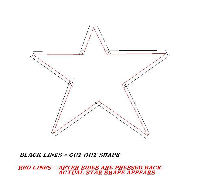

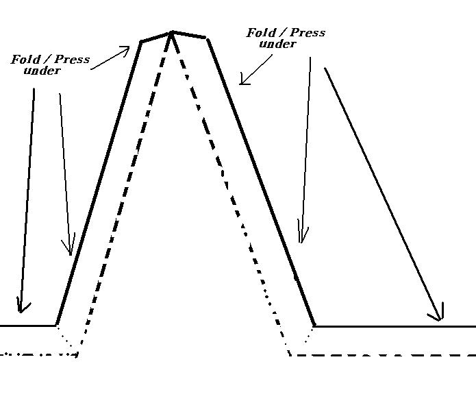

    When the stars are cut out, it isn't cut a as star, rather a 5 or 6 pointed 'starish' shape. It should be cut out larger than the finished star shape, with the ends leveled off, then in the interior points cut down to accomodate folded under. So, with enough extra material to fold/press under, stars are actually in their finished shape and are pinned & can be hand felled on to prevent fraying...
    See the attached basic sketch of a star point, prior to pressing. The dashed lines show where the sides are pressed under, thus have a point to fell on to a flag. The red lines in the 2nd sketch show how the final star appears.

      Well holy smokes, that works pretty good. Thanks for that!
