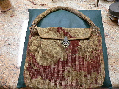

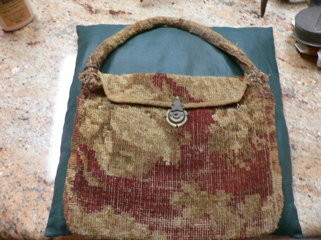

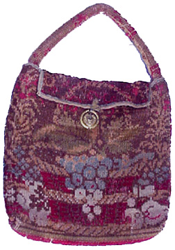

              The Horse soldier in Gettysburg, has (or recently had) a carpetbag that was id'd to a Mass. officer. His name and unit, H.W. Hale Co A 52nd Mass, was stenciled on the interior of the flap. I have come across two other carpetbags on internet auction sites identified to soldiers (see photos below). Many of these carpetbags are not large, but are smaller haversack-sized bag, with a single shoulder strap. Nearly every period carpetbag I have seen has a circular lock on the body of the bag, and a locking tab that attaches to the flap. All three of the soldier identified bags I speak of have this identical lock on them.

                So are we shifting the previous definition of "carpetbag" to now mean a "carpet haversack"? Each of the photos offered so far are carpetbags.
                I've got a carpet bag that is roughly the average dimensions of 4 originals I was able to get measurements of and I tried to rig it to carry at Bummers. It never felt right, so I eventually went back to a regular US issued haversack for my impression.
                Is there any evidence of a depot issued haversack made of carpet?
                Is there any evidence, written or photographic, of a haversack made of carpet?
                If not, the thing is rarer than jaguar pants and is not PEC/NUG. Let's be careful of endorsing something less common than jaguar pants.
