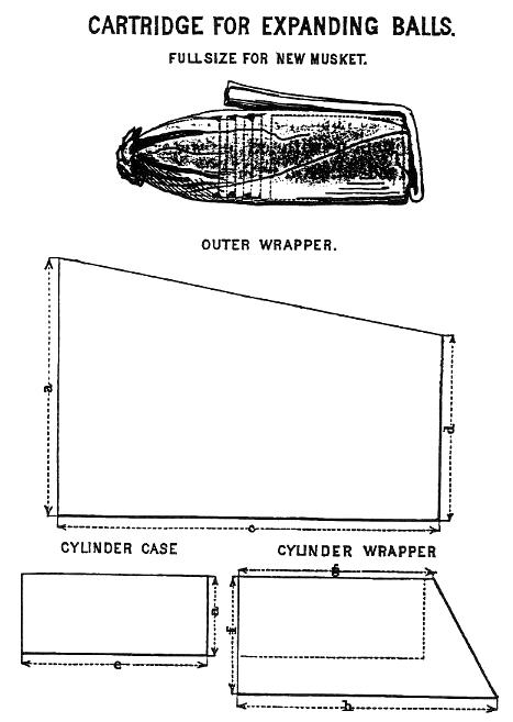

        According to the "1861 Ordnance Manual:"
        Specifically I'm looking for a list of the actual sizes of the various papers to form the following cartridges:
        .69 Buck-n-Ball/Round Ball 4.33 X 5.25 X 3.0
        .69 Rifled Smoothbore Musket 4.0 X 4.125 X 2.5
        .58 Rifled Musket 4.12 X 4.0 X 2.5

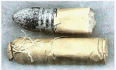

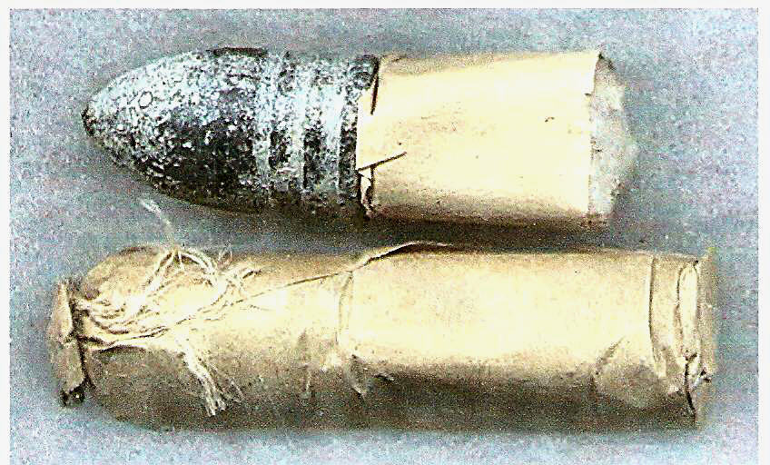

          Your request got me to thinking that I never had the true dimensions for the paper sizes they actually used 1855 and beyond. I have used facsimiles of paper sizes, but had nothing at home that mirrored what they used. The closest thing I had was the attached reference, but no dimensions.
          When I made live rounds, always made two of the wrappers, one to cover outside, one to shove inside the paper case, up into the hollow of the Minnie, to hold the powder, and keep the powder away from the bullet.
          This works OK, but it's not what I know they did back then in 1855 to the early part of the war. I know the ST. Louis Arsenal used the stiff paper rolled up and crimped inside the outer case, to give stiffness to the cartridge, and protect the bullet/powder from contacting each other. I know they did this thru the war, as I have seen pictures of originals, and they show the lower section to be formed this way. http://www.baymediapro.com/collectio...ils.asp?BID=57
          You can see a definite difference between the bullet, and where the powder is stored...the powder cylinder is not shoved up into the hollow bace of the cartridge, thus making the cartridge longer, than if it was shoved all the way up into the hollow.

            Hey Curt, I was hoping you would step up to the plate! You must have posted while I was writing a reply to Cody.
            My second post, is what I'm seeing an experiment, or the final adopted cartridge form in 1855?

              Hmmmmm. I think you are thinking about the problems initially experienced with the .58 "Minie" and .69 EB where the beeswax/tallow lube was getting into the powder in warmer weather?
              Yes, the initial of the "M1855" cartridge was made with three pieces of paper: the outer wraper, the cylinder case, and the cylinder wrapper. Those three making the cartridge's outer wrapper, with a separate "cylinder" for the powder charge, and a piece of "rocket paper" to reinforce the walls of the powder cylidner mkaing it extra rigid to allow the outer paper to tear witohut also tearing the powder charge's case.
              Somewhere along the line, someone at St. Louis fussed about it, and they deleted the "rocket paper" and made the wrapper slightly larger- which was copied by Kennebec and Allegheny. That had an influence on the new 1861 Ordnance Manual which called for two pieces of the same type and size of paper to be used for the outer wrapper and the powder case. One can NUG tell the post 1861 type cartridges by the two folds in the tails, and that their bundle paper was not waterproofed or labelled (St. Louis continuing to label only).
                Re: Cartridge paper sizes
                "Somewhere along the line, someone at St. Louis fussed about it, and they deleted the "rocket paper" and made the wrapper slightly larger- which was copied by Kennebec and Allegheny. "
                Curt, as always, Thanks! The picture of an 1855 cartridge was emailed to me by someone a while back, it looks to be what your talking about.

                      The most important page out of The ordnance manual for the use of Officers of the United States Army is page 270. I have a copy printed out in my minature powder magazine...
