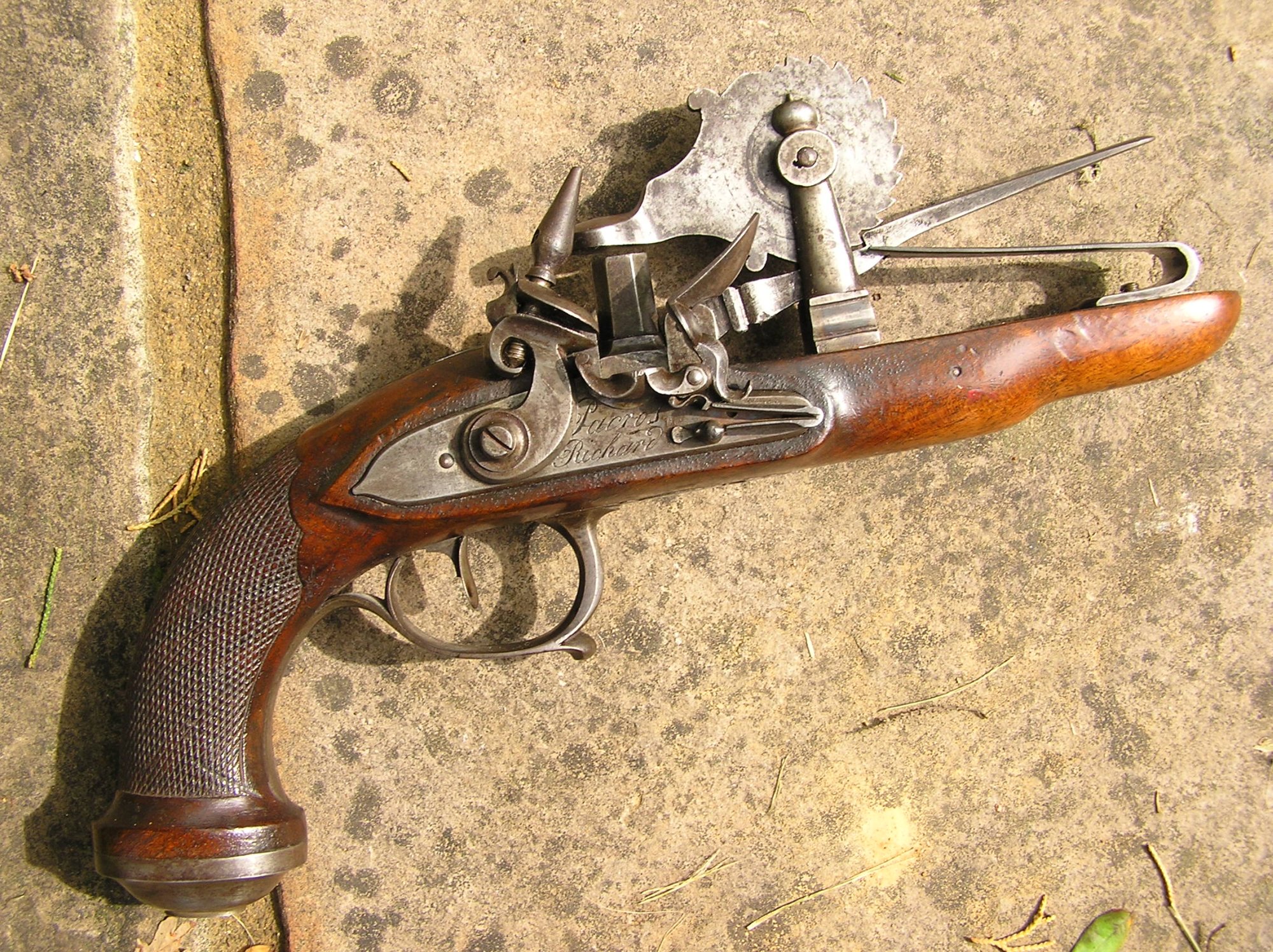

    The black powder testers of the era were called "eprouvettes." Then, as now, the strength of individual lots of powder varied. When making up lots of ammunition, a competent ordnance officer would test a new lot of powder to determine if it was stronger or weaker than his "standard" lot of powder, and adjust his loadings up or down accordingly. The sights on military weapons are regulated for a standard projectile propelled at a standard velocity. If the velocity is changed by a stronger or weaker lot of powder, the point of impact of the projectile changes. The piece at auction a a crude version of the concept, and the sales description is flawed, but you get the idea.

      Their description (which includes how it measures powder strength) is: "An unusual conversation piece made just as good or better than the originals of the 1830 and 1850. It tests the strength of various granulations and different production runs of black powder to learn which is the best and which is the weakest. To operate, the short barrel is loaded to the muzzle with black powder; the tester is fired after the indexing lever is turned over the muzzle. Upon firing, the indexing lever turns the little spring loaded wheel which indicates the relative strength of the powder. High quality and nicely engraved. Wood grips and, of course, it is a boxlock style frame."

        A pre-measured amount of powder was placed in the chamber, which was then closed. On the type shown at auction a fuse was inserted in the touch hole and lit. When the charge ignited the "lid" of the chamber opened. The strength of the sample was indicated by the graduated figures stamped on the side of the wheel.

            Before seeing it, I was also unaware that they existed. The one in their collection on display was similar to the reproduction that Calum linked above. It was produced to look like a small, Derringer style, pistol with a pan for the powder. As already described above, once the powder was ignited, the explosion would engage the numerically marked lever system, which would estimate the strength of that batch of powder.
            Found this example archived on some forums somewhere in cyberspace after a google search:
