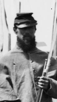

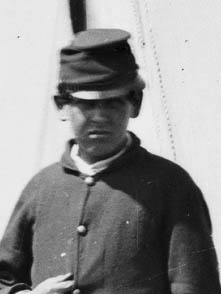

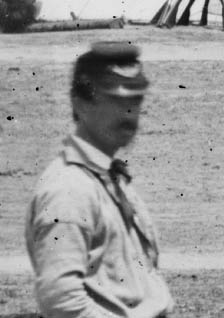

        Yes, let it do its thing. Over time, the stiffener will lose some of its ability to "stand" on its own. And, remember that the originals varied, too.
ID:	222785Click image for larger version
ID:	222786Click image for larger version
ID:	222787Click image for larger version
