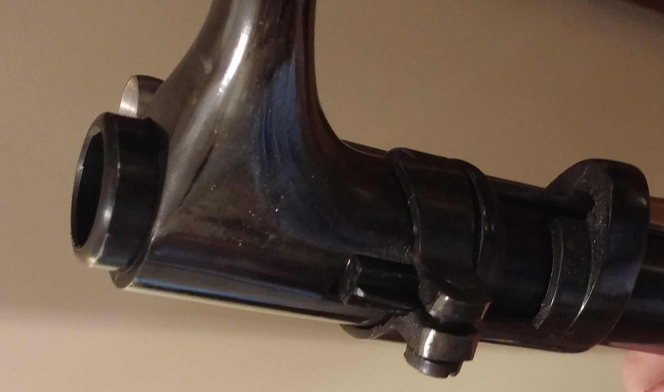

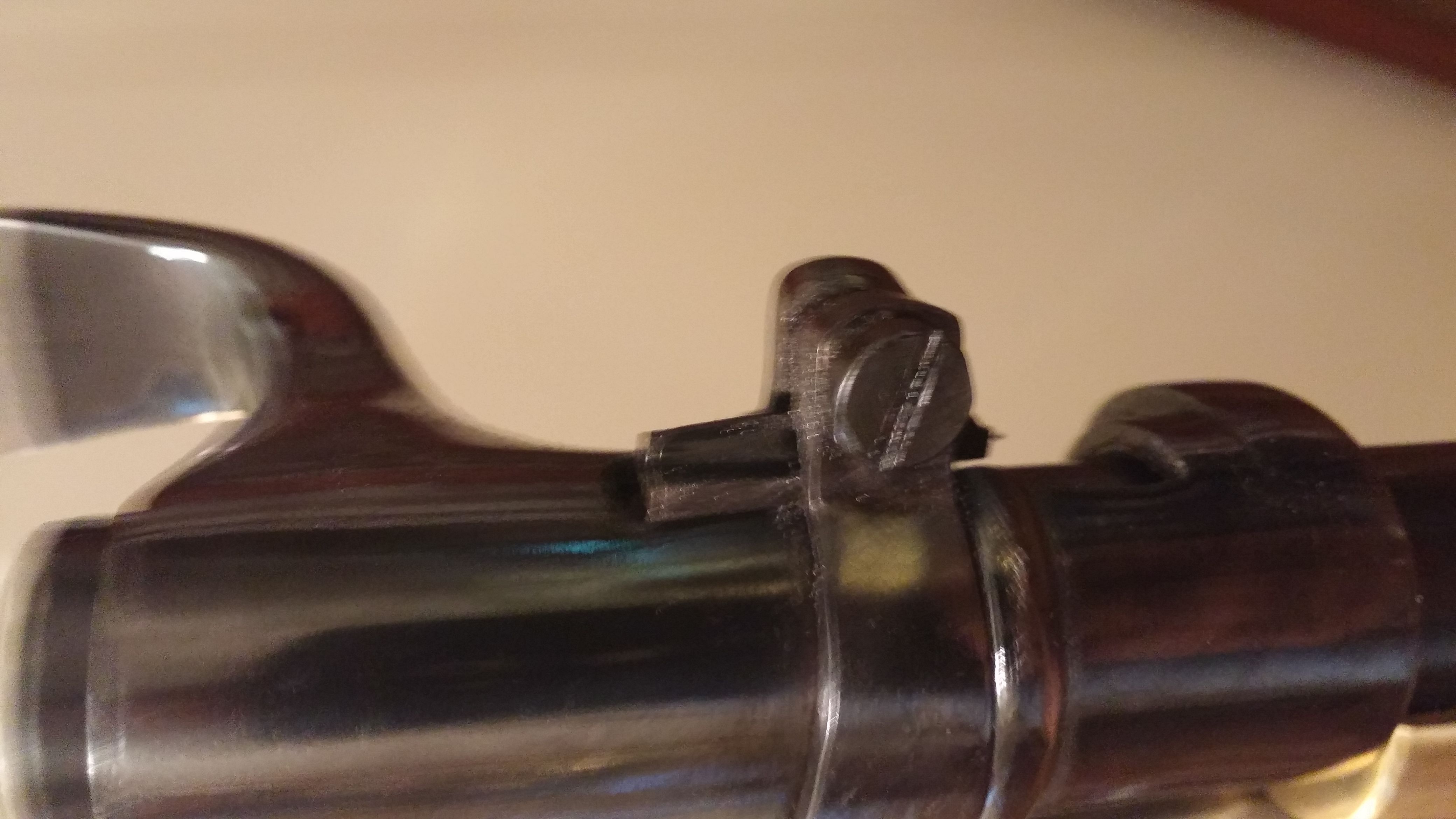

    I recently acquired one of the "Salter" reproduction Enfield bayonets that Blockade Runner sells. It actually fits the barrel of my Pedersoli 3 Band Enfield nicely. The problem I am having is that the bayonet bottoms out before the locking ring can slide just under the sight. I thought about removing the locking ring and grinding the bottom of the ring to remove some material. Any suggestions? I tried searching for prior threads but I did not find anything similar. I also tried to attach some photos.

    In my experience, it's actually easier to lengthen the slot than to reduce the ring.

      The bayonet is bottoming out against the brass nose cap. The slot is long enough but the bayonet can't slide down far enough to allow the ring to slide past the front sight into the locking position.

        It can be hard to impossible to diagnose things without having gun in hand or seeing it, but...
        it is "sounding" like the front sight/bayonet stud needs to be taken off and soldered back in the location that allows the slot and locking ring to be where they need to be to work. (You cannot easily shortened the end-of-stock to muzzle distance, and it is really really hard to shorten the socket length.)
        Short of that, IMHO, is getting a better quality bayonet.

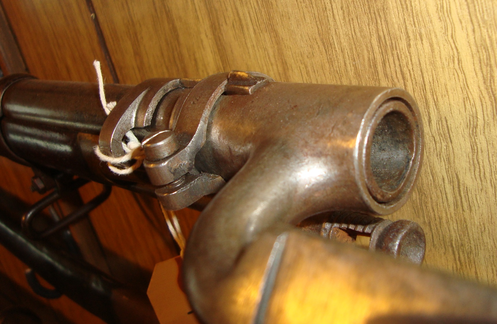

          This is an original P53 bayonet attached to a original Tower. Notice the nice fit with no barrel protrusion from the bayonet. Your sight may be in the right place and the bayonet is the problem. You need to check the position of the sight. If it is about 1 & 3/16 from the end of the muzzle the problem is probably the bayonet.

            Or, what I recommended in The Civil War Musket for those situations, remove the nose cap and shave off some wood from the end of the stock. You can also grind down the locking ring a bit or replace it with an original locking ring. The problem with those India made bayonets is they are all off in some way or another, so it is difficult to make any firm recommendations one way or another with regards to whether you should return it and get a replacement. If you got another bayonet it might have some other oddball problem.

              I very much appreciate all of the comments. For now I opted to grind the bottom of the locking ring until it would slide into the locking position. After grinding the ring I used some emery paper to remove any sharp edges and touched up the bluing with some Birchwood Casey Gun Blue. I'm still not happy with the way it is sitting against the nose cap but it fits tight and doesn't wobble around the barrel. I guess I can use it this way until I find a better fitting bayonet. Lesson learned, bayonets are like clothing, better to try it on before you purchase.

                  No, in terms of that area where the shoulder meets the socket... the originals do not look like the reproductions that way either. I picked up a decent original off ebay for not much more than a reproduction costs, I think it was $60. Fits well, good locking ring, looks good etc.
