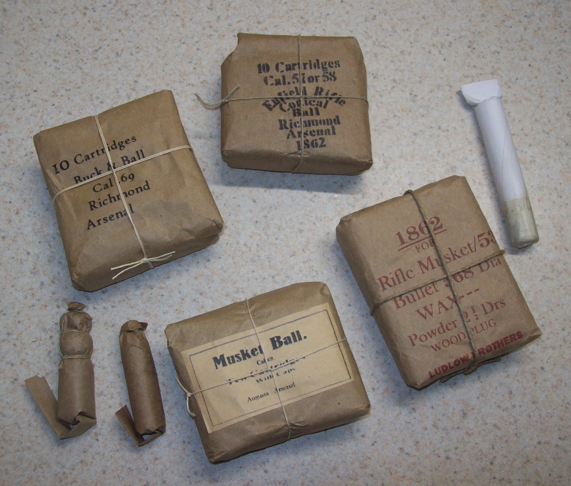

    I use the masking paper exclusively, I find it's stronger than newsprint (any form) and easy to work with, though it's a bit too brown in color. Confederate AP's were usually stamped on the wrapper, or used labels that were pasted on. The photo attached are some (not all) Confederate labels/cartridges I have used. the enfield cartridge I used typing paper to form, everything else I used masking paper.

        David:
        Well, these labels I have are word documents, print em off as needed either directly on the paper, or print the separate labels on different paper, and paste them on the wrappers, per originals. I have MORE labels from different arsenals, unfortunately nothing much survives that can be used directly for Tran Mississippi area.
        I have .54, .577/.58, and .69 RB/B-n-B/Buckshot labels. PM me, I can pass em onto ya. (Have a few Yank labels too!):wink_smil
