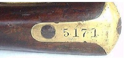

    Gentlemen,
    Going along with the previous thread discussing weaponry, I have utilized the search function and come up with no matches for a quandry I have been thinking about.

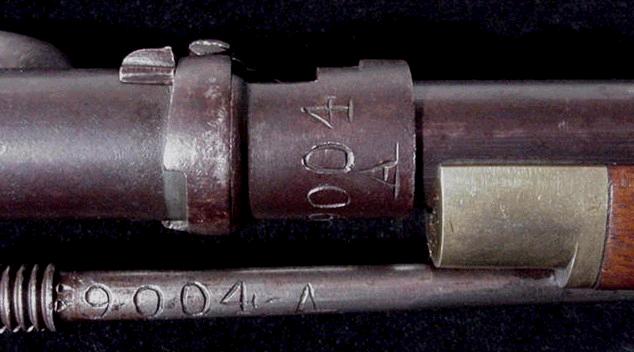

    Some Confederate import Enfields carry matching hand scribed serial and rack numbers on the buttplate, ramrod, and bayonet. Since I have removed all modern markings, this leaves my rifle naked, and difficult to prove ownership in case of theft.
    Quote: "After Confederate agents made their purchases, certain stampings would be made on the items so as to make sure they were delivered to their intended parties. For example, on some Enfield rifle-muskets, you may observe an oval Birmingham stamp on the stock which was the exporters stamp. You may also find letters and/or numbers on the stock and even the ramrods of some weapons. Letters such as “G” or “SC” stood for the states of Georgia and South Carolina respectively. Serial numbers on the butt plate tang and the ramrod were usually rack numbers assigned by the Confederate importers when they came in off the blockade runners. These numbers should appear to be carved into the metal and not stamped. These letters and sometimes even the serial numbers were also added to swords, and other weapons as well. " Civil War Antique Preservation Society Article
    Website for CWAPS article
    Question 1- Would it be appropriate to mimic these markings in order to give my weapon a "serial No.", or would this be too impression limiting?
    Question 2- Should we see more of this on Confederate weaponry?
    Question 3- If so, what tool would have been used to do this inscribing, and where can I get one?
    Attached is a photo of a Id'd Confederate imported Enfield with correct bayonet.

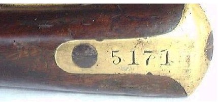

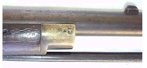

              Note the pics:
              1) Buttplate of a CS Enfield (1861 Tower).
              2) Nosecap of a Potts & Hunt documented to 12th Mass., Company H.
