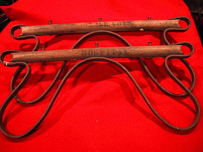

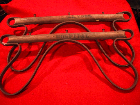

The Coolidge litters are rather bulky. Satterlee offered a patent design that made the more conventional litter (two poles with canvas stretched between) more managable. See picture of the patent brace below.
