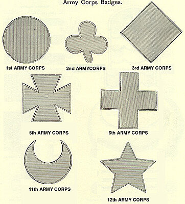

    I want to make sure that no one who is registered as Federal for "Into the Wilderness" will be unaware that a corps badge is expected on every forage cap. There are four styles available from giltwire@aol.com. The preferred enlisted man's options are the bottom three (please see attached image). Contact the vendor about pricing. All three are offered in a period wool and not the modern felt. The badge should be affixed as a cross and not as an "X".
    If you are of a mind to make your own, the suggested dimensions are 1 3/4" in diameter by 5/8" wide across the arms of the cross.
