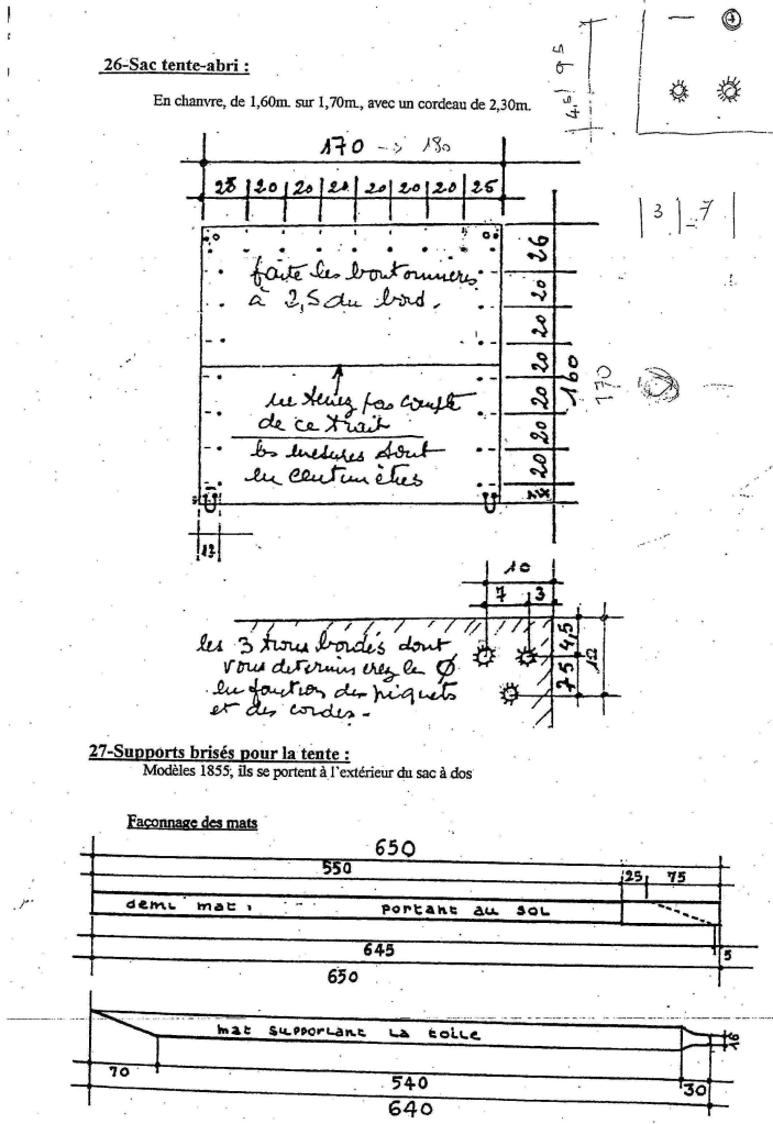

                        Just thought I would share something posted on a French blog "Paco Fait le Zouave", a photo from some magazine article on French equippage of the 1860s. There is a tantalizing glimpse of an old shelter tent, not enough to see the corners unfortunately, but enough to see that it has hand sewn hems and very black buttons. I am assuming they are bone or possibly horn - one of them is broken and a metal button wouldn't break like that.
                        All right, since I cant trick this into posting a picture, I'll send a link...
                        Bienvenue sur ce blog. Passionné par les uniformes du XIX siècle et l'armée d'Afrique on dit de moi que je fais le zouave......mais pas que ! j'essaye de varier les plaisirs et j'espère que vous trouverez le votre ici. Bonne lecture.
                        Scroll down about three quarters of the way. You'll see a blanket with white gloves, a red and blue kepi, and lots of little items, all partially lying on a shelter tent. Hope somebody is looking for this and never yet found it. Just might explain why the Cincinnati Depot used darkened bone buttons....
                        David Stone
                          Re: The French Tente d'abri
                          Hello fahnenschmied, the shelter is dated two times 1856 and 1859, and it seems to be entirly hand steach!!You are right for the buttons, they are made from bone, teinted in black. They serve for french trousers too (for suspenders), and for cap pocket on the cartridge box. (french army didn't use a separate cap pouch!)
                          best regards
                          paco
                          François Mazen

                              Thanks, François, I suspected that the buttons were the same as trouser buttons - I thought I saw bright red ones on some Zouave trousers once, but they were fabric covered. Now I will have to dye or find some black bone buttons for my French tente d'abri. I made mine from some drawings given to my by some German zouave reenactors from a site Les-zouaves.de, I believe, but I cannot find their site anymore. I would post the picture but I cannot trick AC into letting me upload an image from my computer...let me try one other thingClick image for larger version
                              Maybe that'll work...
                              Perhaps it did! While in the sketch, it looks like there might be buttons and buttonholes in the upper corners of the tent, the detail sketch of the corner show three eyelets. So what, you say? Well, Flomerfelts (Sp?) description of the shelter tent says something like "First button to be 11 3/4 inches from the end of the tent"....and all surving Federal tents have the first button only an inch from the end of the tent. This bit of information seems to be overlooked in Gaedes excellent book on the Federal Shelter Tent, but I noticed it in making my replica. If you made a tent sticking to the earliest published U.S. description, it will have 21 buttons and not 23...
                              While I am on the subject, if you look at the odd fractions that the buttonholes are to be spaced at, they are not at some even figure like 8 inches, on the US models the earliest descriptions have them at 7 5/6 or 7 21/24 or some other really odd fraction - I cannot remember exactly what they are, and I don't have Gaedes book handy - but it is really obvious that someone was measuring a French one and trying to get at the nearest equivalent to 20 centimeters, on an English ruler.
