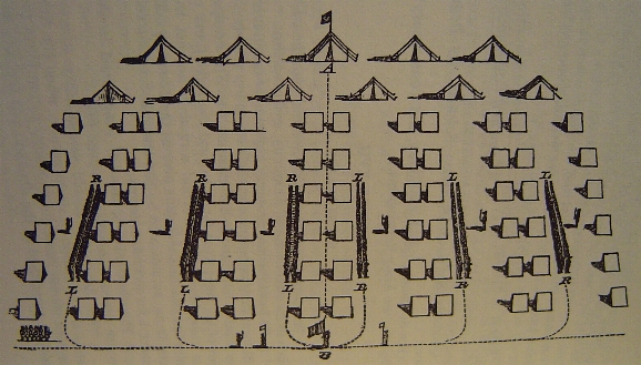

    As I understand it, the laying out of camps per Regulations was pretty much a hit-or-miss affair, depending on the caliber of the commanding officer. The best description of a winter quarters accmodation is in Josh Billings "Hardtack and Coffee" His description and Chas Reeds' illustrations match the photos I've seen of winter quarter huts
    Tom Smith, 2nd Lt. T.E.

            As Greg has shown, there were regulations about how camps were to be laid out. That said, not everyone followed the regs. Topography, size, etc. often influenced how camps were organized.
            There is no standard for how huts were built. More than likely, it was left up to the men who inhabited the hut as to how it was constructed. I see that you live in Virginia. If you have a chance, visit the White Oak Museum in Stafford County (very close to Fredericksburg). There, you can see a handful of reconstructed huts based on the evidence dug up by the proprietor.

              To support Eric Mink's post, the actual layout and construction of a winter camp depended on many factors, particularly including topography of the site and the attitude of the commanding officers. If they directed specifics and enforced them, then the camp would perhaps be closer to "regulation"; if they brigade or battalion commanders were a bit more hands-off (and many were), then the camp could vary quite a bit from "regulations".
              Engineer regiments were few and far between in the Civil War and did not have much to do with how a brigade's camp was arranged and built.
              Even within the same camp, there were huge variations in how the men's quarters were constructed. Some had fairly well-done hutments, and others lived literally in a hole in the ground with a fireplace in it and perhaps a canvas cover over the entrance. There's one photo of officers of the 164th New York and 170th New York in the winter of 1863-1864, nera the Orange & Alexandria RR in the Manassas area, where the officers are standing around a "hut" that looks like little more than a huge mound of mud.
              Ultimately, I doubt there's even a "plain, everyday, common" answer to this question. It varied so greatly from one regiment and camp to the next, that it's probably impossible to say "This is usually how it was done..."

                The camp of a regiment or battery was supposed to be laid out in regular order as definitely prescribed by Army Regulations. These, I may state in a general way, provided that each company of a regiment should pitch its tents in two files, facing on a street which was at right angles with the color-line of the regiment. This color-line was the assigned place for regimental formation. Then, without going into details, I will ad that the company officers' tents were pitched in rear of their respective companies, and the field officers, in the rear of these. Cavalry had something of the same plan, but with one row of tents to a company, while the artillery had three files of tents, one to each section.
                All of this is preliminary to saying that while there was in Army Regulations this prescribed plan for laying out camps, yet the soldiers were more distinguished for their breach than their observance of this plan. Army Regulations were adopted for the guidance of the regular standing army; but this same regular army was now only a very small fraction of the Union forces, the largest portion by far--"the biggest half," to use Hibernianism--were volunteers, who could not or would not all be bound by Army Regulations. In the establishing of camps, therefore, there was much of the go-as-you-please order of procedure. It is true that regiments commanded by strict disciplinarians were likely to and did keep pretty close to regulations. Many others approximated this standard, but still there then remained a large residuum who suited themselves, or, rather, perhaps did not attempt to suit anybody unless compelled to by superior authority; so that in entering some camps one might find everything betokening the supervision of a crucial military spirit, while others were such a hurly-burly lack of plan that a mere pl[?]ugh-jogger might have been, and perhaps was, the controlling genius of the camp. When troops located in the woods, as they always did for their winter cantonments, this lack of system in the arrangement was likely to be deviated from on account of trees."

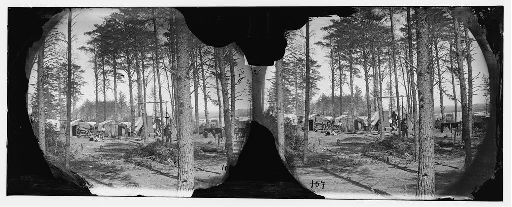

                Here are some images to take a gander at from the LOC. As you can see, there are images that show very precise camp layouts and others that are somewhat scattered.
                From: The Library of Congress Selected Civil War Photographs Collection
                http://memory.loc.gov/ammem/cwphtml/cwphome.html

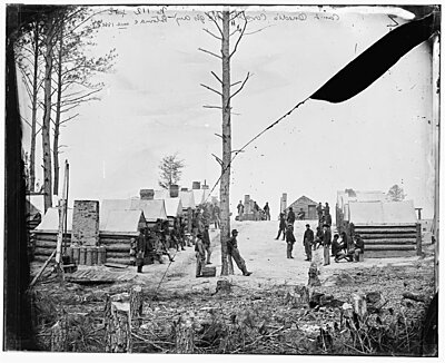

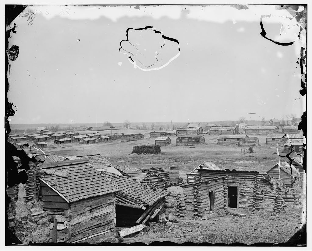

                IMAGE #1: Manassas, Va. Confederate winter quarters
                CREATED/PUBLISHED: 1862 July
                SUMMARY: Photograph from the main eastern theater of war, Confederate winter quarters, 1861-1862.
                CALL NUMBER: LC-B815- 648

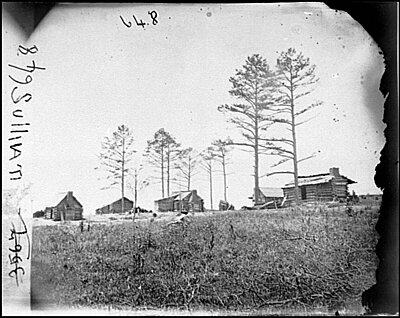

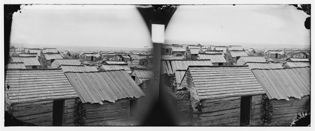

                IMAGE #2: Centreville, Va. Confederate winter quarters, south view
                CREATED/PUBLISHED: 1862 March
                CALL NUMBER: LC-B817- 7212

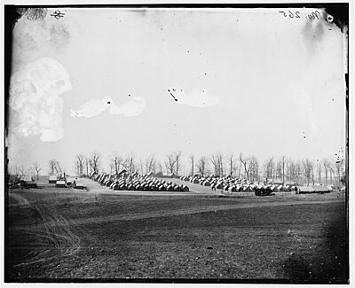

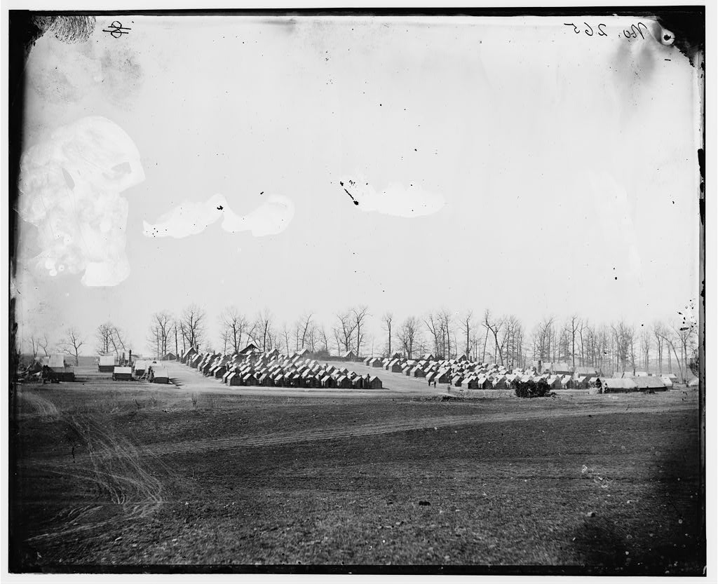

                IMAGE #3: Centreville, Va. Confederate winter quarters
                CREATED/PUBLISHED: 1862 March.
                CALL NUMBER: LC-B815- 332

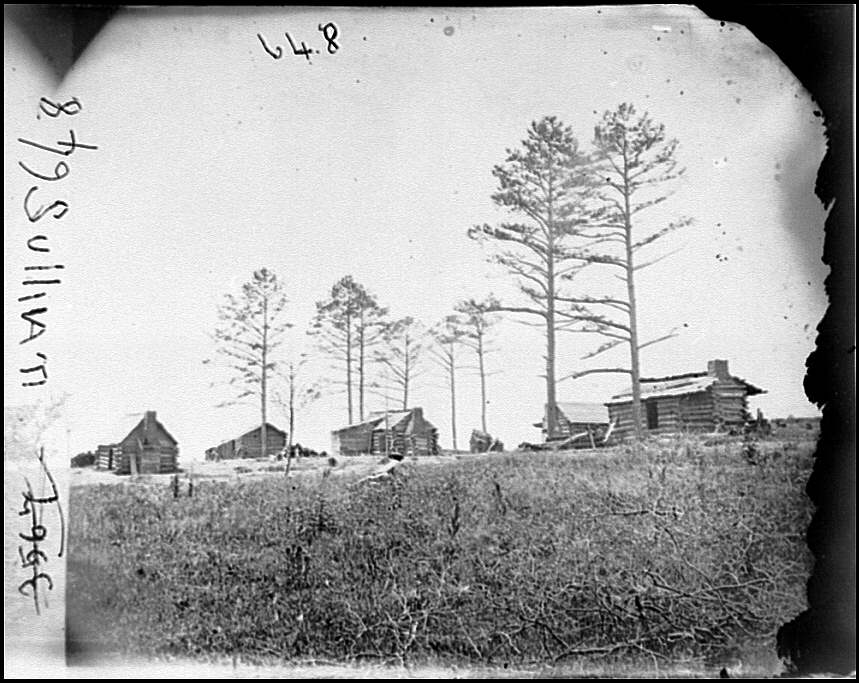

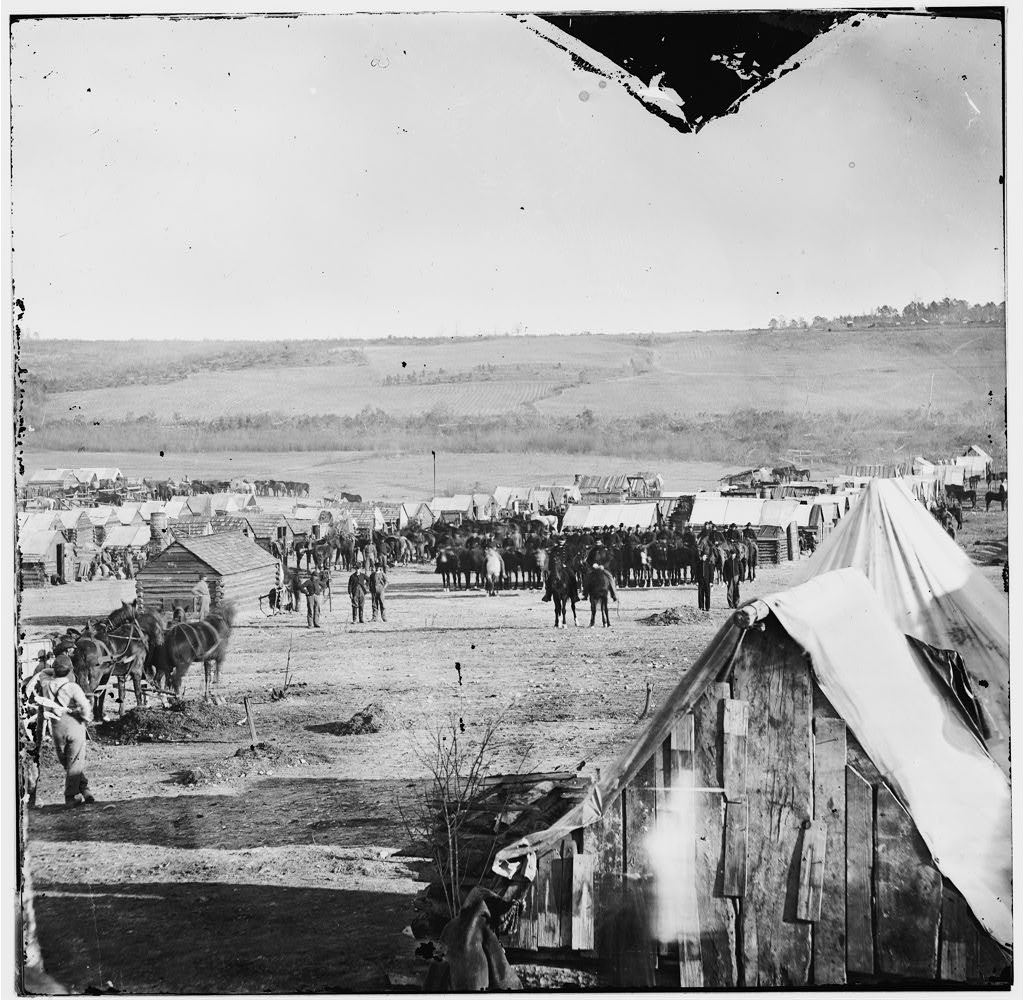

                IMAGE #4: Brandy Station, Va. Winter quarters of telegraphers and photographers, Army of the Potomac headquarters
                CREATED/PUBLISHED: 1864 April.
                SUMMARY: Photograph from the main eastern theater of war, winter quarters at Brandy Station, December 1863-April 1864.
                CALL NUMBER: LC-B815- 126

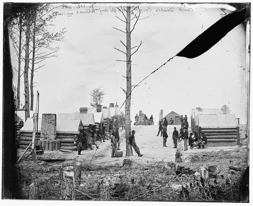

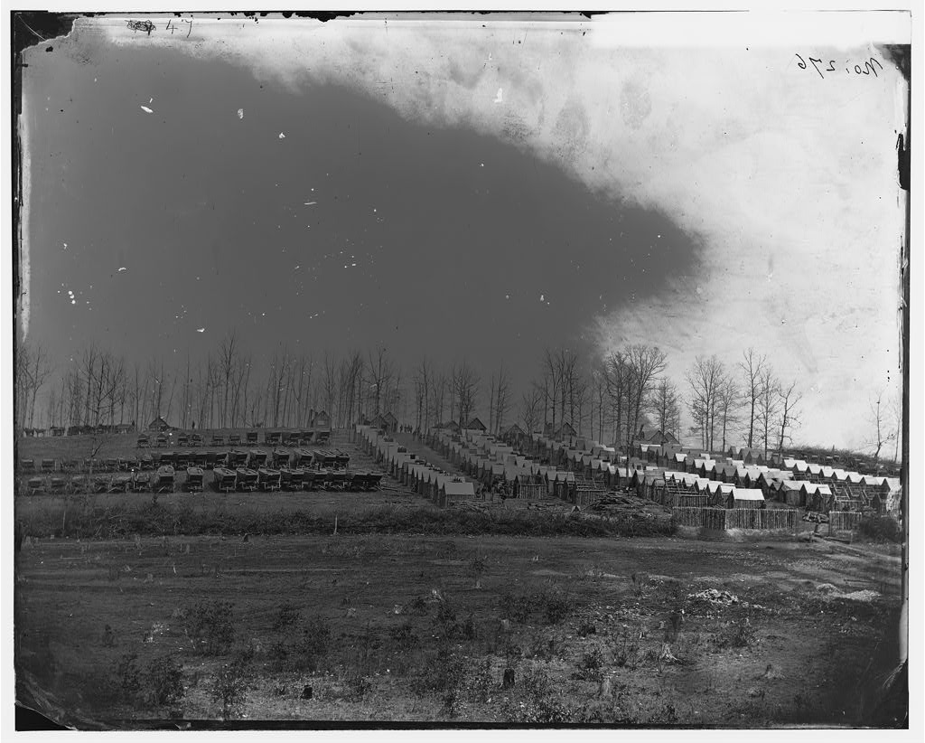

                IMAGE #5: Rappahannock Station, Va. General view of 50th New York Engineers' winter encampment
                CREATED/PUBLISHED: 1864 March
                SUMMARY: Photograph from the main eastern theater of the war, winter quarters at Brandy Station, December 1863-April 1864.
                CALL NUMBER: LC-B817- 7276

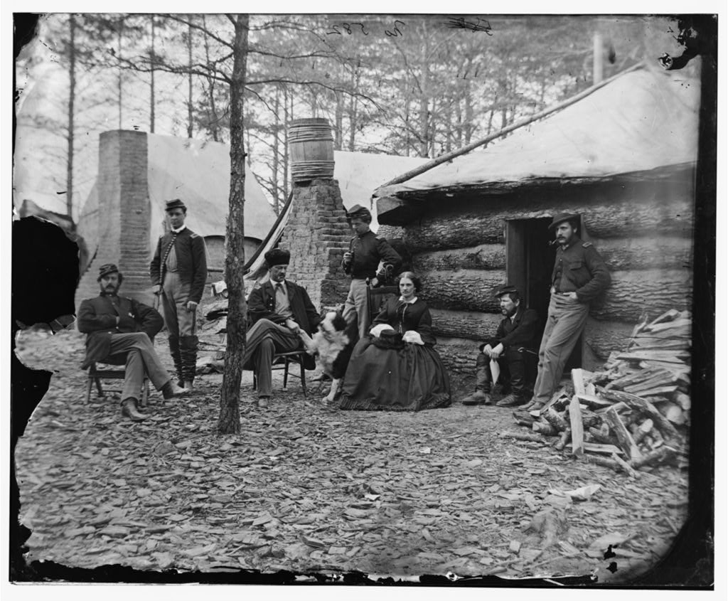

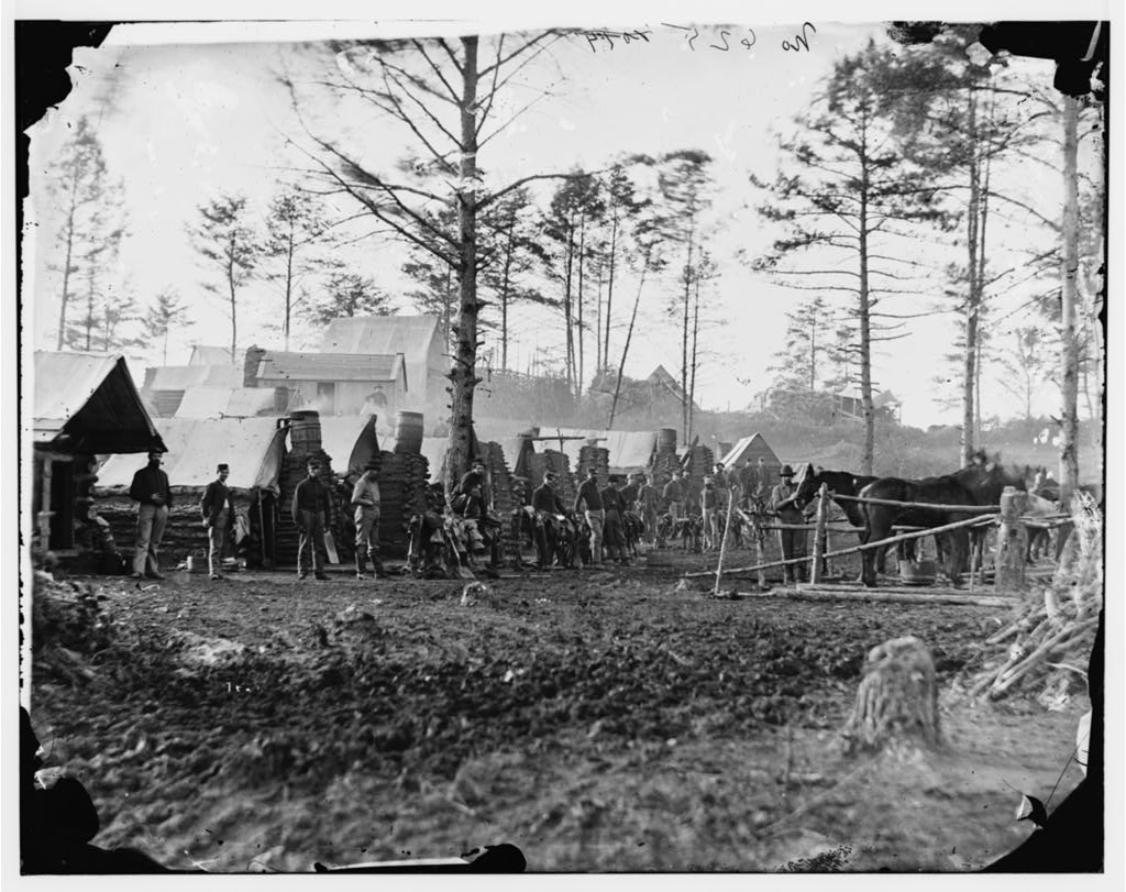

                IMAGE #6: Brandy Station, Va. Officers and a lady at headquarters of 1st Brigade, Horse Artillery
                CREATED/PUBLISHED: 1864 February
                SUMMARY: Photograph from the main eastern theater of the war, winter quarters at Brandy Station, December 1863-April 1864. Photograph includes woman.
                CALL NUMBER: LC-B817- 7582
                IMAGE #7: Brandy Station, Va. General view of 6th New York Artillery encampment
                CALL NUMBER: LC-B817- 7265
                IMAGE #8: Petersburg, Va. General view of camp of Oneida, N.Y., Independent Cavalry Company at Army headquarters, with men at leisure
                CREATED/PUBLISHED: 1865 March.
                SUMMARY: Photograph of the main eastern theater of war, the siege of Petersburg, June 1864-April 1865.
                CALL NUMBER: LC-B817- 7112
                IMAGE #9: Brandy Station, Va., vicinity. Camp of 18th Pennsylvania Cavalry, 3d Division, Cavalry Corps
                CREATED/PUBLISHED: 1864 March.
                CALL NUMBER: LC-B817- 7625
                IMAGE #10: Fort Burnham, Va., vicinity. Camp of the 5th Pennsylvania Cavalry near the battlefield of Oct. 29, 1864
                CREATED/PUBLISHED: Between 1860 and 1865
                SUMMARY: Photograph from the main eastern theater of war, the Army of the James, June 1864-April 1865.
                CALL NUMBER: LC-B811- 2499

                        In the photos that Mr. Conley posted it seems as if shakes are almost the norm for the roofs of the confederate shanty's. I've noticed with some other photos of confederate huts that they have simple shake or log roofs, not tent roofs.

                          Is that an impromptu gallows or a skinning frame in picture number four?
                          Lawrence Underwood, Jr.
                          Mobile, AL
                          21st Alabama Infantry Reg. Co. D
                          Mobile Battle Guards
