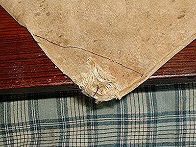

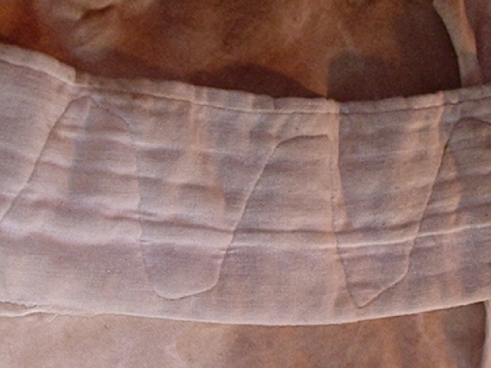

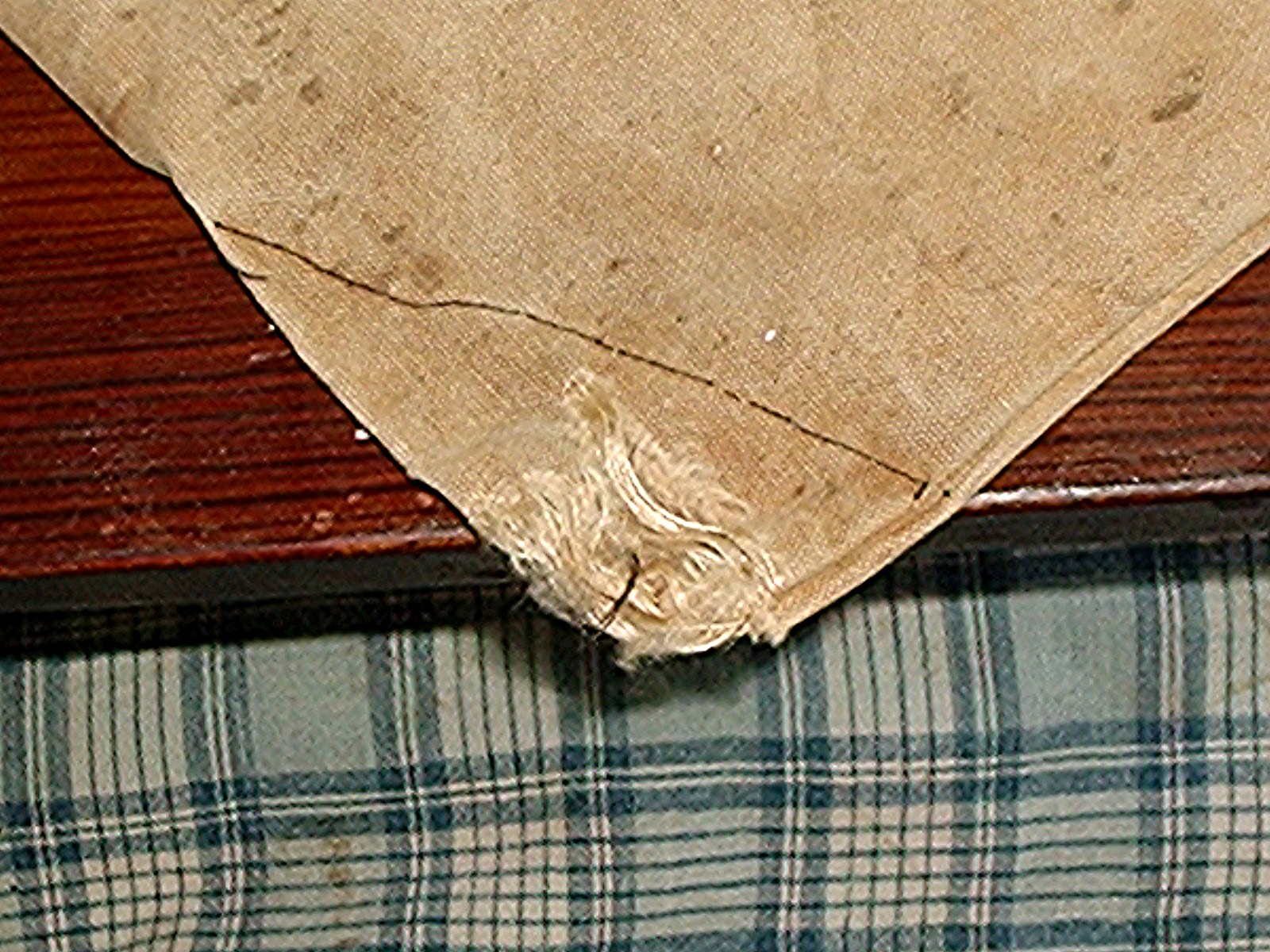

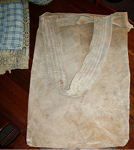

      Tow field or crop bag, cotton strap. 25" X 34 ". ca 1860. Goldsboro/Mt Olive, Wayne County, North Carolina. Attributed to Aleck Buoy, a slave, later listed on the rolls of the 135th Regiment, United States Colored Infantry. Private collection.
      Last edited by Vuhginyuh; 12-23-2007, 09:50 AM. Reason: NOT a USCT artifact/haversack, added size
