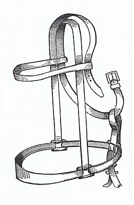

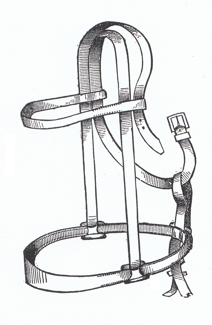

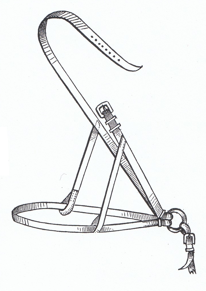

                      Civilian halters a.k.a. “Head Collars” were a different animal than the caveson but the terms were often erroneously interposed. Rope halters were most definitely a pre war civilian item. Other than leather other common materials used to make halters were webbing and hemp or jute. Notations of the use of rope as a halter material can be found in pre war writings. They, like so many civilian items of saddlery, were also a Confederate issue item in very small, limited numbers but only early in the war. When the Southern State governments and Confederate arsenals were attempting to equip its multitudes coming into service they purchased all manner of saddles, bridles, blankets, halters, etc, etc. from local harness shops and saddleries. As a result, virtually any pre war saddlery item of civilian manufacture and, all manner of militia and/or local, home-made interpretation of military saddlery (incl. five ring and single ring halters) came into service. As most of us know, as an issue item the South generally utilized the five ring and single ring patterns while the North generally employed the M1859 five ring halter.
                      Pre war civilian halters came under many names and styles such as stable halters, grooming halters, Yankee halters, Spanish and French halters all with different styles but most notable variations of materials and hardware. Generally each pattern is pretty basic to those we know today. Interestingly, most “post war” commercial catalogs make very little mention of halters. Why? For both pre and post war, I tend to think that in general except for when grooming, most of the time a civilian farmer, plantation or city dweller riding would have limited need for tying his horse and thus a halter. Furthermore, the halter was a very basic utilitarian item and easily made at home (including rope) or at the local harness shop with little need for commercial manufacture (catalog sales) except to the wealthier “riding-class” and thus, those found in the catalogs are usually of fine quality leather and web.
                      Rope halters were sometimes “quick-makes”using very little and often no hardware at all. They were generally not for your wealthier riding class. In my old cowboy days I would often quickly fasten a rope halter and lengthy lead from one lariat rope in the corral, barn or “in the field” as a means to pony a just-captured horse. One could imagine this same method being used for quick work. A fancier rope halter of the period could use any number of rings and buckles, etc. or none at all. However, the use of a tether rope in some cases depending upon your station in life, might be more common.
                      Larry makes a good point about the use of “tether-ropes”. They were certainly a pre-war item of wide usage particularly in the west and far west. Not so much in the eastern world of English dominated equipage and influence but still there too. In his 1859 book “The Prairie Traveler” Capt Randolf Marcy describes the use of tether ropes vs hobbles and picket pins and makes the opinion “that I think the plan of tethering by the neck or halters is the safest, and, so far as I have observed, is now universally practiced.”
                      If one, as a reenactor, wishes to make a pre-war civilian halter of leather or rope it would be best to use the simple patterns. Oak or hemlock tanned leather of russet colors is best. Rope would certainly be hemp or occasionally manilla (expensive). Woven hemp or occasionally cotton web (white or multi-colored rolled web) would also be common civilian materials. Widths (flat or rolled leather or hemp) could vary depending upon its pre war usage. Hardware should be very carefully chosen and limited in its employment. After about 1870 the patterns and materials used in harness hardware began to change so pick the right buckles and rings. Of course, employing a tether rope would be equally as correct if not more so.
                      Illustrations:
                      1. Confederate troopers of Terry’s Texas Rangers using tether ropes
                      2. A civilian "Yankee Halter” or “slip-halter”. Similar to our early military or Confederate halters
                      3. A typical civilian stable halter.

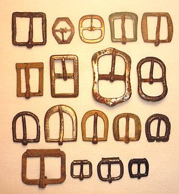

                          Rob, Thank you. The above styles were just two basic ones. There were many others. Anyone interested in making these should keep in mind their own impression. In other words, your civilian vocation, wealth (or lack of), geographic location, etc would have alot to do with what kind of civilian halter (or no halter) and materials employed (including ornamentation) that would come into play. If you just want to be different that's Ok. Just keep it in the proper period realm of pattern and materials. Also remember "Halter-bridles" were around too.

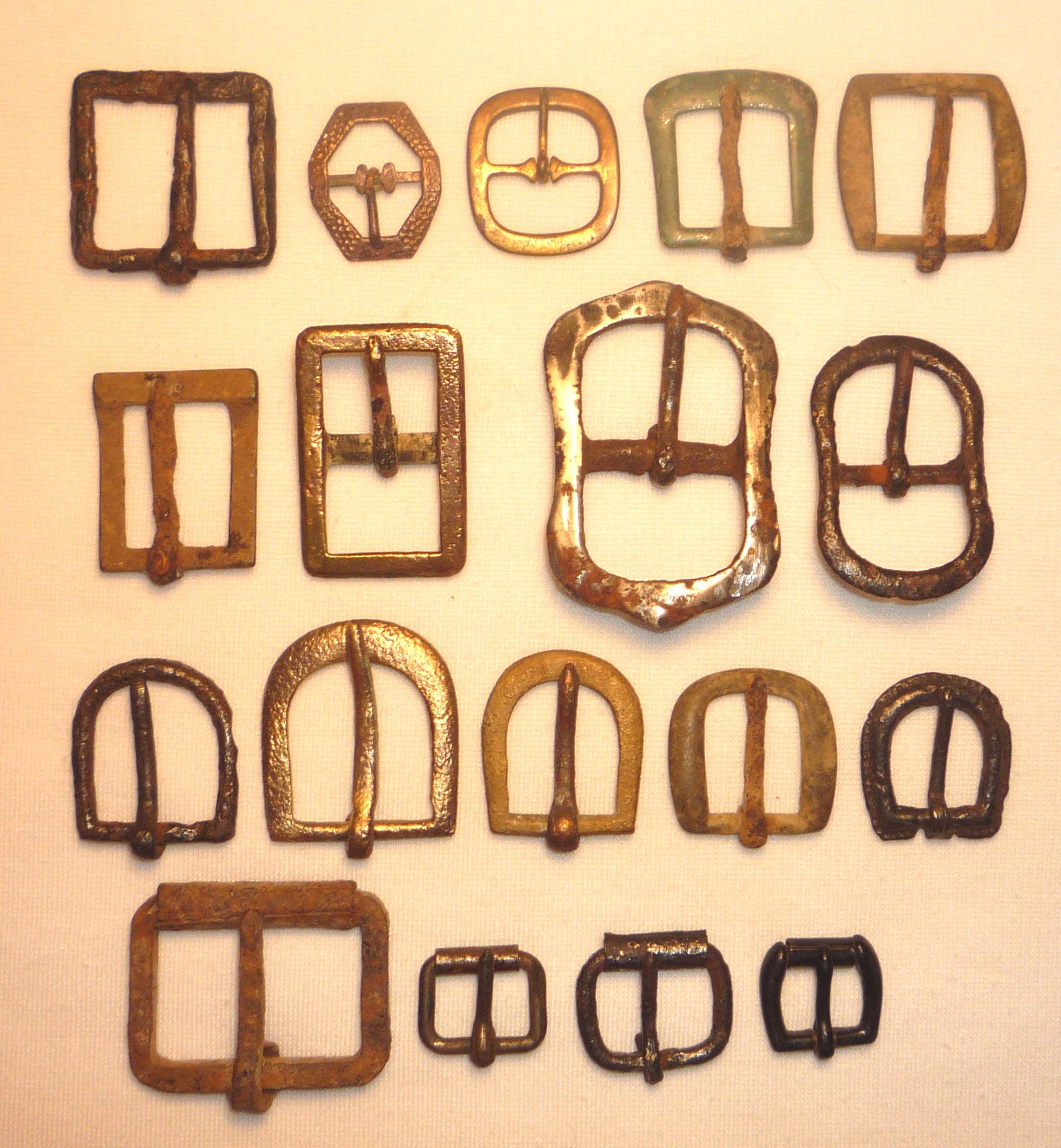

                          PHoto: Here is a quick sample of period hardware. However, not all would be used on halters.
