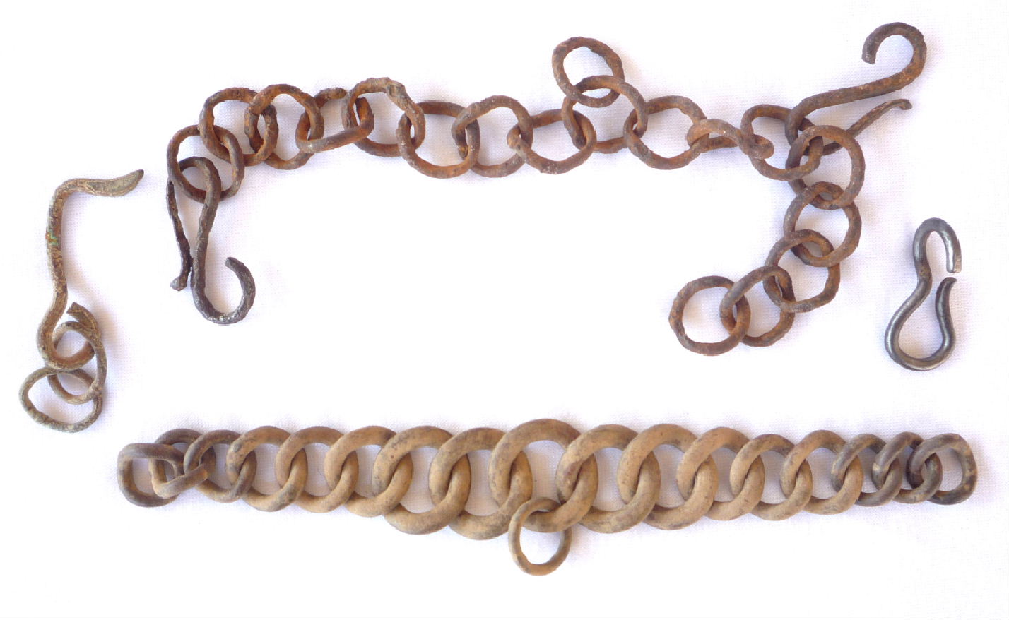

          The photos I enclose are of bridle curb or bit chains that are relative to us and were common to the war time period.
          1. Top is a British army single link curb strap taken from a British 1860 “Pad” bit. Note its fine curb hooks. The bottom brass curb chain is interesting. I believe it to be a high end quality curb strap as determined by the “link loop” that is often found on curb chains for attachment (with leather) to bridles. It was found in a dig box at a CW show. The digger told me he believed it to be a Shako (hat) chin strap. I am doubtful of this. The only chain (that I know of- someone correct me on this) employed on Shako hats was the 1881 Dress Shako and its decorative chain was not tapered and much longer nor did it have the single loop link. According to Randy Steffen, in the 1840's the Dragoon bridles (M1841and Ringold patterns) employed a spare curb chain on the top of the crown piece of the bridle. This could be one of those or just a high quality curb chain for a fancy bridle. I might be wrong. No way to know for sure. The curb hooks are comparisons....on left is a high quality period brass version and on right is a more modern but well made (tapered) variation that is plated.

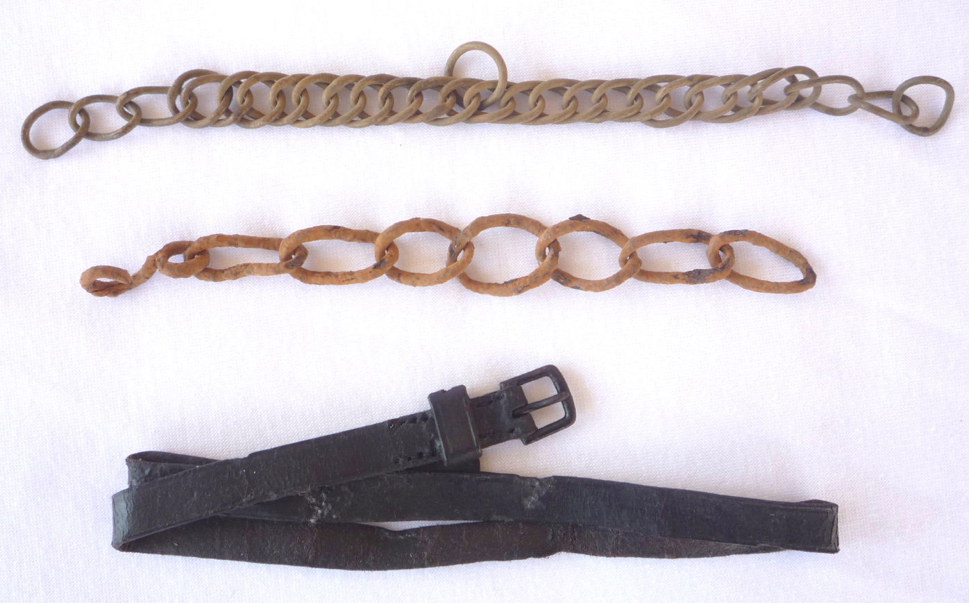

          2. Photo shows a “double gig” curb chain in comparison to a “single link” curb chain. Both were common in the military as well as civilian use during the period. The top is brass, the middle is iron and the bottom is an old leather curb strap. Leather straps were also very common to civilian usage. The Confederacy did not have the capability to make high quality double gig curb chains and they little prioritized their limited iron production to single link curb chains. As a result, what is clear from the record is their manufacturing leather curb straps with most of their bit issues- particularly for trooper’s bits. The CS curb strap would be similar to this made of narrow scrap leather, hand sewn and a small iron or brass horse shoe or roller buckle for adjustment. The same size buckle was often used on spur straps. These were the official employment of straps but no doubt other varieties of chains and leather was employed by them too.

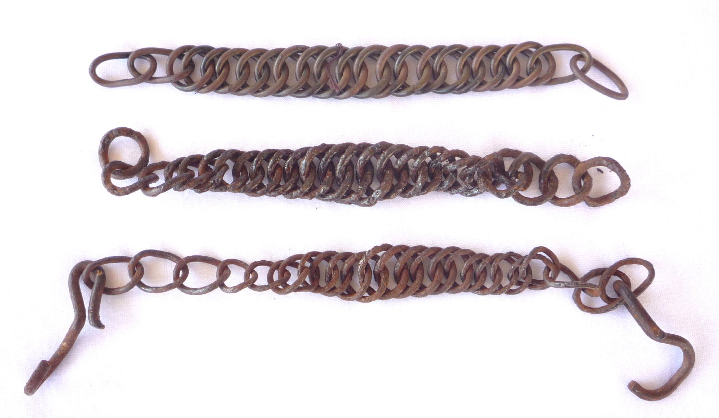

          3. Typical Federal curb chains issued on the cavalry and artillery bridles. Both brass and blued iron “double gig” curb chains were apparently the most prominent although tinned ones were provided too. I believe they always employed a leather safe or keeper with it. On the surface one might think the brass went with artillery and blued iron with cavalry but I am doubtful this was universal. Some of the more well known makers of these during the war was Condict & Wheeler and James M Frazee & Co. Both of Newark NJ. They had contracts for brass, blued iron and tinned curb chains. No doubt others made them too. The top one is brass, the middle one is iron and the bottom one with the curb hooks shows a lighter weight version that was also common.
