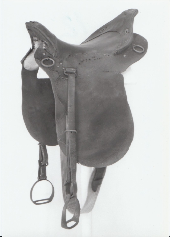

          BTW, here are a few more Jennies to enjoy!

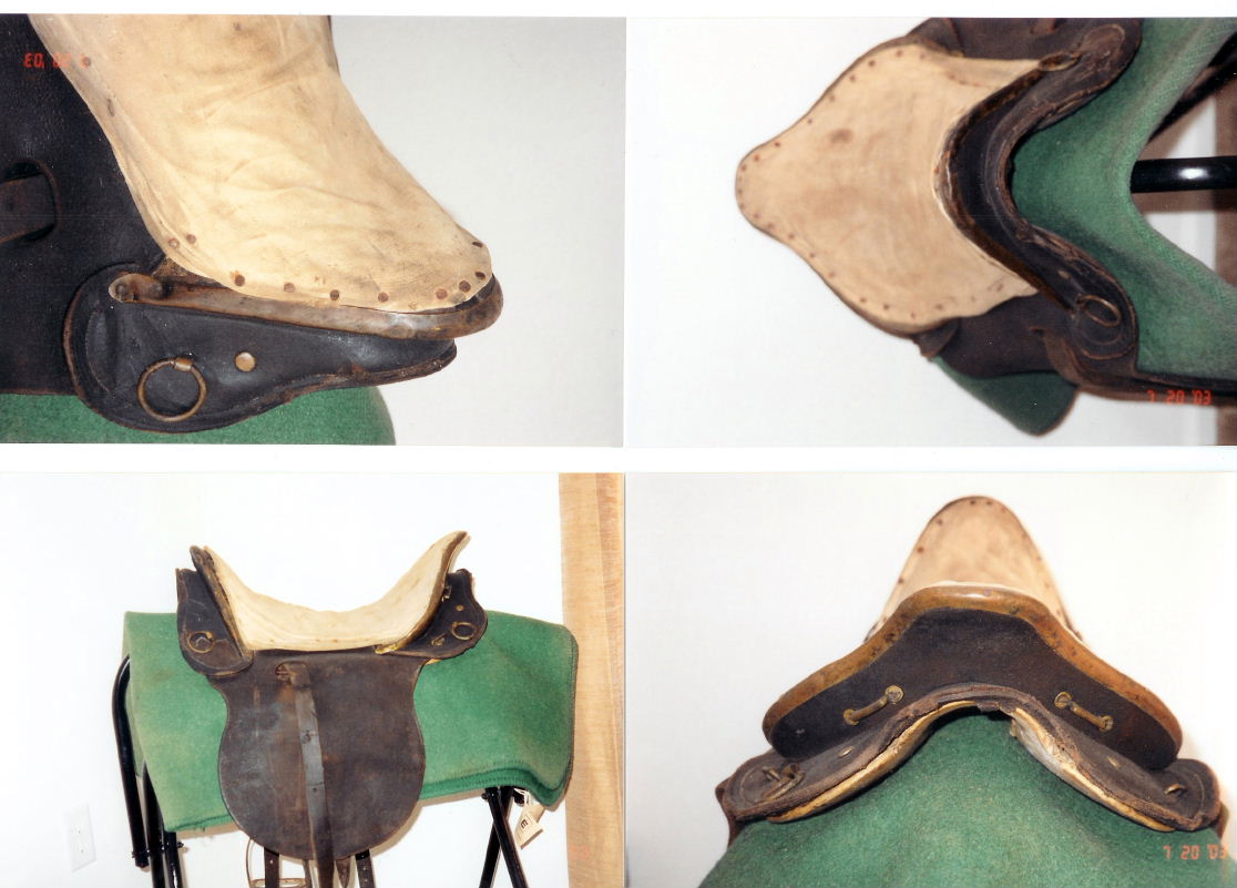

            Bowden sent me some close ups of their jenifer and it is as best I can see a grimsley. It bears no resemblance to a jenny what so ever. Even the bars have the notch cut out near the front like the grimsley. Jorge at Hadlock Fox has sent me some images of their pommel which I will post tomorrow along with the Bowden tree. By the way, Mr. Steele told me that he produces a very accurate mac tree also.

                              The above links will take you to several images of the Jenifer pommel sent me by Jorge of Hadlock Fox. It is a wood tree but fiberglassed. I assume it can be left bare as well as I have purchased a rawhided tree from them in the past. The other images are of Bowden's jenifer tree and are discolored by some unknown entity in the ether. This is how they came to me. They are a Grimsley as far as I am concerned. I am so sorry for the delay but I'm not too quick in the computer buisness and had a hard time loading them.
