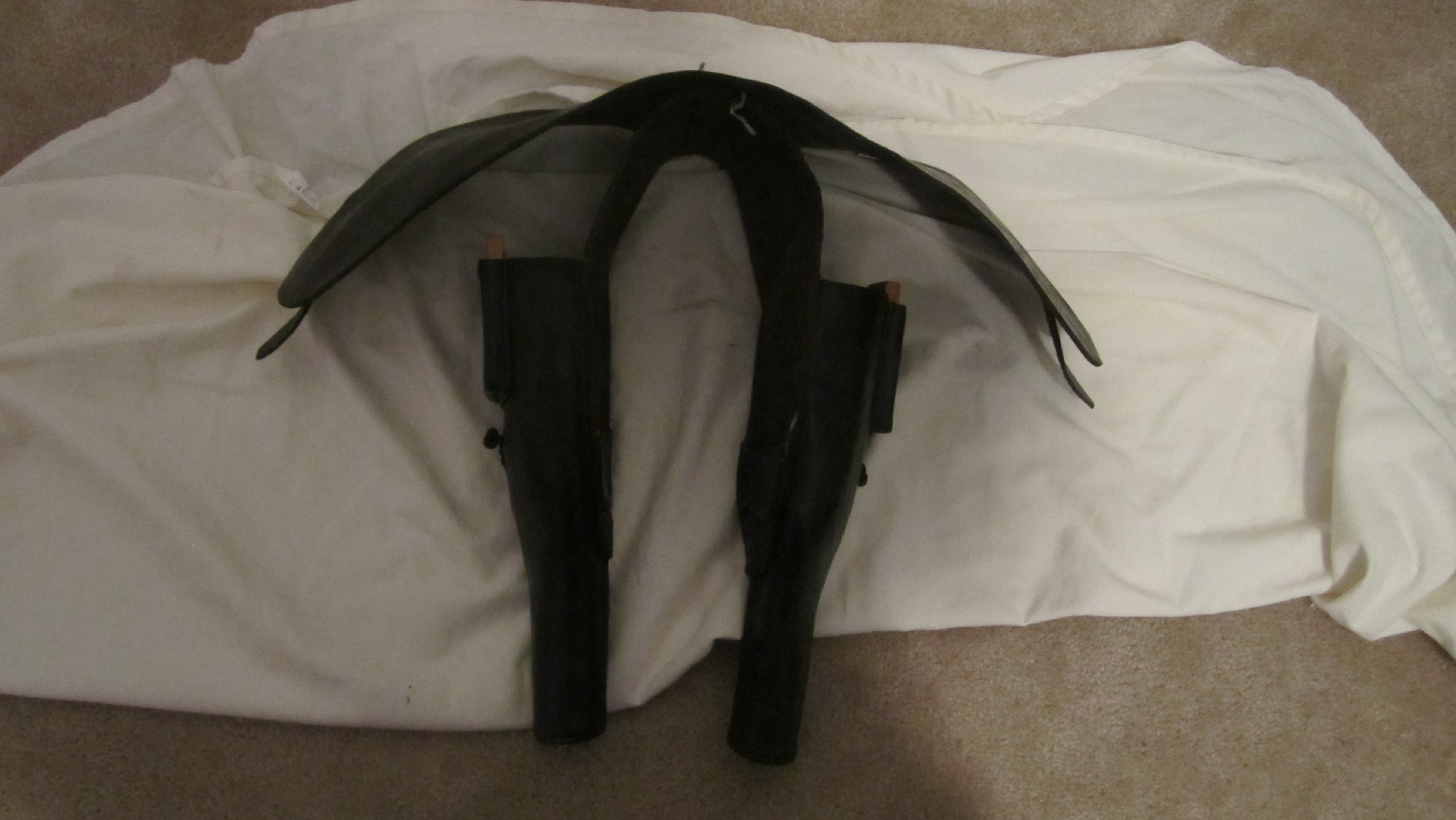

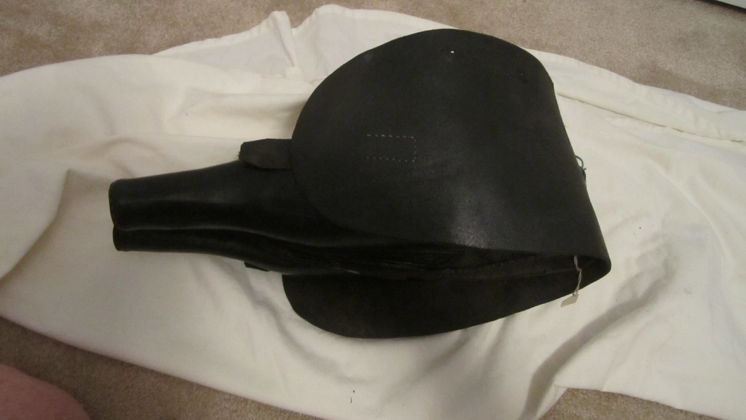

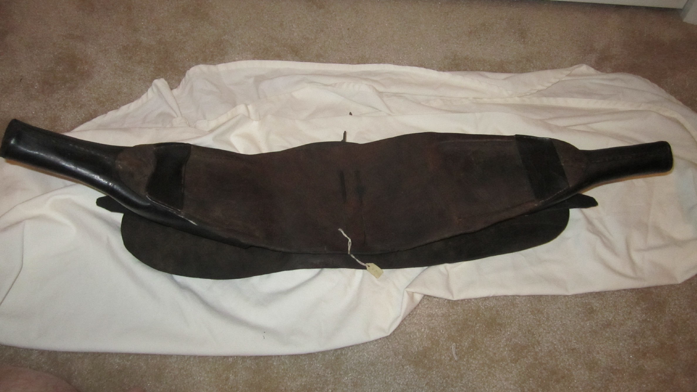

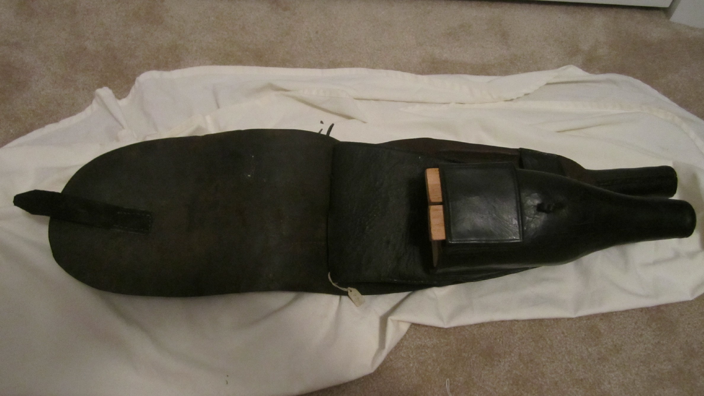

              I have these at my house right now....
              Thoughts?Click image for larger version

                Re: Pommel Holsters
                I don't see a hole in the center. How do they fit on the pommel?

                      Re: Pommel Holsters
                      From the wear marks they seems to slide under the front...I don't know much about these I admit, but they are for revolvers, as they do not have the single tubes for horse pistol cartidges, but rather for pistol packs...
                      They are in great shape, and interested in feed back.
