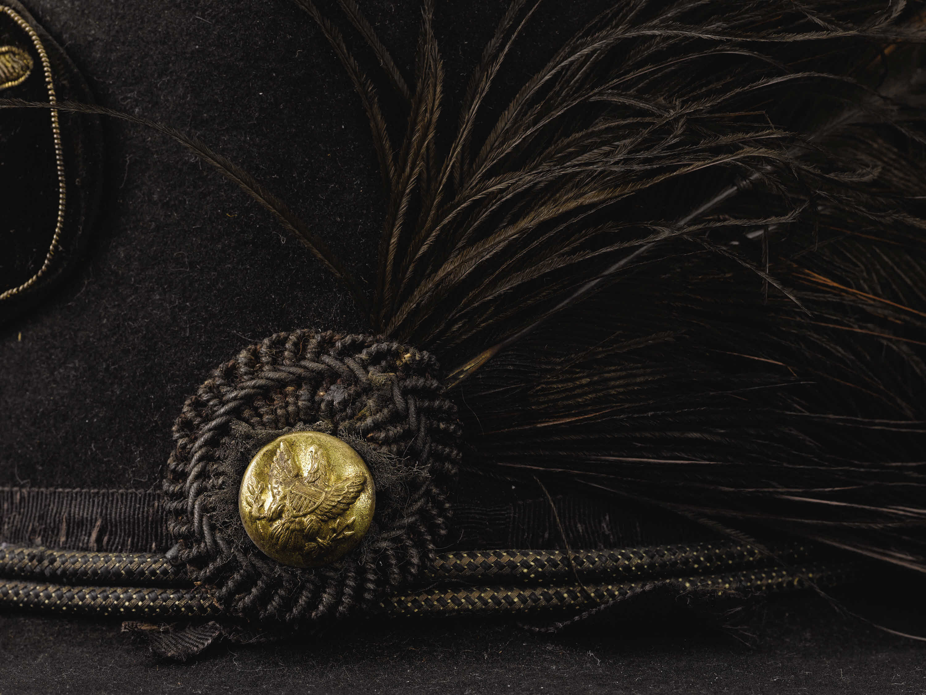

    Upon further research, I find that the plumes are sewn to a black cloth double ruffle cockade and attached to the hat cord by either a state or branch coat cuff button. I've not seen this done in reenacting but it sure beats tucking the plume(s) under the hat cord. Here's a good example of what I'm talking about: http://www1.westcoastcwc.com/images/...%20Hat%20B.jpg

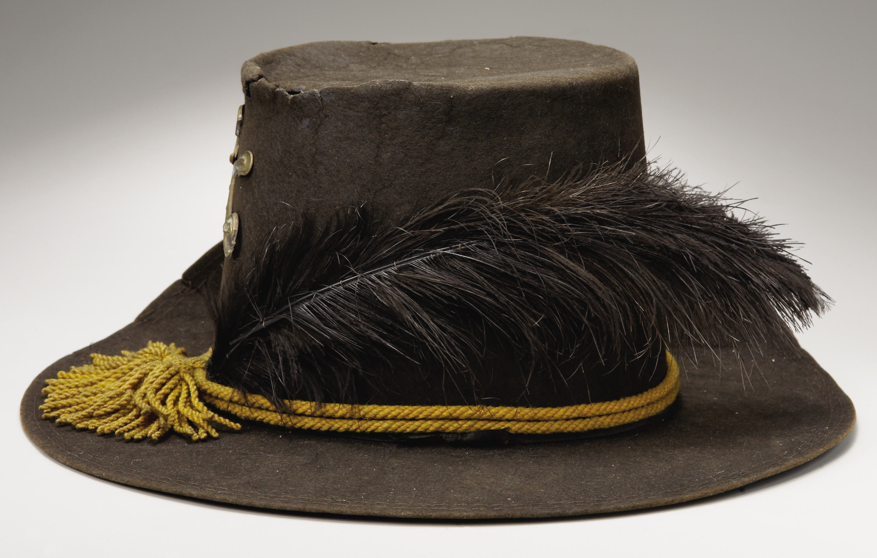

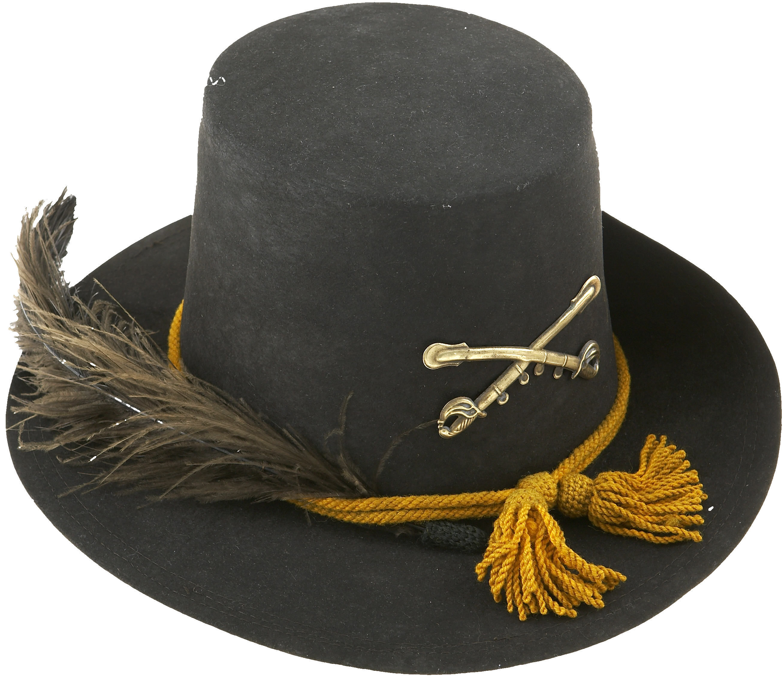

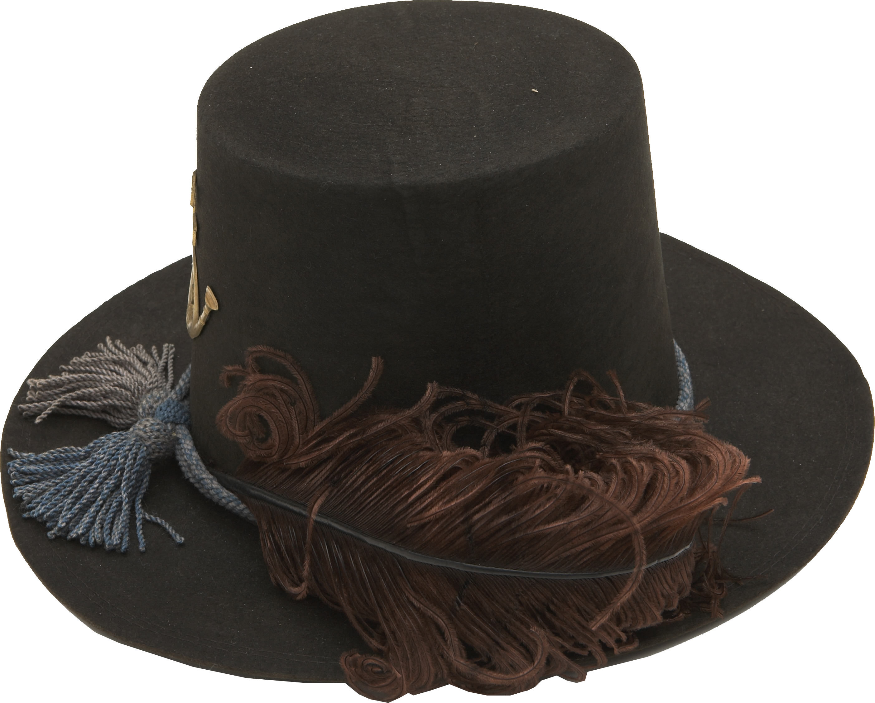

        Hi Gary,
        That is pretty cool for an officer's hat. Here are three examples of enlisted hats: the first cavalry hat shows some sort of woven tip at the base of the feathers; the infantry hat appears to be set in with MAYBE some sort of single stitch at the base (can't 100% tell); and the second cavalry hat has several staple-like attachments - also note there appear to be two smaller feathers put together to resemble one large plume. Photos are from www.ha.com

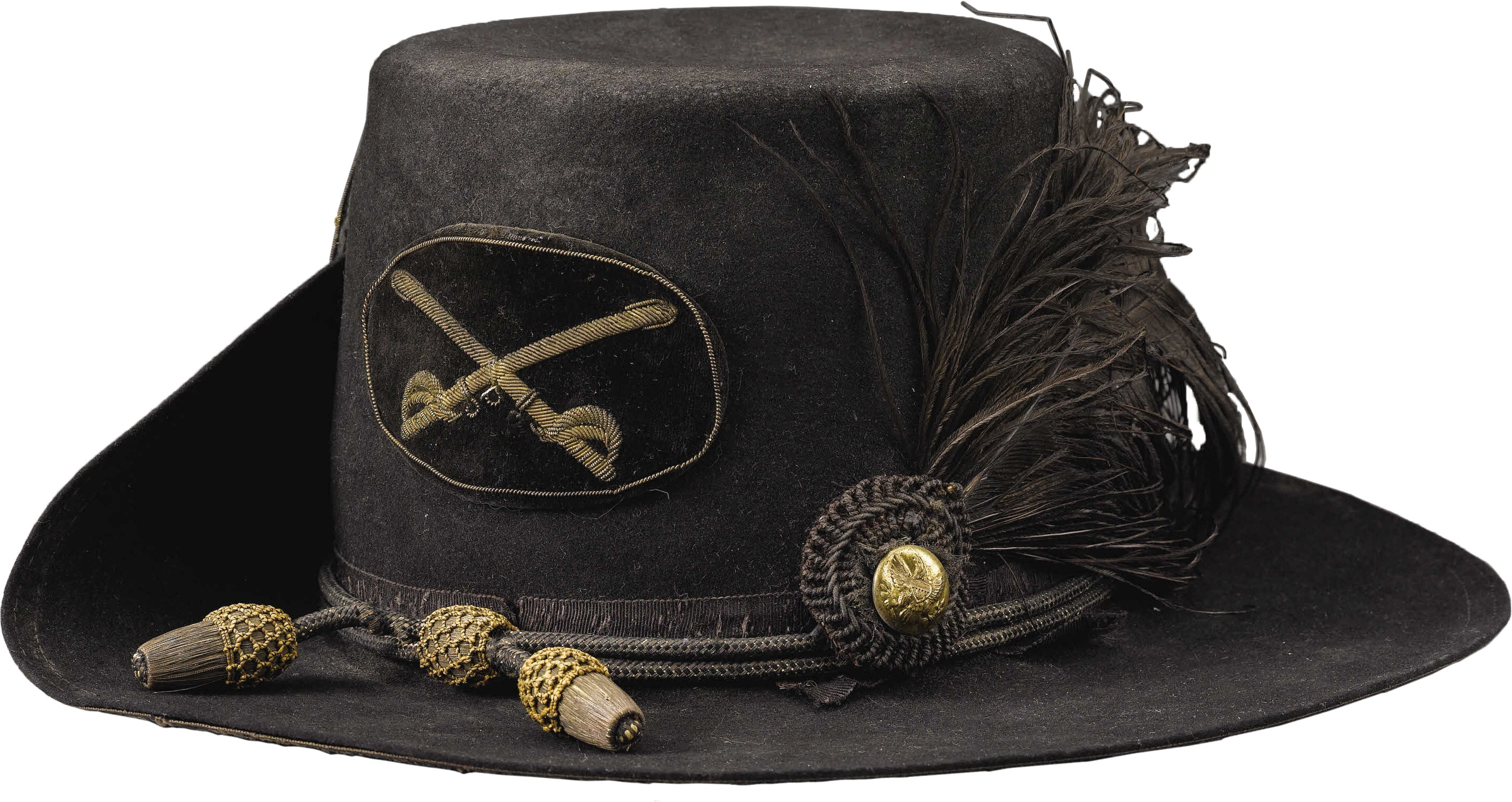

          Here's another cavalry officer's dress hat with a similar feature as the one linked above. Photos are from www.ha.com

            Re: Hardee plume attachment
            I have two very similar ones I picked up from a sutler friend. They were (I presume) antique officer plumes (not sure exactly how old). There were two sewn together and I separated them for both my and my son's dressed army hats. Of interest, there was a black wire in them that had a loop that attached to the brim of the hat to help hold it in place.
            The cockade attachments are very interesting, I wonder how common they were.
