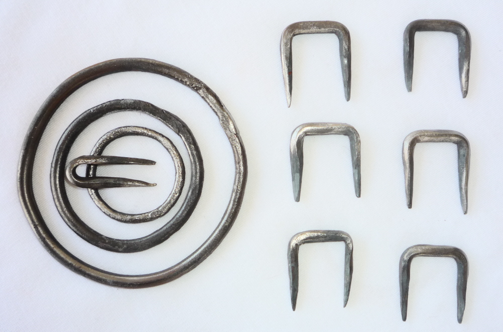

    Paul Muller tells me he is offering to make handforged CS hardware "kits" for those that want to upgrade their saddles or,....for those that are building a Confederate saddle, etc.
    Occasionally, I get inquiries from folks wanting large (3 or 4 inch interior) iron rings for Texas saddles. Others are re-rigging an old (perhaps civilian) saddle. Some folks may have the wrong hardware and just want to improve their saddle. Well, here is a chance to get some.
    The kit includes your choices of rings (choice of size include those for equipment, D-ring, girths, etc.) and the staples. Also hand forged "driven" footstands. All handforged iron.
    Fellas, GREAT opportunity to improve your saddle kit!
    Not sure what he charges so inquire with him

    I have used the footman loops of Paul's. Fantastic quality! Will definately continue business with him!

      What's the finish on these and how is Paul doing it?
      Mike Ventura
      Shannon's Scouts
        Re: CS saddle hardware "kits"............
        No finish other than wire brushing after they are made. I would japan them if asked to. plm

            Paul --
            Pardon my ignorance, but what keeps them from rusting in this condition? Can you give me some period examples of them finished this way?
            Mike Ventura
            Shannon's Scouts
              Nothing keeps them from rusting, I am just offering the hardware and the custumer can paint ,oil treat,japan,blue ,..what ever he wants. I however may have a japaning process I may try, but have not gotten that far. plm

                  Just a note to those interested....
                  IMHO, japanning was done by the CS authorities on a VERY limited basis and ONLY in the early war. I have seen but scant mention of it and then only on buckles and rings. I would doubt, though I do not know for sure that they would spend much effort on treating other saddle hardware. From my observation, they did not have the resources nor the desire to waste those precious resources (primarily chemicals and labor) on japanning. Same perhaps more so with painting.
                  However, blueing and oiling (with linseed oil) often cut with fish oil was a common practice with Confederate iron (bits, buckles and rings I have seen slight mention but, never any mention of foot stands) as was doing nothing at all....raw iron...which is likely what they most often did in this circumstance.
                    The formula I use on all my hardware is an old one passed down by smiths and works pretty well. Combine linseed oil, turpentine, and beeswax in thirds by weight. A double boiler works well for this. Be careful, this is flamable. The mixture will set up as a thick wax when cool. Bring the piece to be coated up to a dull red or black heat and toss it into the mixture. If it flames up, put the lid on the pot. DO YOU BEST NOT TO BREATHE THIS STUFF!!! Retrieve the piece from the mix while still warm and wipe it down with a cloth. The piece is good for a while. When it needs recoating, you can melt some and put it on a rag and wipe them down again, or remove them entirely though I never do this on mine. Though not authentic, you can bring the iron up to a dark heat and wipe it down with a wax ring from a toilet seal. I don't know what all is in there, but a lot of smiths do this today and it works remarkably well.
                      Thanks Greg, I think I will try the toilet wax thing. plm
                        Paul, I forgot to mention that these treatments give the iron a nice black finish. Best of luck.
