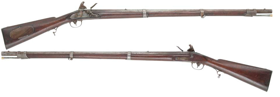

Likely a Henry Deringer M1817 Contract Rifle, a contract variation of the U.S. Flintlock Rifle Model 1817 aka M1817 Common Rifle. Possibly, I suspect, converted to percussion.
While most famous for his "derringers," Deringer made more than just derringers. Based on his work on M1814 Riles (aka M1803 Type II) Deringer received a contract for the M1817 Rifle in July of 1819 for a puny order of 1,800 t the rate of 100 a month until filled. That was followed b a second contract in April 1821 for 2,000 stands, and a third in August of 1823 for 3,000 to be completed over five years.
Perhaps oddly enough, Deringer was called upon to make then again in March of 1840 for 6,000 at the rate of 1200 a year for five years. For this batch, Deringer was allowed to get away with some shenanigans such as using other than M1817 parts or outside sources for parts. Plus mixing parts such as M1814 and M1817 Common Rifle parts in the mix on 4th contract pieces. But all in all, he did deliver all 12,800 called for in the four contracts,
IIRC, there are no references to a percussion version, BUT it would appear Deringer had tried to get additional contracts but failed. A number of percussion alterations are known, but not their sources. Some believe that they are random pieces, others believe possibly the result of a small unknown state contract somewhere sometime.
Numbers of M1817 Rifles went to states, including southern states under the 1808 Militia Act. And a small number later turn up locally altered to percussion for the Confederacy.
Some were still on hand at Federal arsenals, such as the 5,000 at Benecia Arsenal in San Francisco in July of 1861.

Here is a great example from the fine establishment "College Hill Arsenal" by Mess'r Tim Prince:
