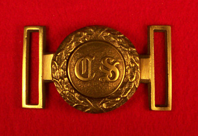

At this point I am leaning towards a "spoon and wreath" or possibly an English import belt. I geuss this means I would might actually have to carry a saber :sarcasticRobert Johnson
Re: CS Saber Belt Question
You can't go wrong with a simply spoon & wreath set-up. John Stillwagon, with permission, had photographed an "expediency" piece that was in the collection of Don Troiani. It was a simple folded cloth belt with iron hardward (the oval kind vs. brass "D" rings on U.S. belts) with sewn leather hangers. It also exhibited a two-piece buckle with no method of adjustment. The belt was unpainted...very cool!Originally posted by hireddutchcutthroatAt this point I am leaning towards a "spoon and wreath" or possibly an English import belt. I geuss this means I would might actually have to carry a saber :sarcastic

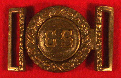

That being said, I'd recommend Hanover Brass for any of the various two-pieces in red brass. A Leech & Rigdon two piece may be a good choice also especially with its heavy use in the West. Gary's McElroy frame buckles also do very well on sword belts. I made several frame sword belts for S&S about a year ago so maybe give them a call and see if any are still available. Best wishes on the hunt.

I also concur with Hanover Brass as they have some teriffic buckles! They have a bunch which were repopped from Steve and Joyce Henry's unbelievable VA buckle collection...amongst their other selections!!

I too love collector talk! Here's Jim's link and the belt can be found at the bottom of the page. Notice, too, the cloth keeper at the left of the top photo and pristine CS spoon & wreath buckle. Funny thing is, on a non-adjustable belt...what do you need a keeper for??? Hmmm...looks I guess. Just a neat piece of equipment.
